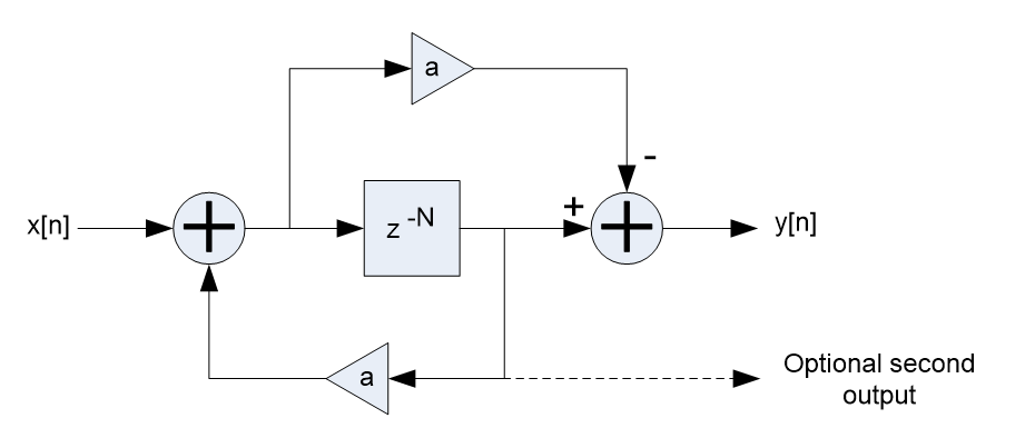

The allpass_delay_module.m and allpass_delay16_module.m implement the digital system shown below:

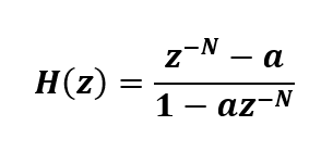

The overall transfer response is an allpass filter:
The filter has a constant magnitude response of 1.0 and a non-zero phase response. The filter has a DC gain of 1.0.
The arguments to the module instantiation function are:
M=allpass_delay_module(NAME, MAXDELAY, OUTPUTSTATE)
MAXDELAY specifies the size of the delay buffer.  At run-time, you can vary the delay in the range 0 to MAXDELAY as well as the coefficient
.  If the delay is equal to 0, then the algorithm processes the audio data as a bypass.  The third argument OUTPUTSTATE is a Boolean which specifies whether the module has an optional 2nd output pin.  The 2nd output pin gets the output of the delay buffer as shown above.
The module allpass_delay16_module.m has exactly the same functionality except that the data stored in the delay line is quantized to fract16 values in order to save memory.  The input data to the delay line must be in the range [-1 +1) or else it will be clipped.  The output data from the delay line is converted back to floating-point values for further processing.  The allpass_delay16_module.m takes roughly half the memory as compared with the allpass_delay_module.m though with a loss of precision.
