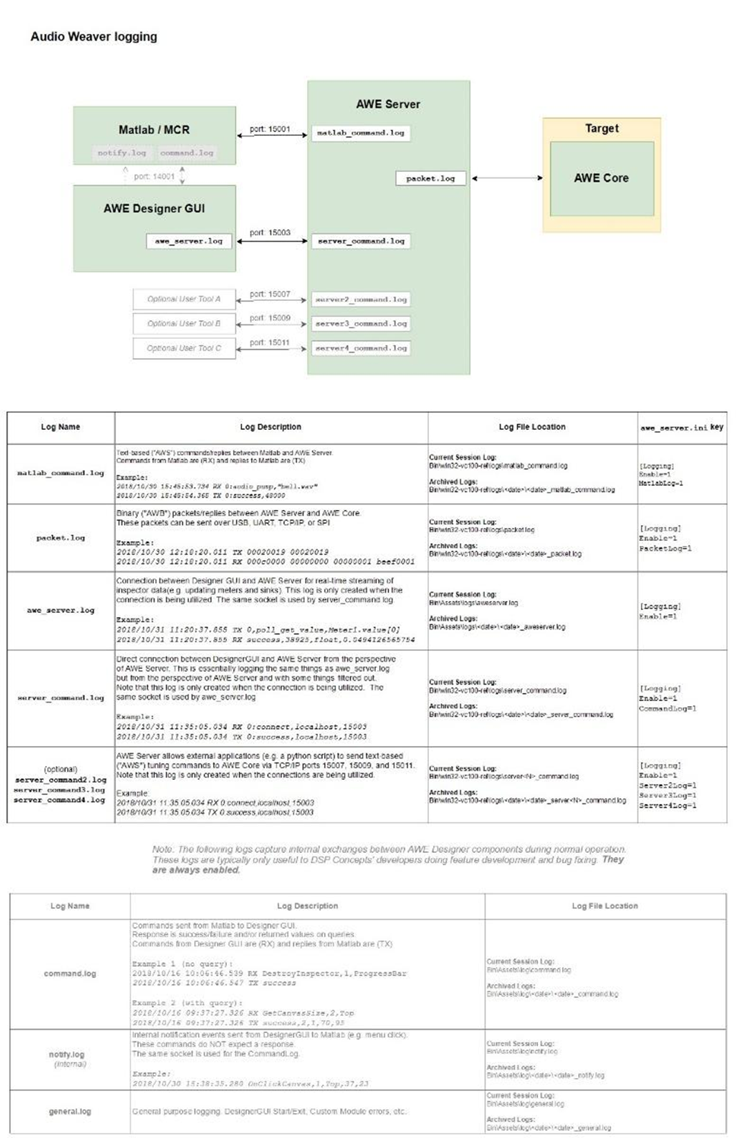

If you are having issues or trying to debug the tuning interface, turning on logging can be a big help. See the image below for information on our different logs and how to enable/disable them.
