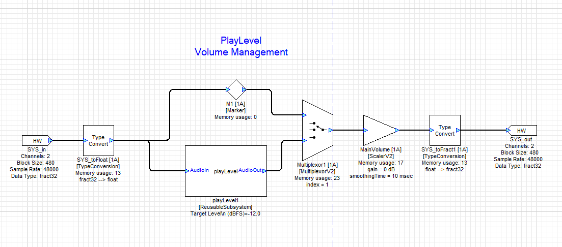

Figure 1 shows an example layout demonstrating the PlayLevel Reusable Subsystem. This example layout is designed to run in Native Mode with a file input; audio signals must be assigned to appropriate channels for running the layout on a target device.
Figure 1: Example layout demonstrating the PlayLevel Reusable Subsystem with a stereo input

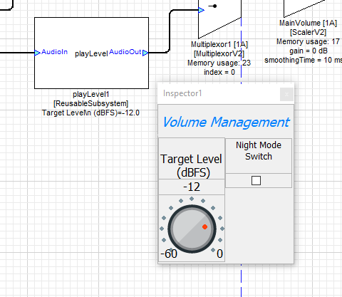

The PlayLevel Reusable Subsystem includes an inspector which allows users to adjust the output signal level and toggle Night Mode on and off. Figure 3 show the inspector panel of the PlayLevel Reusable Subsystem.
Figure 2: PlayLevel Reusable Subsystem inspector window
Target Level
The Target Level is the output digital signal level (0 dBFS is the full-scale signal level). After PlayLevel aligns the signal level of audio content with different volume levels, PlayLevel applies Automatic Gain Control to change the level-aligned signal to the Target Level.
Night Mode Switch
The Night Mode switch moderately attenuates low frequency content and makes the output sound slightly quieter.
