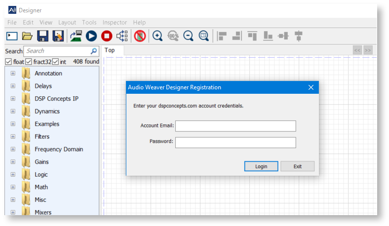

AWE Designer Licensing System
AWE Designer uses an online, account-based licensing system. This system gives developers the flexibility to use AWE Designer on multiple machines and allows features to be enabled over time.
To allow temporary offline-usage — in that hotel room, airplane, or remote site — Designer also has a built-in grace-period where it can operate for several days without an internet connection.
Finally, for those rare circumstances where an IT department cannot modify the firewall, node-locked offline-licenses are available to support fully offline access.

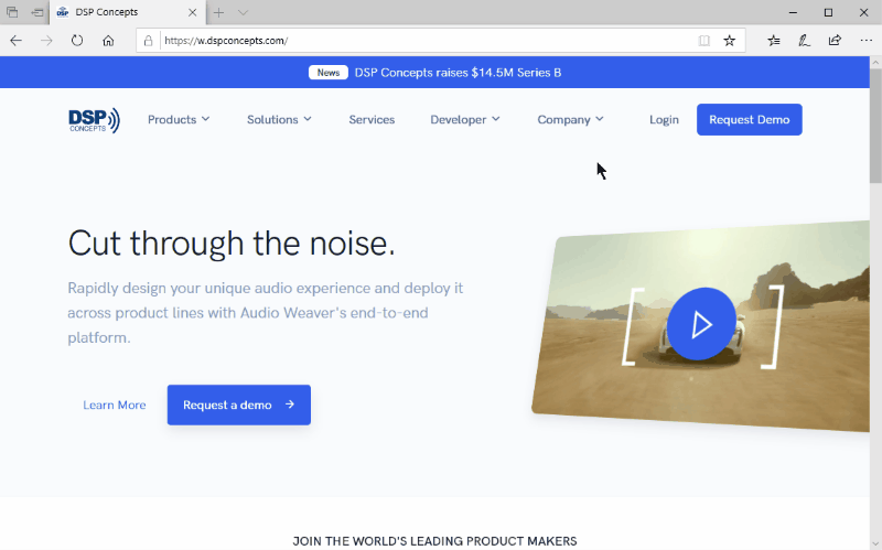

Licenses may be reassigned at any time. To assign a license, the License Administrator should do the following:
Login and go to their My Account page
Scroll down to the License Administration section
Add email address of the assignee's DSPConcepts.com account
Click the [ Update ] button at the bottom of the page.

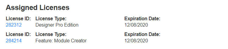

Assigned Licenses
Developers can see all licenses assigned to them in the "Assigned Licenses" section of the My Account page.

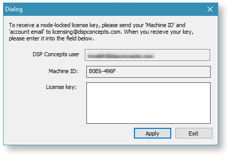

Offline Licensing
To support temporary offline use, there is a short grace-period where Designer can operate without contacting the licensing server.
For the rare exceptions when firewall settings cannot be changed, permanent offline access is available using a node-locked license.
