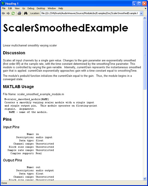

awe_help
For example, to see the generated help for the scaler smoothed module, type
awe_help scaler_smoothed_example_module
at the MATLAB command line. The documentation appears (shown in the figure below).
Automatically generated documentation for the scaler_smoothed_example_module.m.
Behind the scenes, MATLAB checks if documentation already exists for the module. Since the scaler_smoothed_example_module.m function exists in the directory
<Audio Weaver>\AWEmodules\Source\Examples
it checks if the file <Audio Weaver>\AWEModules\Source\Examples\Doc\ScalerSmoothedExample.html exists. The name "ScalerSmoothedExample.html" is based on the module's class name. If the file exists, it is opened and displayed in the MATLAB HTML browser. If it doesn't exist, then the documentation is generated on the fly using Microsoft Word and then saved in HTML format. The process of generating new documentation is quite involved and can take several seconds to complete.

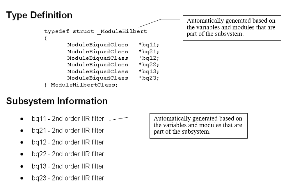

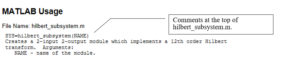

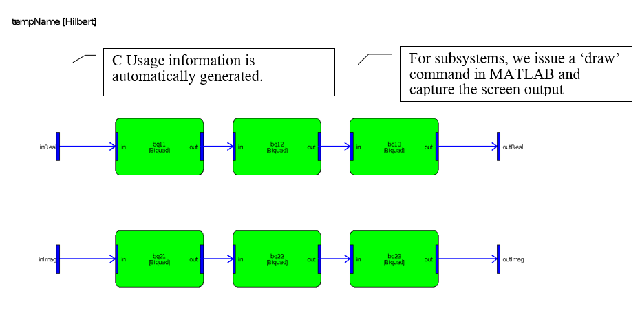

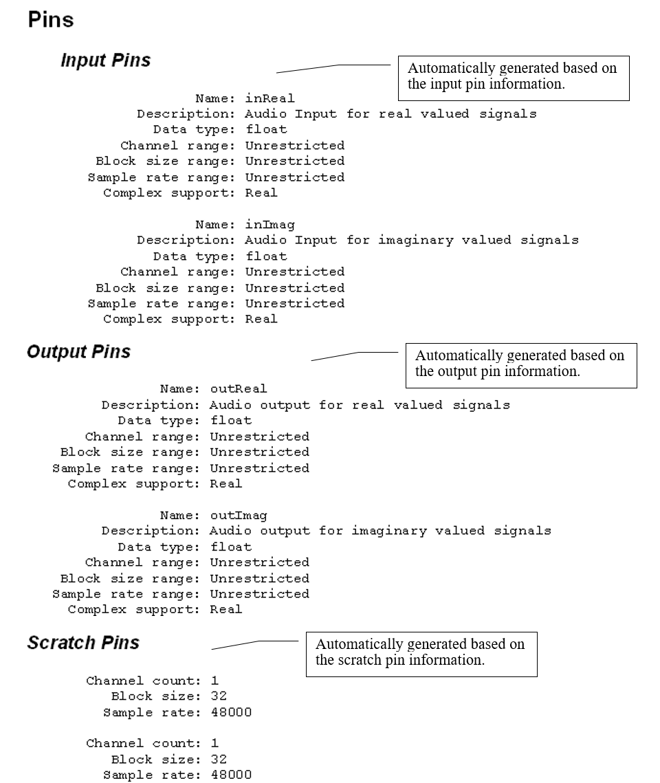

Hilbert Subsystem Example
We now walk through the automatically generated help for the hilbert_subsystem.m and describe where each of the items shown is taken from.

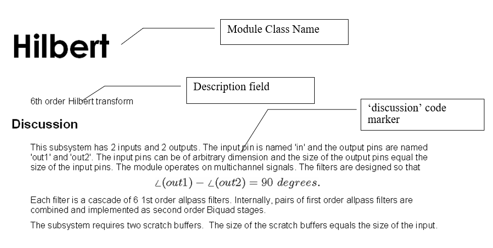

Adding Equations to Documentation
Audio Weaver supports adding equations to the discussion section of a module. Equations are entered as text commands within the 'discussion' portion in LaTeX format. Equations must be enclosed between dollar signs. For example, $\angle(out1)-\angle(out2) = 90~degrees.$ is expanded to ∠(out1) - ∠(out2) = 90 degees in the document. If you are new to LaTeX, there are many good references available online.
