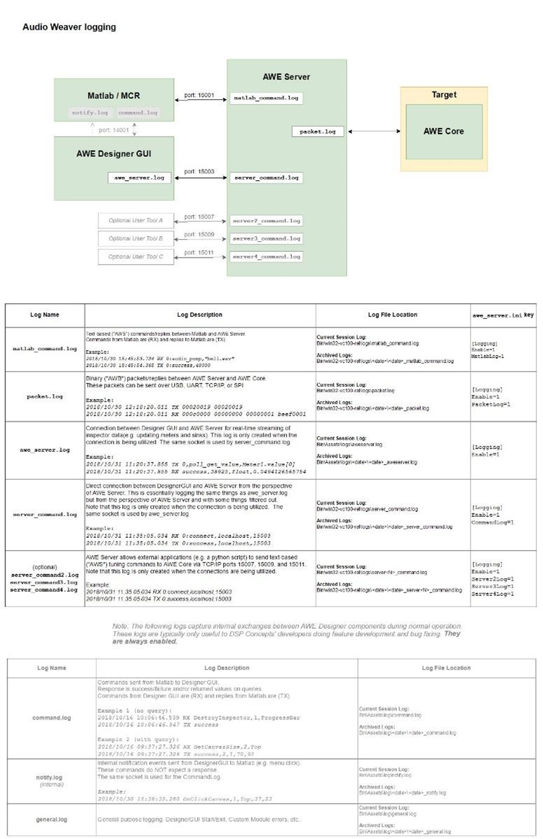

If you are having issues or trying to debug the tuning interface, turning on logging can be a big help. See the image below for information on our different logs and how to enable/disable them.
![](../../__attachments/2748811001/image-20221230-002942.png?inst-v=afeb83b1-861e-46b8-b4de-1c642321bb7f)
