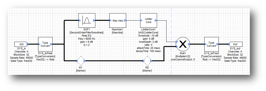

Broadband De-Essing
In the broadband approach the entire signal level is reduced when harsh high frequencies are detected. A standard AGCLimiterCore can be used with a sidechain EQ which accentuates the 8 kHz problem frequencies.
![](../../__attachments/2748821904/image-20221229-002012.png?inst-v=326272e9-cc04-48f3-a51a-5d633eb0a230)

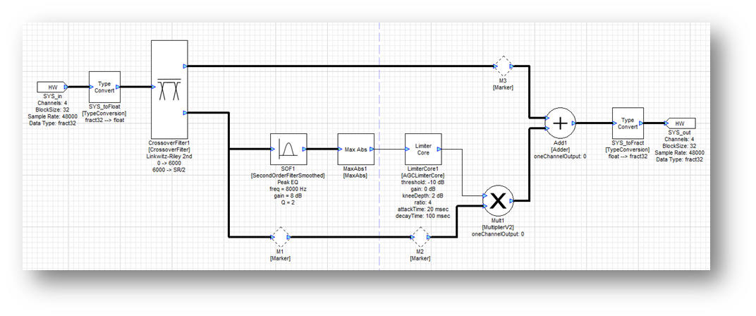

Split Band De-Essing
One improvement is to use a crossover and treat sibilant and non-sibilant frequencies separately. A 2-way crossover with a cutoff frequency of 6 kHz is used. A limiter then acts on the high frequency signals and reduces the gain, if necessary; the low frequencies are untouched.
![](../../__attachments/2748821904/image-20221229-002023.png?inst-v=326272e9-cc04-48f3-a51a-5d633eb0a230)

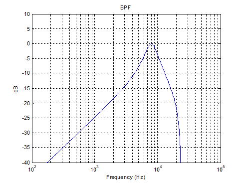

It is still possible to do better. In the Split Band De-essing all signals above 6 kHz are reduced in gain if sibilants are detecting. The design below is even more precise. A bandpass filter around 8 kHz detects sibilants.
![](../../__attachments/2748821904/image-20221229-002032.png?inst-v=326272e9-cc04-48f3-a51a-5d633eb0a230)
The output of the bandpass filter drives a limiter core and this in turn reduces the gain of a controllable second order peak filter. This limits the gain reduction to the range of frequencies from 6 to 10 kHz. The entire system is shown below:
