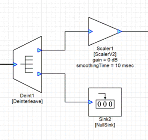

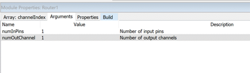

This is wasteful because it requires 3 modules to do what a single router module can do. Create a Router with 1 input pin and 1 output channel.
![](../../__attachments/2748818837/image-20230130-190718.png?inst-v=afeb83b1-861e-46b8-b4de-1c642321bb7f)
The desired left output channel is on pin 0 and channel 0 so set .channelIndex to 65536 * 0 + 0 = 0.

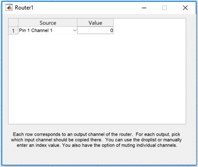

If instead you want to pass the right channel, set channelIndex to 65536*0 + 1 = 1. The string shown on the canvas will update showing you the specified channel ordering:
![](../../__attachments/2748818837/image-20230130-190813.png?inst-v=afeb83b1-861e-46b8-b4de-1c642321bb7f)
