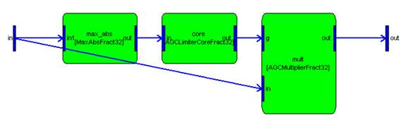

The agc_limiter_core_fract32_module computes a time varying gain which is used to restrict the peak value of a signal. The module is designed to take its input from the max_abs_fract32_module. The module computes a time varying gain on a sample-by-sample basis, and this gain is later applied by the agc_multiplier_fract32_module. The output gain signal is in 8.24 format. The agc_multiplier_fract32_module expects the gain to be in 1.31 format. Thus, the multiplier must be configured to shift by 7 bits. The combination of max_abs_fract32_module, agc_limiter_core_fract32_module, and agc_multiplier_fract32_module modules is referred to as a "limiter" and is contained in the script limiter_module.m.

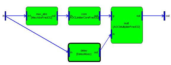

It is also possible to incorporate delay into the limiter effectively allowing it to "look ahead" and anticipate transients. See the limiter_module.m script for details.

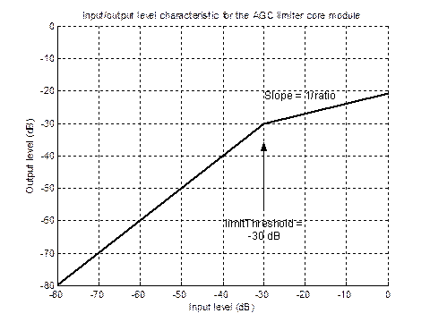

One way to understand the operation of the limiter is to consider the input / output curve shown in the figure below. The X-axis represents the level of the input signal, in dB. For simplicity, assume that the input signal is a sine wave. The Y-axis represents the level of the output sine wave. In the figure, the limitThreshold is set to -30 dB. Signals below limitThreshold are unaffected. Signals above limitThreshold are compressed by the parameter ratio. In the figure, ratio is set to 3 dB/dB, and thus the output signal gets 1 dB louder for every 3 dB increase in the input signal. In typical limiter applications, ratio is set to 100 preventing the signal from getting much louder than threshold.

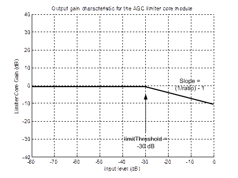

The AGCLimiterCoreFract32 module computes the gain needed to realize the input / output curve shown above. The gain curve is shown below. Below limitThreshold, the gain equals 0 dB and thus the level of the signal is unaffected. After limitThreshold, attenuation is applied.

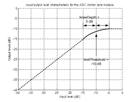

The limiter includes a soft knee which causes the attenuation to kick in gradually. The knee is a quadratic function extending from limitThreshold – kneeDepth to limitThreshold + kneeDepth. Due to manner in which the knee is implemented, kneeDepth must always be > 0. The figure below illustrates the input / output level characteristic with:
limitThreshold = -10
ratio = 100
kneeDepth = 10
![](../../__attachments/2807792449/image-20230127-021307.png?inst-v=afeb83b1-861e-46b8-b4de-1c642321bb7f)
