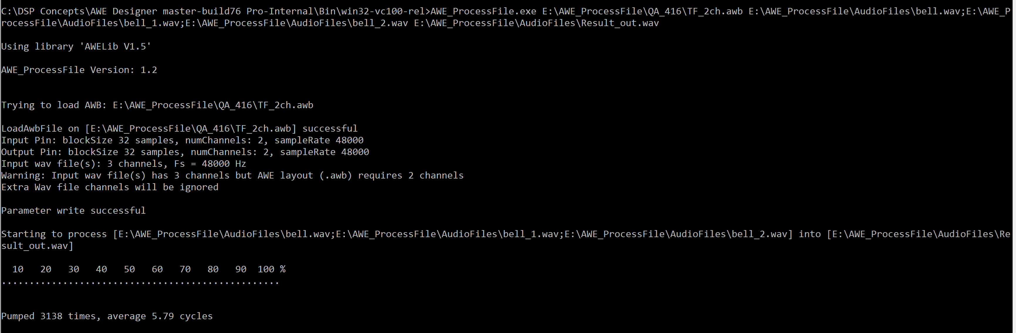

Multiple input files
It can be convenient to use multiple mono files, or generally just multiple files to get the input data you want into various channels. The syntax is to use a semicolon delimited list in place of a single file like this:
file1.wav;file2,wav;…;fileN.wav
The restrictions on files noted earlier applies – only 16 or 32 bit PCM, and the sample rate must match that of the AWB you are testing.
When multiple input files are used, the channels from each file are concatenated in the order the files appear to the AWB input channels. The length of the test will be that of the longest of these files. Any file which ends early will have its channels replaced by zeros. Each file may have any number of channels.
As with single files, absolute or relative paths are supported. The same file may appear more than once if you want to repeat its data. If any of these file names or paths contains a space, the entire argument must be double-quoted on the command line like this:
“file1.wav;file2,wav;…;fileN.wav”
Quotes must not be used in the configuration file even if one or more paths or names contain spaces.
