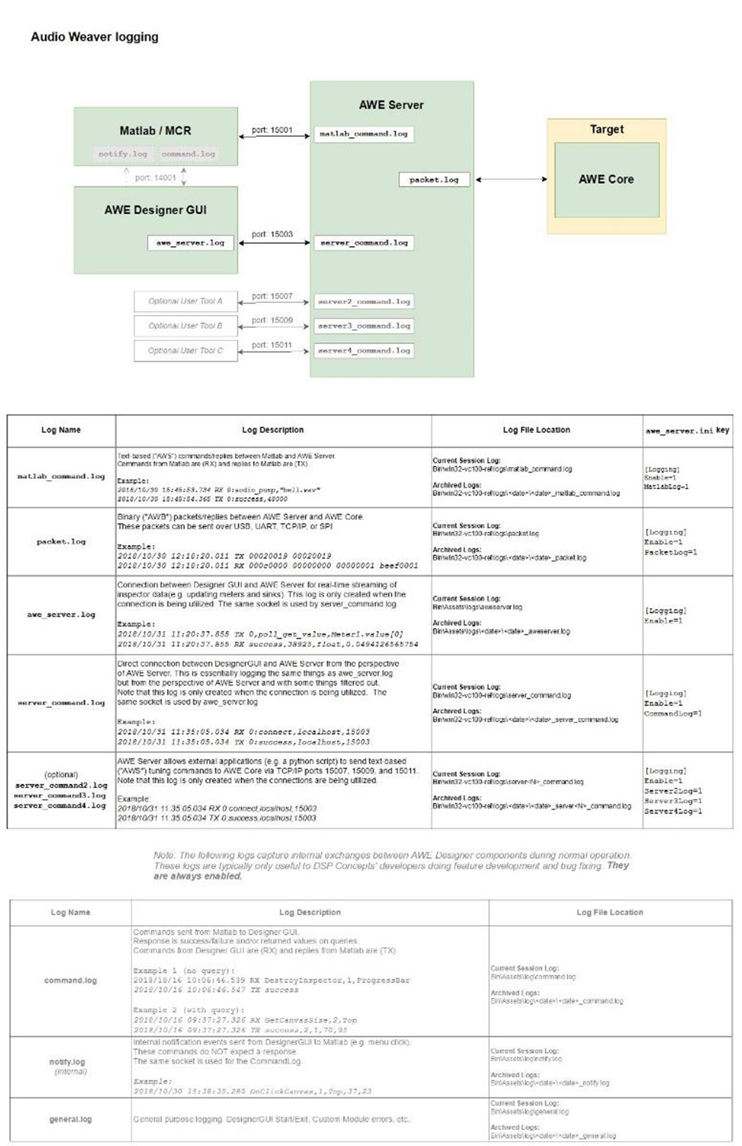

If you are having issues or trying to debug the tuning interface, turning on logging can be a big help. See the image below for information on our different logs and how to enable/disable them.
![](../../__attachments/2807727632/image-20221230-002942.png?inst-v=326272e9-cc04-48f3-a51a-5d633eb0a230)
