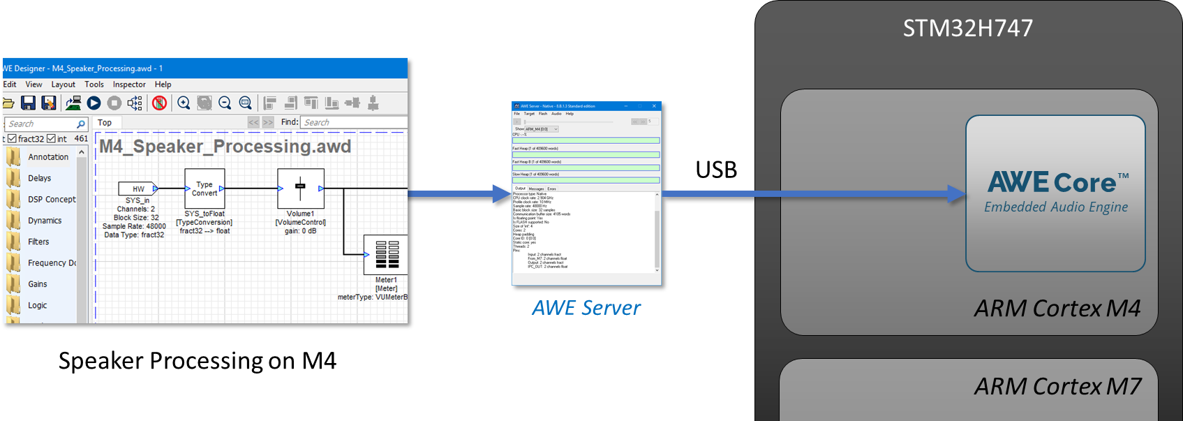

The AWE Core is a data-driven, cross-platform audio processing engine. It includes over 400 different audio building blocks that can be linked together at run-time to implement a unique audio processing pipeline. This audio processing pipeline (an Audio Weaver “layout”), including the sequence of modules and their parameters, is described by a block diagram in AWE Designer. Based on the block diagram, AWE Designer generates a set of configuration data (“tuning data”) the AWE Core uses to self-configure and implement the desired processing pipeline. During developmenttime, this data is sent in real-time via the AWE Server (and tuning interface, e.g. USB, UART, etc), which allows live modification of the Audio Layout, without needing to reflash or even reboot the board.
![](../../__attachments/2807203429/image-20221230-005016.png?inst-v=afeb83b1-861e-46b8-b4de-1c642321bb7f)
Example Single-Core System on an STM32H7 Processor

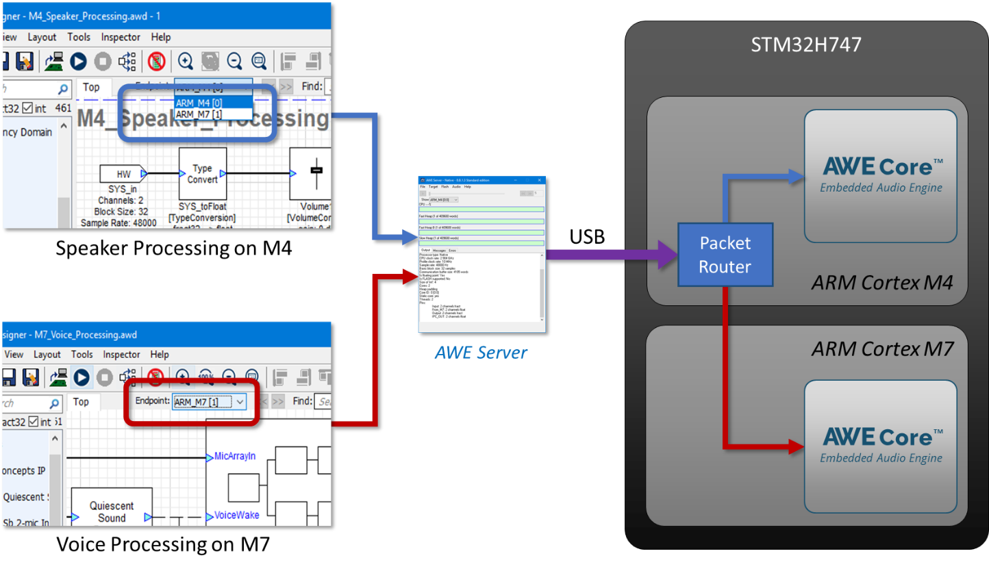

For Audio Weaver 8, the platform architecture was expanded to allow multiple AWE Designer windows to simultaneously connect to an embedded target through AWE Server, with each configuring a unique AWE Core instance.
To enable this, a drop-down menu was added to AWE Designer, allowing the user to select which endpoint (AWE Core instance) should run the given block-diagram. (Note: This dropdown is only visible when connected to a multi-instance target.)
Now, when one presses ‘Play’, the configuration data (that corresponds to the block-diagram) is sent to the target in a series of packets, each including an Instance ID
parameter – which the application can use to route the packet to the appropriate AWE Core instance.
![](../../__attachments/2807203429/image-20221230-005155.png?inst-v=afeb83b1-861e-46b8-b4de-1c642321bb7f)
Example Multi-Core System on an STM32H7 processor

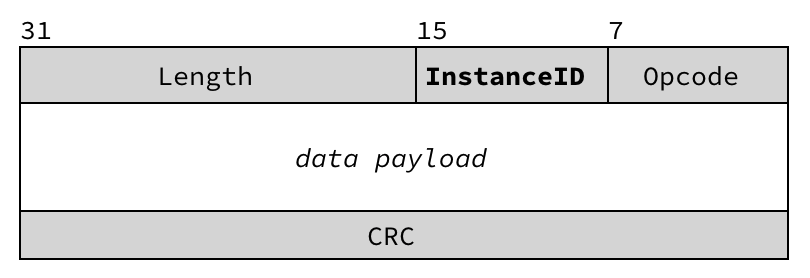

As shown in Audio Weaver Tuning Command Syntax, Audio Weaver packets include a 32-bit header word that includes the Packet Length (16-bits), InstanceID (8-bits), and Opcode (8-bits).
![](../../__attachments/2807203429/image-20221230-005316.png?inst-v=afeb83b1-861e-46b8-b4de-1c642321bb7f)
Audio Weaver Tuning Packet Format

The packet routing code should use the InstanceID parameter to determine where in the system to send the data. Note: The means of this data-transfer will be application specific, based on the unique system architecture of the product – some may use a shared memory buffer, while others might use transport like SPI to send the packet from one processor to another.
