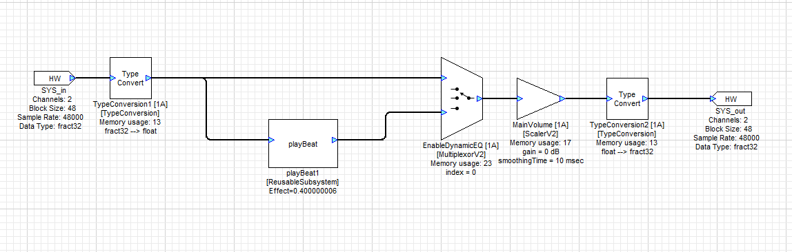

Figure 1 shows an example layout demonstrating the PlayBeat Reusable Subsystem. This example layout is designed to run in Native Mode with a file input; audio signals must be assigned to appropriate channels for running the layout on a target device. A module for gain control (the MainVolume ScalerV2 module in this example layout) should be located after the PlayBeat Reusable Subsystem.
![](../../__attachments/2807662704/att_3_for_2805367074.png?inst-v=afeb83b1-861e-46b8-b4de-1c642321bb7f)
Figure 1: Example layout demonstrating the PlayBeat Reusable Subsystem

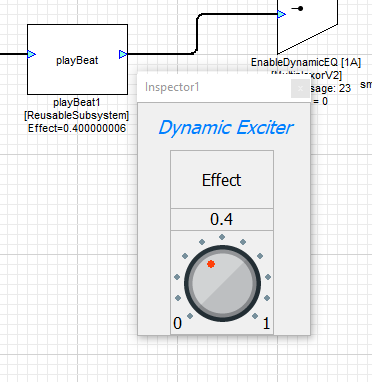

The PlayBeat Reusable Subsystem includes an inspector which allows users to tune the strength of dynamic excitation (the strength of low-frequency beat emphasis) using an Effect knob. The Effect knob ranges from 0 to 1, with 0 yielding no effect and 1 yielding the strongest effect. DSP Concepts recommends using 0.4 as a default. A stronger Effect setting may cause low-frequency clipping distortion.
![](../../__attachments/2807662704/att_2_for_2805367074.png?inst-v=afeb83b1-861e-46b8-b4de-1c642321bb7f)
Figure 2: PlayBeat Reusable Subsystem inspector window
