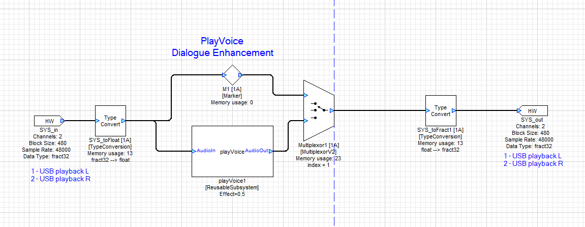

Figure 1 shows an example layout demonstrating the PlayVoice Reusable Subsystem. This example layout is designed to run in Native Mode with a file input; audio signals must be assigned to appropriate channels for running the layout on a target device.
![](../../__attachments/2807728299/att_3_for_2806415425.png?inst-v=afeb83b1-861e-46b8-b4de-1c642321bb7f)
Figure 1: Example layout demonstrating the PlayVoice Reusable Subsystem

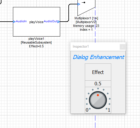

The PlayVoice Reusable Subsystem includes an inspector which allows users to tune the effectiveness of dialog enhancement using an Effect knob. The Effect knob ranges from 0 to 1, with 0 yielding no effect and 1 yielding the strongest effect. DSP Concepts recommends using an Effect level of 0.5 as a default.
![](../../__attachments/2807728299/att_2_for_2806415425.png?inst-v=afeb83b1-861e-46b8-b4de-1c642321bb7f)
Figure 2: PlayVoice Reusable Subsystem inspector window
