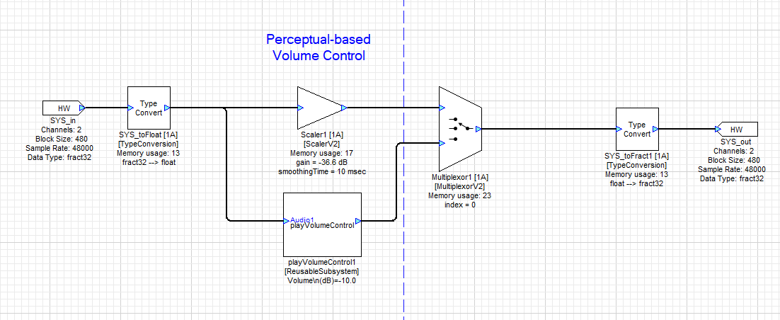

Figure 1 shows an example layout demonstrating the PlayVolumeControl Reusable Subsystem. This example layout is designed to run in Native Mode with a file input; audio signals must be assigned to appropriate channels for running the layout on a target device.
![](../../__attachments/2807563950/att_3_for_2805301543.png?inst-v=afeb83b1-861e-46b8-b4de-1c642321bb7f)
Figure 1: Example layout demonstrating the PlayVolumeControl Reusable Subsystem

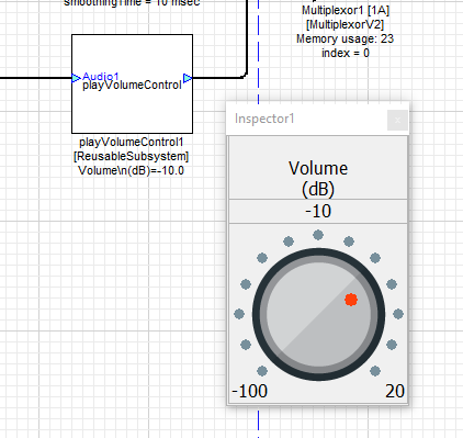

The PlayVoice Reusable Subsystem includes an inspector that allows users to change the volume gain.
![](../../__attachments/2807563950/att_2_for_2805301543.png?inst-v=afeb83b1-861e-46b8-b4de-1c642321bb7f)
Figure 2: PlayVolumeControl Reusable Subsystem inspector window
