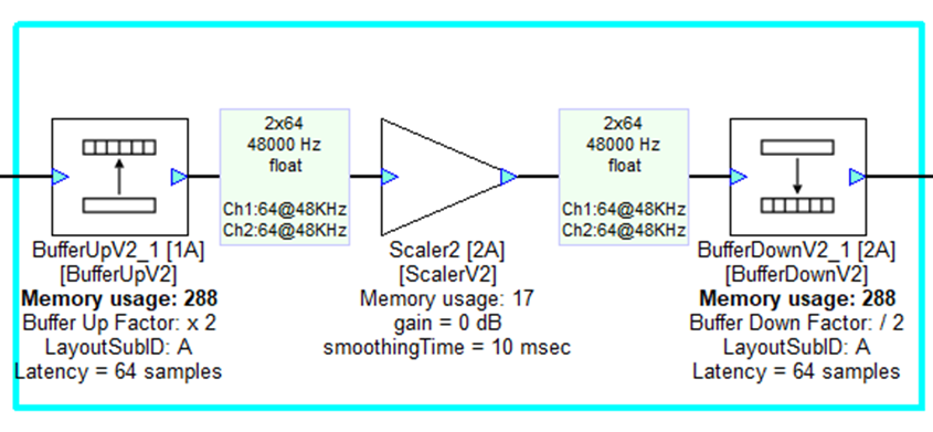

To change block sizes within a design, Buffer Up creates a new layout within Audio Weaver and is used in conjunction with Buffer Down. This layout will appear as a continuation of the signal flow in the same design file, however the portion of the system between Buffer Up and Buffer Down will operate at a different block size (whole number multiple of the input block size) and in a different layout, designated in the module’s properties tab.
The layoutSubID allows you to run multiple sets of modules at the same clockDivider in different layouts by setting the block size, and layoutSubID. For instance, the system input pin is always in layout 1A, and any layouts with the same clock divider could reside in 1B, 1C, alphabetically up to 1P. By changing to a higher block size, the user would be creating a second clock divider, where the user can add up to 16 layouts in this new block size (2A, 2B, 2C, etc.).
![](../../__attachments/2807727887/image-20221229-195659.png?inst-v=afeb83b1-861e-46b8-b4de-1c642321bb7f)

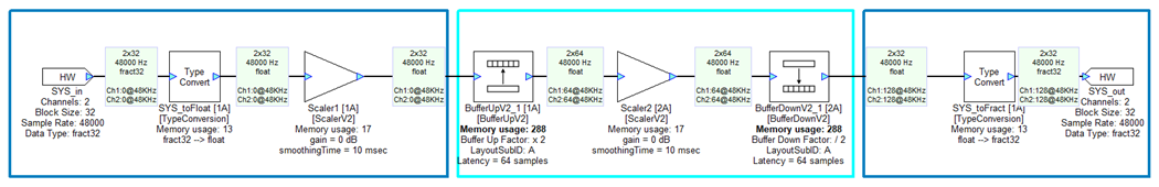

Multithreading Example:
For the middle part of this layout to run, the outer parts of the layout
need to run twice (two pumps of 32 samples = 64 block size)
When you build a layout like this, Audio weaver will split it into two layouts. The layouts are processed in separate threads because they have different block sizes. We support up to 16 threads (‘A’ through ‘P’)
The higher priority layout will execute the far left and right sections of the system
The lower priority layout will execute the middle section of the system
Buffer Up
Increases block size, creating a new layout with a designated layoutSubID
The Buffer Up module supports multiple input and output pins
The input wires must all be in the same clock divider
This module introduces a sample latency of buffUpFactor times the input pin’s block size
Large clock dividers go into lower priority layouts
User can designate layouts ‘A’ through ‘P’ (16 total)
Supports buffering up by whole-number multiples
Buffer Down
Ends a layout and returns to the original clock divider (higher priority, smaller block size)
Decreases input block size by whole-number multiple
Introduces a sample latency of the input pin’s block size

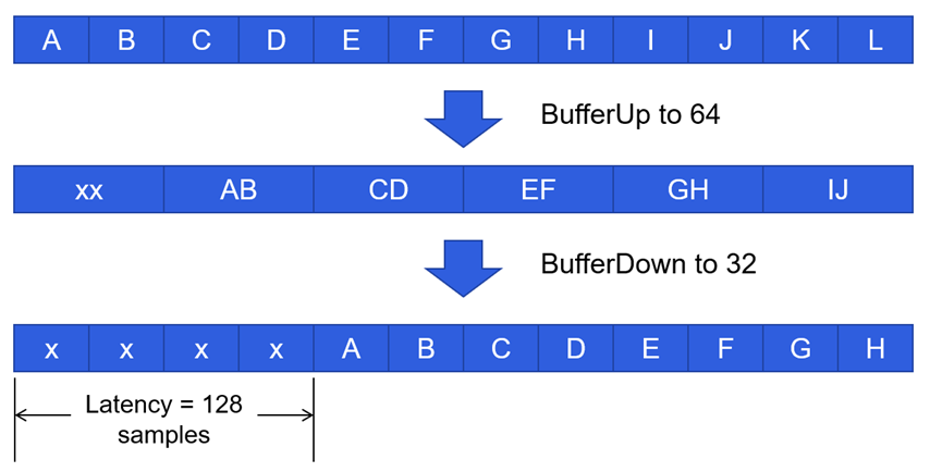

Latency effects of Multithreading
When a system’s block size is multiplied X times to buffer up, the smaller block size portion of the layout will need to run X number of times to fill the higher block size buffer. Additionally, when buffering down, the larger block size will pump smaller portions to the lower block size X number of times. Shown in Figure 2.0, buffering up incurs 64 samples of latency, then buffering down incurs another 64 samples, for a total of 128. At a sample rate of 48kHz, this would amount to 2.6ms of latency.

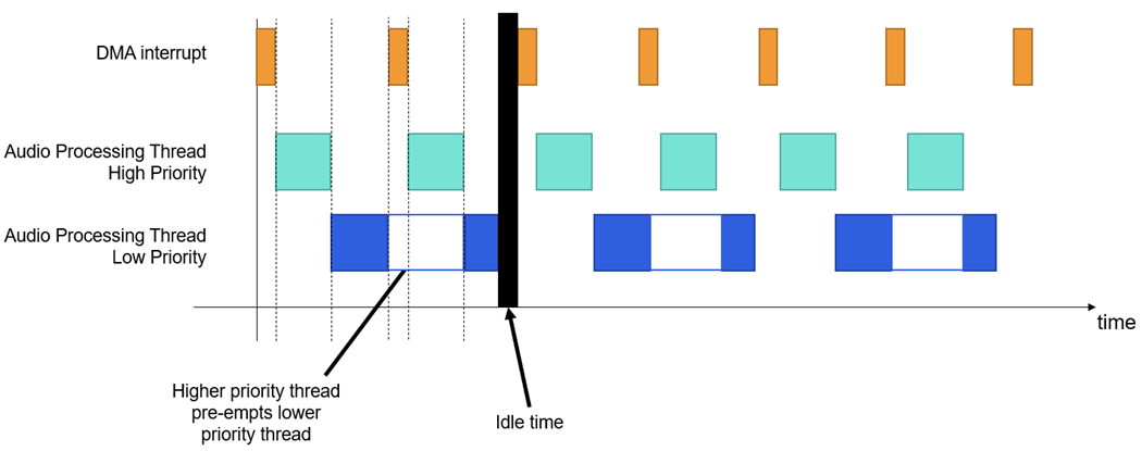

Processing Priority
The high priority thread will be given however many ticks are needed between DMA interrupts, before the lower priority thread is able to be processed. If the lower priority thread is not finished processing before the next DMA interrupt, processing will be paused until the next time the high priority thread is finished processing.

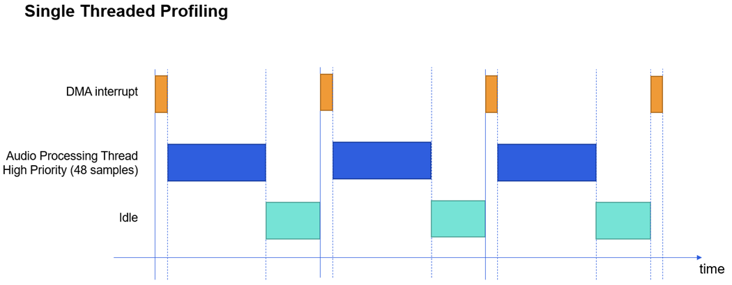

Single Thread Example

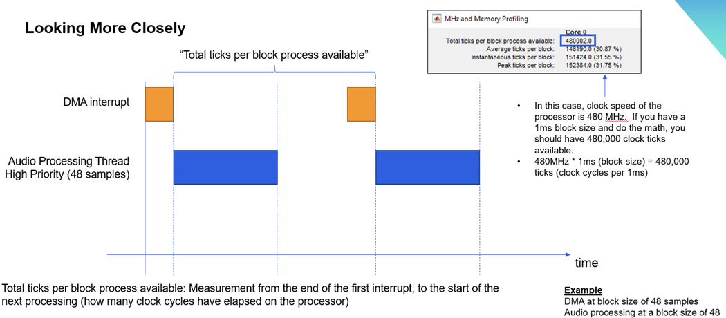

Profiling
In the example below, a system with a block size of 48 samples is run on a processor with a clock speed of 480 MHz.
With a sample rate of 48,000 Hz, each block will take 1 ms to process.480 MHz * 1 ms = 480,000 ticks per block process available.
