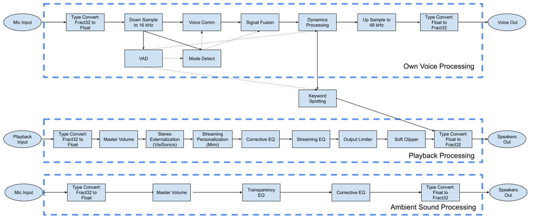

The TWS Reference Design Application Note describes the DSP Concepts True Wireless Stereo (TWS) reference design. The Audio Weaver Design, intended for use with DSP Concepts TWS RAPID Kit, features standard processing and signal flows seen in popular TWS commercial products. For an in-depth explanation of the RAPID TWS Kit and how to set up your kit, please refer to the RAPID TWS Kit Native Mode Setup and User Guide and the TWS_Audio-Weaver--RT685EVK-RevE-Board-Users-Guide.
Processing Overview
Audio in the design can be broken into three distinct, but related paths. One is the path of audio from the microphones to the connected device called the own voice processing path. The second is the path of audio from the device to the transducers in the earbuds called the playback processing path. The third is the path from the microphones to the transducers in the earbuds called the ambient sound processing path. The following diagram outlines the three paths.
The processing that composes these paths is described later in this guide.
![](../../__attachments/2807727930/image-20221229-200207.png?inst-v=afeb83b1-861e-46b8-b4de-1c642321bb7f)
TWS Reference Design High-Level Processing Diagram
Own Voice Processing Path
This section describes the major components of the own voice processing path.

Playback Processing Path
This section describes the major components of the playback processing path.
Playback Master Volume
The playback master volume is a playback volume control. The other gains are fixed and not to be changed.
Stereo Externalization (VisiSonics)
Stereo Externalization prevents in-head localization by making stereo streaming audio content sound like it originates from loudspeakers in front of the user. Users can adjust the reverberation level using three presets.
Streaming Personalization (Mimi)
Streaming Personalization amplifies and changes the frequency response of streaming audio signals to optimize audio playback based on a user’s hearing ability and preferences. Users can adjust the processing using four age-based presets.
Corrective EQ
A corrective EQ is applied to the playback processing path to flatten the frequency response of the earbud drivers’ output at the eardrum reference point.
Streaming EQ
A streaming EQ is applied to the playback processing path to allow users to tune the spectral quality of streaming audio content for an enhanced listening experience.
Output Limiter
The output limiter subsystem is a peak limiter used to keep the system from clipping.
Soft Clipper
The soft clipper protects the earbuds from potentially damaging peaks in the signal.

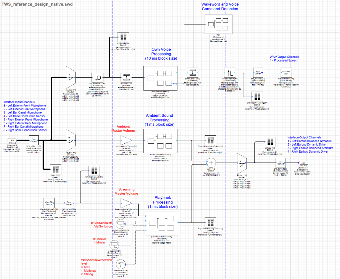

![](../../__attachments/2807727930/image-20230215-192056.png?inst-v=afeb83b1-861e-46b8-b4de-1c642321bb7f)
Native Mode TWS Reference Design

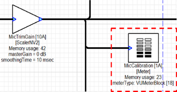

![](../../__attachments/2807727930/image-20230215-192324.png?inst-v=afeb83b1-861e-46b8-b4de-1c642321bb7f)
VU Meter
Exterior/Ear Canal Microphones
Play 1 kHz tone at 70 dBa at 1 foot from the transducer.
Adjust microphone gains via the ‘MicTrimGain’ ScalerNV2 module until they show -40 dBFS on the meter in Audio Weaver.
Bone Conduction Sensor
Wearing the earbuds, make an “E” sound at 70 dBc at 18 inches.

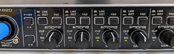

Microphone input
Microphone input analog gain knob shall be set to 12 o’clock direction.
![](../../__attachments/2807727930/image-20230215-192452.png?inst-v=afeb83b1-861e-46b8-b4de-1c642321bb7f)
UMC1820 Microphone Gain Levels

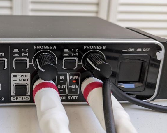

Speaker Output
Speaker output analog gain knob shall be set to 10 o’clock direction.

In the native design, the input and output pins of the system are used for sending and receiving audio from the earbuds. The following tables display the configuration of signals assumed by the design. For setup instructions, refer to DSP Concepts RAPID TWS Kit Setup and User Guide.
Input
Table: Native Mode TWS Reference Design Input Channels
Pin | Signal |
IN 1 | Left Exterior Microphone #1 |
IN 2 | Left Exterior Microphone #2 |
IN 3 | Left Ear Canal Microphone |
IN 4 | Left Bone Conduction Sensor |
IN 5 | Right Exterior Microphone #1 |
IN 6 | Right Exterior Microphone #2 |
IN 7 | Right Ear Canal Microphone |
IN 8 | Right Bone Conduction Sensor |
Output
Table: Native Mode TWS Reference Design Output Channels
Pin | Signal |
OUT 1 | Left Earbud Balanced Armature |
OUT 2 | Left Earbud Dynamic Driver |
OUT 3 | Right Earbud Balanced Armature |
OUT 4 | Right Earbud Dynamic Driver |

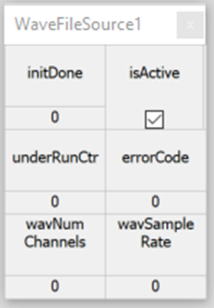

Audio Playback

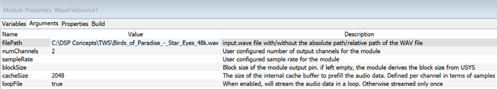

Playback of audio from a WAV file on disk is controlled by the Wave File Source module. Double left click the module to bring up an Inspector for the module. Playback can be stopped and started by clicking the isActive check box.
![](../../__attachments/2807727930/image-20230215-193035.png?inst-v=afeb83b1-861e-46b8-b4de-1c642321bb7f)
WaveFileSource Module Inspector
Control of the playback file path, number of channels, sample rate, block size, cache size, and looping can be accessed by completing the following steps:
Right click the WaveFileSource module.
Select View Properties.
Select the Arguments tab in the Property Sheet at the bottom of the Designer window.
![](../../__attachments/2807727930/image-20230215-193201.png?inst-v=afeb83b1-861e-46b8-b4de-1c642321bb7f)
WaveFileSource Module Arguments Tab

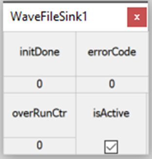

Audio Capture

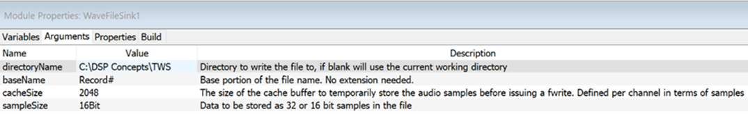

Recording of audio to a WAV file is controlled by the WaveFileSink module. Double left click the module to bring up a small Inspector control panel for the module. Recording can be stopped and started by toggling the isActive check box.
![](../../__attachments/2807727930/image-20230215-193220.png?inst-v=afeb83b1-861e-46b8-b4de-1c642321bb7f)
WaveFileSink Module Inspector
Control of the record file path, file base name, cache size, and bit depth can be accessed by completing the following steps:
Right click the WaveFileSink module.
![](../../__attachments/2807727930/image-20230215-193238.png?inst-v=afeb83b1-861e-46b8-b4de-1c642321bb7f)
WaveFileSink Module Arguments Tab

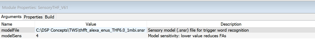

Keyword Detection Model
You can access control of the trigger word recognition model file by completing the following steps:
Right click the SensoryTHF_V6 module in the VUI subsystem.
Specify the file path of the desired Sensory model
![](../../__attachments/2807727930/image-20230215-193417.png?inst-v=afeb83b1-861e-46b8-b4de-1c642321bb7f)
SensoryTHF_)V6 Module Arguments Tab

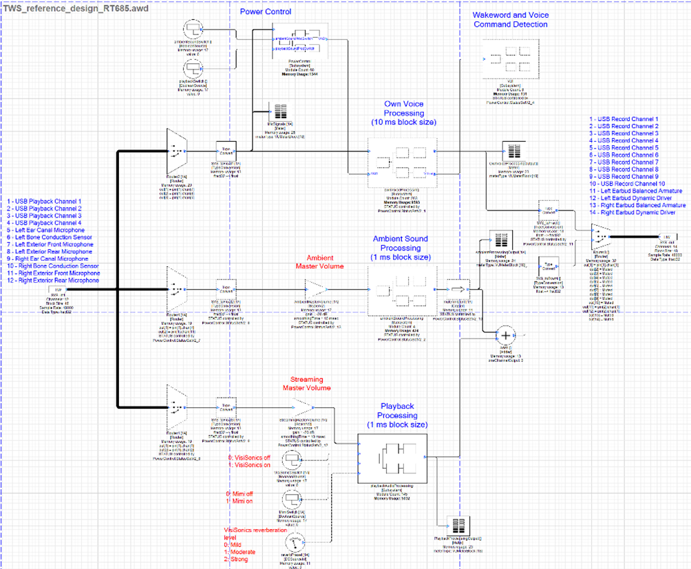

![](../../__attachments/2807727930/image-20230215-193440.png?inst-v=afeb83b1-861e-46b8-b4de-1c642321bb7f)
RT685 TWS Reference Design

In the RT685 design, the input and output pins of the system are used for all signals routed in and out of the design. The following tables display the configuration of signals used by the design. For setup instructions, including how to configure your Digital Audio Workstation (DAW), refer to the TWS_Audio-Weaver--RT685EVK-RevE-Board-Users-Guide.
Input
Table: RT685 TWS Reference Design Input Channels
Pin | Signal |
IN 1 | USB Playback Channel #1 |
IN 2 | USB Playback Channel #2 |
IN 3 | USB Playback Channel #3 |
IN 4 | USB Playback Channel #4 |
IN 5 | Left Ear Canal Microphone |
IN 6 | Left Bone Conduction Sensor |
IN 7 | Left Exterior Microphone #1 |
IN 8 | Left Exterior Microphone #2 |
IN 9 | Right Ear Canal Microphone |
IN 10 | Right Bone Conduction Sensor |
IN 11 | Right Exterior Microphone #1 |
IN 12 | Right Exterior Microphone #2 |
Output
Table: RT685 TWS Reference Design Output Channels
Pin | Signal |
OUT 1 | USB Record Channel #1 |
OUT 2 | USB Record Channel #2 |
OUT 3 | USB Record Channel #3 |
OUT 4 | USB Record Channel #4 |
OUT 5 | USB Record Channel #5 |
OUT 6 | USB Record Channel #6 |
OUT 7 | USB Record Channel #7 |
OUT 8 | USB Record Channel #8 |
OUT 9 | USB Record Channel #9 |
OUT 10 | USB Record Channel #10 |
OUT 11 | Left Earbud Balanced Armature |
OUT 12 | Left Earbud Dynamic Driver |
OUT 13 | Right Earbud Balanced Armature |
OUT 14 | Right Earbud Dynamic Driver |

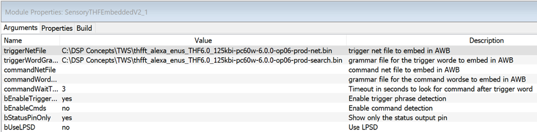

Right click the SensoryTHFEmbeddedV2 module in the VUI subsystem.
Specify the file path of the desired Sensory model.
![](../../__attachments/2807727930/image-20230215-193939.png?inst-v=afeb83b1-861e-46b8-b4de-1c642321bb7f)
SensoryTHF_V6 Module Arguments Tab
