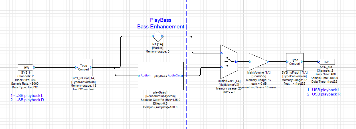

Figure 1 shows an example layout demonstrating the PlayBass Reusable Subsystem. This example layout is designed to run in Native Mode with a file input; audio signals must be assigned to appropriate channels for running the layout on a target device. A module for gain control (the MainVolume ScalerV2 module in this example) should be located after the PlayBass Reusable Subsystem for volume adjustment.
![](../../__attachments/2879261148/att_2_for_2806546493.png?inst-v=afeb83b1-861e-46b8-b4de-1c642321bb7f)
Figure 1: Example layout demonstrating the PlayBass Reusable Subsystem with a stereo input

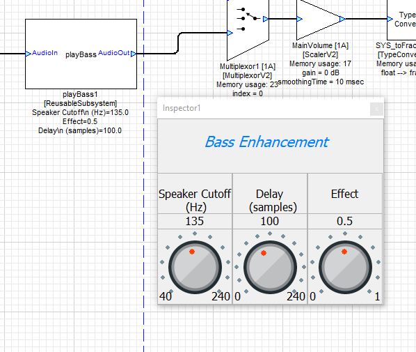

The PlayBass Reusable Subsystem includes an inspector which allows users to tune the speaker cutoff frequency, the delay, and the strength of pseudo-low-frequency content. Figure 3 show the inspector panel of the PlayBass Reusable Subsystem.
![](../../__attachments/2879261148/att_3_for_2806546493.png?inst-v=afeb83b1-861e-46b8-b4de-1c642321bb7f)
Figure 2: PlayBass Reusable Subsystem inspector window
Speaker Cutoff
The Speaker Cutoff frequency depends on the low-frequency performance of the speaker. PlayBass generates the pseudo-low-frequency content below the speaker cut-off frequency. Smaller drivers need a higher cut-off frequency. Table 1 is a guideline of the typical speaker cutoff frequency for various driver sizes. DSP Concepts suggest starting the tuning with those frequencies.
Driver diameter (mm) | Typical cutoff frequency (Hz) |
0.5 | 280 |
0.75 | 215 |
1.0 | 180 |
1.3 | 150 |
1.5 | 125 |
2 | 105 |
2.5 | 95 |
3 | 80 |
3.5 | 70 |
4 | 60 |
5 | 50 |
Table 1: Cutoff frequency guideline for various driver sizes
Delay
The Delay is a time lag applied before the pseudo-low-frequency content is added. The Delay range is between 0 and 200 milliseconds. DSP Concepts recommends using 100 milliseconds as a default. A longer delay may generate more bass enhancement effect, but it may also cause sonic artifacts.
Effect
The Effect knob allows users to control the amount of pseudo-low-frequency content. The range is between 0 and 1. 1 is the strongest effect, and 0 is no effect. DSP Concepts recommends using 0.5 as a default. A stronger setting such as 1.0 may cause clipping distortion.
