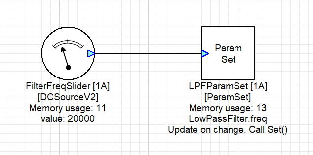

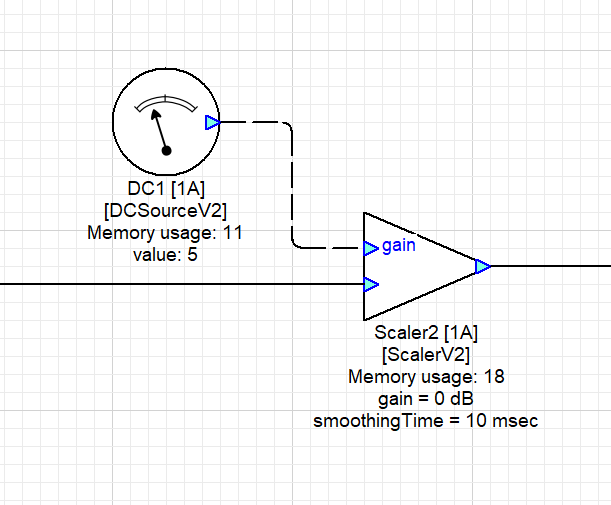

Wired control signals (Figure 1) such as the DC Source module, can be used to adjust parameters of modules, but this can also be accomplished with the ParamGet and ParamSet modules.
![](../../__attachments/2907212021/att_17_for_2807103505.png?inst-v=afeb83b1-861e-46b8-b4de-1c642321bb7f)
Figure 1: Wired Control Signal

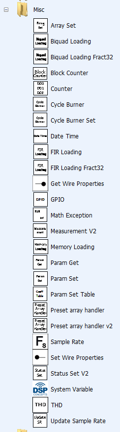

The ParamGet and ParamSet modules read and write parameters to and from existing modules in an Audio Weaver Designer layout, without the need of a wired connection.
These modules can be found in the ‘Misc’ module folder in Audio Weaver Designer’s module palette on the left-hand side of the Designer window:

Param Set Module
The ParamSet module takes a signal from an input wire and writes the incoming value to an instance variable in another module:
![](../../__attachments/2907212021/att_21_for_2807103505.png?inst-v=afeb83b1-861e-46b8-b4de-1c642321bb7f)
Figure 3: ParamSet Module
This module is useful for controlling the behavior of other modules in response to control signals or audio signals. This module can set parameters of any type of module, which eliminates the need to use and/or create controllable permutations of each module. The input wire can have any number of channels and any block size. The module only uses the first value in the wire and ignores all others. Internally the module uses two pointers. The first points to the base of the module being controlled. The second pointer points at the variable being written.

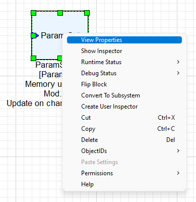

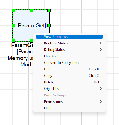

To set which module and variable the ParamSet module controls, right click on the ParamSet module while Audio Weaver is in Design Mode, and select ‘View Properties’ in the context menu:
![](../../__attachments/2907212021/att_19_for_2807103505.png?inst-v=afeb83b1-861e-46b8-b4de-1c642321bb7f)
Figure 4: ParamSet View Properties
The ParamSet module’s properties menu will appear at the bottom of the Audio Weaver Designer window. Navigate to the ‘Arguments’ tab to assign the desired module and variable you wish to control:

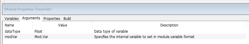

Pictured above in Figure 5, you can see two arguments for the ParamSet module:
dataType
modVar
The dataType argument specifies the input pin’s type of data (float, int, fract32).
The modVar argument specifies which module’s variable the ParamSet module will set. The following table describes valid modVar syntax:

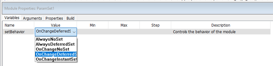

The behavior of how often the instance variable is updated and whether the module’s set function is called, can be set or changed in the ‘Variables’ tab of the ParamSet module via the setBehavior variable:
![](../../__attachments/2907212021/att_2_for_2807103505.png?inst-v=afeb83b1-861e-46b8-b4de-1c642321bb7f)
Figure 7: ParamSet setBehavior Properties
The setBehavior variable presents 5 behavioral options, but behind the scenes it is a bit field:
Bit 0 specifies whether the instance variable is always updated (=0) or only if the value on the input wire changes (=1)
Bit 1 specifies whether the set function of the module being control is called. (=0 do not call set. =1 call set function).
There are 5 possible bit combinations available:
setBehavior Value | Bit 0 | Bit 1 |
0: Always update. Do not call set function (useful) | 0 | 0 |
1: Always update. Call set function (not too useful) | 0 | 1 |
2: Update only when input value changes. Do not call set function (useful) | 1 | 0 |
3: Update only when input value changes. Call set function (Most useful) | 1 | 1 |
4: Update only when input value changes. Call set function immediately (not deferred) | 1 | 1 |
Table 2: setBehavior Value Definitions

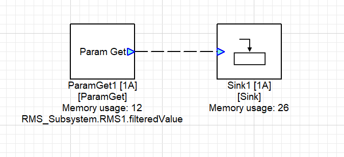

Param Get Module
Similar to the ParamSet module but opposite in functionality, the ParamGet module reads the value of a parameter from an existing module and outputs it on a wire for use elsewhere in the system.
![](../../__attachments/2907212021/att_3_for_2807103505.png?inst-v=afeb83b1-861e-46b8-b4de-1c642321bb7f)
Figure 9: ParamGet Module
Internally the module uses two pointers. The first points to the base of the module to get. The second pointer points at the variable to get within the module instance structure.

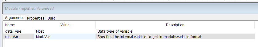

The parameter which the ParamGet module outputs is specified in the module properties. To set which module and variable the ParamGet module controls, right click on the ParamGet module while Audio Weaver is in Design Mode, and select ‘View Properties’ in the context menu:
![](../../__attachments/2907212021/att_20_for_2807103505.png?inst-v=afeb83b1-861e-46b8-b4de-1c642321bb7f)
Figure 10: ParamGet View Properties
The ParamGet module’s properties menu will appear at the bottom of the Audio Weaver Designer window. Navigate to the ‘Arguments’ tab to assign the desired module and variable you wish to control:
![](../../__attachments/2907212021/att_4_for_2807103505.png?inst-v=afeb83b1-861e-46b8-b4de-1c642321bb7f)
Figure 11: ParamGet Arguments Tab
Pictured above in Figure 11, you can see two arguments for the ParamGet module:
dataType
modVar
The functionality and syntax for each variable are identical to the ParamSet module, which are described in detail above.

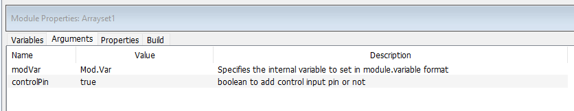

The ArraySet module reads the data coming in from the input wire and reaches into instance structure of the target module to copy the data to the target array. The input array size must be less than or equal to the size of the target variable array size, and the input array updates the target variable starting at the first array element. If the input pin array size is less than the target array size only the number of elements from the input array are changed in the target array.
The array data structure of the target module is pointed to by the argument modVar. The modVar value for the ArraySet module is accessed via the ‘Argument’ tab of the module’s property window, which can be accessed by right clicking on the module and selecting ‘View Properties’ in the context menu, like any Audio Weaver module.
The syntax for the ArraySet module’s modVar argument follows the ParamSet and ParamGet modVar syntax outlined above in Table 1.
![](../../__attachments/2907212021/att_6_for_2807103505.png?inst-v=afeb83b1-861e-46b8-b4de-1c642321bb7f)
Figure 13: ArraySet Module Properties

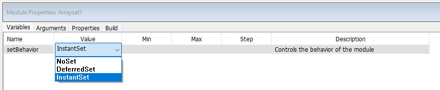

Unlike the ParamSet and ParamGet modules, the ArraySet module has an optional control pin that can be enabled or disabled in the ‘Arguments’ tab of the module’s properties. The control pin enables copying the input data to the modVar array when the first value of the control pin data !=0, acting as a type of trigger. If the control pin is not used, then the data is written to the target array on every execution.
Similar to the ParamSet and ParamGet modules, the ArraySet module’s ‘Variables’ tab in the Properties menu, contains an option to set the behavior of the module via the setBehavior variable:
![](../../__attachments/2907212021/att_7_for_2807103505.png?inst-v=afeb83b1-861e-46b8-b4de-1c642321bb7f)
Figure 14: ArraySet Variables Properties Tab
Below is a table describing each of the ArraySet module’s setBehavior values.
setBehavior Value | Description |
NoSet | Updates target module array, but never calls the target module's set function |
DeferredSet | Updates target module array, and uses a deferred call to the target module's set function so it executes after processing is complete |
InstantSet | Updates target module array, and immediately calls the target module's set function during the Array Set process |
Table 3: ArraySet setBehavior Values

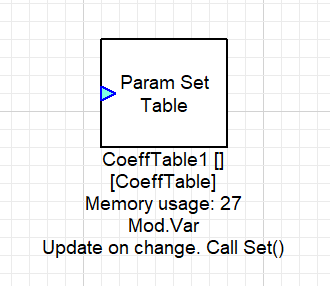

Param Set Table Module
The ParamSet Table module is similar to the ArraySet module but offers slightly different features for different use cases. The ParamSet Table module writes the values of one column of a statically defined table to an internal array of another module. A common use case is to update the coefficients of an FIR module based on changing conditions in the system.
![](../../__attachments/2907212021/att_8_for_2807103505.png?inst-v=afeb83b1-861e-46b8-b4de-1c642321bb7f)
Figure 16: ParamSet Table Module

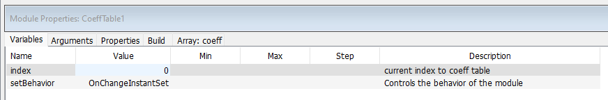

Let’s take a look at the ParamSet Table Module’s Properties. In the ‘Variables’ tab of the module’s Properties, we have two variables, index and setBehavior:
![](../../__attachments/2907212021/att_9_for_2807103505.png?inst-v=afeb83b1-861e-46b8-b4de-1c642321bb7f)
Figure 17: ParamSet Table Variables Properties
The setBehavior values and resultant behavior are identical to the ParamSet module’s, described above in Table 2.
The index variable specifies the current coeff column index of the coeff table defined in the ‘Array: coeff’ tab, to select which column to copy to the target module's array. This variable can be changed here in the ‘Variables’ tab of the module’s Properties and also by the integer value of the input pin.

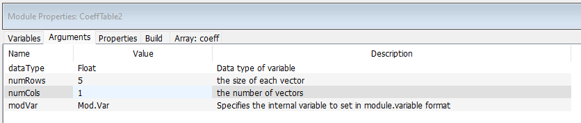

In the ‘Arguments’ tab, we can see the following fields:
dataType
numRows
numCols
modVar
![](../../__attachments/2907212021/att_10_for_2807103505.png?inst-v=afeb83b1-861e-46b8-b4de-1c642321bb7f)
Figure 18: ParamSet Table Arguments Tab
The dataType argument specifies the data type of the values in the coeffs array, defined in the module’s ‘Array:coeff’ Properties tab (float, int, fract32).
The numRows variable determines the length of each vector, and the numCols variable determines the number of vectors that can be stored in the internal table. It is the responsibility of the user to ensure that the numRows variable matches the size of the target module's array. If numRows and numCols are all = 1 then the module will assume a scalar value to write.
The modVar argument specifies the target module and array variable that the ParamSet Table module controls. The syntax is identical to the ParamSet syntax defined above in Table 1.

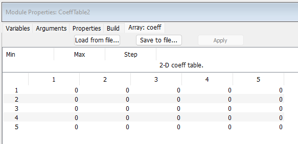

Skipping over the ‘Properties’ and ‘Build’ tabs, we reach the ‘Array: coeff’ tab of the ParamSet Table’s Properties menu:
![](../../__attachments/2907212021/att_11_for_2807103505.png?inst-v=afeb83b1-861e-46b8-b4de-1c642321bb7f)
Figure 19: ParamSet Table 'Array: coeff' Properties Tab
As described above, this table’s dimensions are specified by the numCols and numRows variables in the ‘Arguments’ tab, and the column holding the array that gets written to the target modVar (specified in the ‘Arguments’ tab) gets set by the ParamSet Table’s input pin AND/OR the index variable specified in the ‘Variables’ tab.

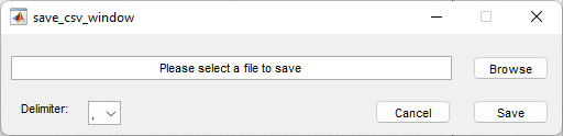

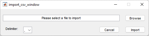

The ParamSet Table module features options to either load a coeff table from a .csv file or save the current table to a .csv file:
![](../../__attachments/2907212021/att_12_for_2807103505.png?inst-v=afeb83b1-861e-46b8-b4de-1c642321bb7f)
Figure 20: ParamSet Table Import from .csv
![](../../__attachments/2907212021/att_13_for_2807103505.png?inst-v=afeb83b1-861e-46b8-b4de-1c642321bb7f)
Figure 21: ParamSet Table Save to .csv

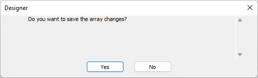

Lastly, any time a change is made to the coeff table in the ‘Array: coeff’ tab, Audio Weaver Designer will prompt to either save or discard the changes made to the array:
![](../../__attachments/2907212021/att_14_for_2807103505.png?inst-v=afeb83b1-861e-46b8-b4de-1c642321bb7f)
Figure 22: ParamSet Table Coeff Array Save/Cancel Changes

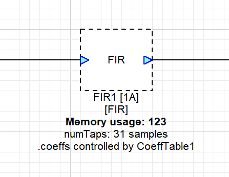

Modules Controlled by the Get/Set Modules
Any module controlled by one of the get/set modules described in this application note, will visually change and display which module it is controlled by in the Audio Weaver Designer canvas, in text under the module. As seen below in Figure 23, the FIR1 module has a dashed outline instead of a solid border, and the text under the module indicate that it’s coeffs array variable is controlled by the CoeffTable1 module:
