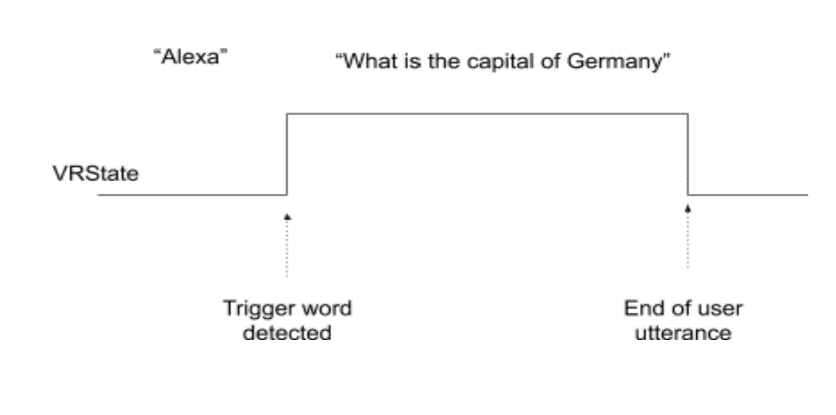

Figure 1 below shows the implementation of the VR State. As can be seen in the figure, the VR State becomes active as soon as the Trigger Word is detected. When either of the Wake Word Engines are triggered, the application code should set the VR State to 1
and ignore the other WWE to eliminate double triggers.
Once the VR State becomes active, it listens to the ASR commands. In cloud-based systems, the information on the end of utterance is provided. As soon as the end of utterance information is provided to the Awelib / AWECore instance, the VR State becomes inactive.

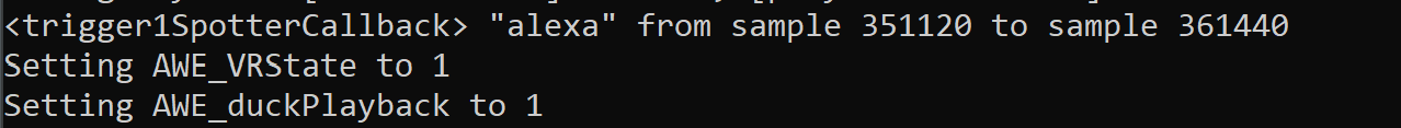

A timer is used to prevent double triggering of the wake word.
As soon as the wake word is detected, a timeout value is set , the VR State becomes active, and the Playback Processor ducks playback. The VR State remains active until a timeout value is reached or an ASR command is detected.
In the TalkToSampleApp, the timeout value is set for 180 blocks. At a block size of 768 and sampling rate of 48000Hz, this corresponds to a timeout value of 2.88 seconds.
If no ASR command is detected for 2.88 seconds after the detection of the wake word, the VR state becomes inactive.

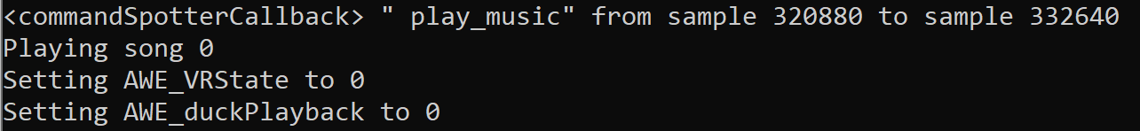

Command Spotter Callback functions and implementation of VR State:
The Command Spotter Callback function shown below is triggered when an ASR command is spotted.
int TalkToSampleApp::commandSpotterCallback(const std::string &phrase, double begin, double end) {
vrStateGenerator->signalCommandDetection();
if (songProvider->isSongPlaying()) {
std::cout << "Playing song " << songProvider->getCurrentSong() << "\n";
else {
std::cout << "Playback stopped" << "\n";
return 0;
As soon as the ASR command is detected, the timeout value is set to 0, thereby making the VRState inactive.

The function
audioCallback
shown below reads the current VR State and compares it with the previous VR State.If there is a change in the VR State, the updated VR State is then displayed on the screen.
When the VR State changes, the Awelib instance of the VUI processor is notified.
