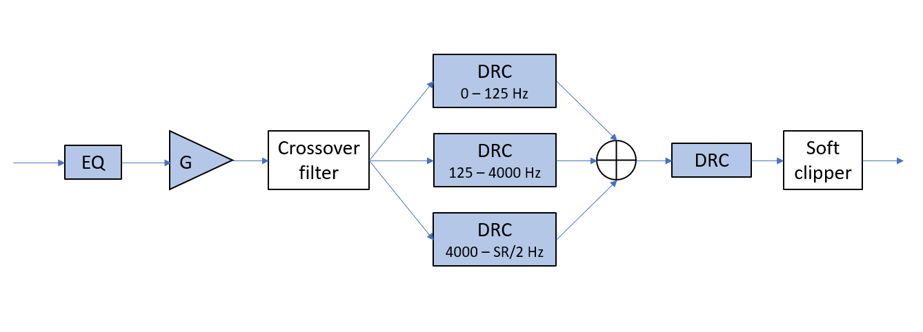

PlayBasic consists of five cascaded biquad filters for equalization and a three-band dynamic range compressor. PlayBasic includes gain control between the biquad filters and the three-band compressor. The three-band compressor is followed by a full-band compressor and a soft clipper to minimize any clipping distortions. PlayBasic works for mono or stereo audio streams and with all sampling rates and block sizes. It is effective for various audio playback hardware devices such as loudspeakers, headphones, earbuds, and smart phones.
Figure 1 shows the block diagram of PlayBasic’s internal processing. The components in blue blocks are tunable.
![](../../__attachments/2955937823/att_2_for_2806218813.png?inst-v=326272e9-cc04-48f3-a51a-5d633eb0a230)
Figure 1: PlayBasic internal processing block diagram

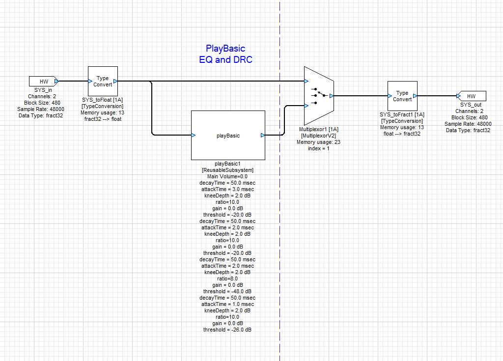

Figure 2 shows an example layout demonstrating the PlayBasic Reusable Subsystem. This example layout is designed to run in Native Mode with a file input; audio signals must be assigned to appropriate channels for running the layout on a target device.
![](../../__attachments/2955937823/att_3_for_2806218813.png?inst-v=326272e9-cc04-48f3-a51a-5d633eb0a230)
Figure 2: Example layout demonstrating the PlayBasic Reusable Subsystem

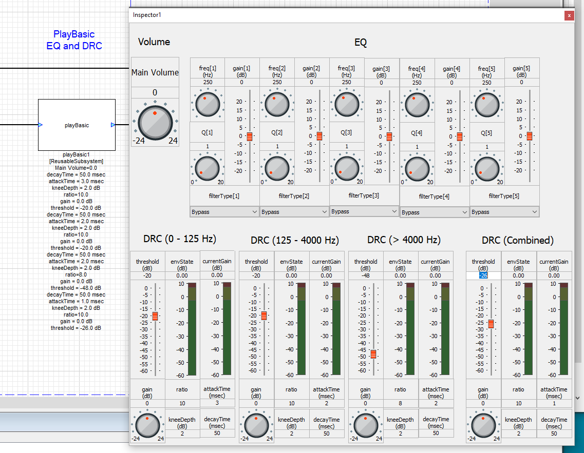

The PlayBasic Reusable Subsystem includes an inspector which allows users to tune the equalization filters, the main volume, and the compressors. Figure 3 show the inspector panel of the PlayBasic Reusable Subsystem.
![](../../__attachments/2955937823/att_4_for_2806218813.png?inst-v=326272e9-cc04-48f3-a51a-5d633eb0a230)
Figure 3: PlayBasic Reusable Subsystem inspector window
Main Volume
The Main Volume is applied after the equalization filters and before the compressors. High Main Volume gains may be counteracted by the compressors depending on the compressors’ tunings.
Equalization Filter
Users can design equalization with five cascaded biquad filters.
There are 22 filter types available (Table 1). Depending on the selected filter types, users can tune a cutoff frequency, a Q value, and a filter gain for the filter. If a biquad stage is unused, select the Bypass option for that filter.

Dynamic Range Compressors
As shown in Figure 1, there are four tunable dynamic range compressors. Each compressor has the following tuning parameters.
Threshold (dBFS) – The compressor attenuates signals above this level.
Gain (dB) – The constant gain in dB applied to the compressor output.
Ratio – The input and output level ratio. Higher ratio values cause the compressor to attenuate signals above the threshold more aggressively.
Knee depth (dB) – Larger knee depth values provide smoother gain transitions around the threshold.
Attack time (ms) – The envelope detector attack time for estimating the signal level.
Decay time (ms) – The envelope detector decay time for estimating the signal level.
