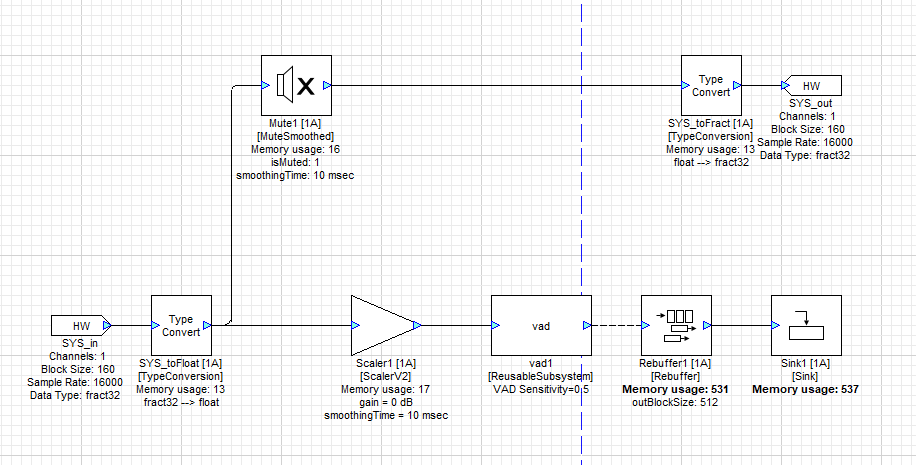

Figure 1 shows an example layout demonstrating the VAD Reusable Subsystem. This example layout is designed to run in Native Mode with a file input; audio signals must be assigned to appropriate channels for running the layout on a target device. VAD should work independently from the signal level, but it is recommended to adjust the signal level (using Scaler1 in this example) to about -30 dBFS for optimal performance.

Figure 1: Example layout demonstrating the VAD Reusable Subsystem

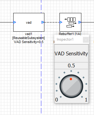

The VAD Reusable Subsystem includes an inspector which allows users to adjust the voice detection sensitivity. Figure 2 show the inspector panel of the VAD Reusable Subsystem. The VAD sensitivity ranges from 0 to 1, with 0 yielding rare voice detection and 1 yielding very frequent voice detection. DSP Concepts recommends using 0.5 for optimal detection.

Figure 2: VAD Reusable Subsystem inspector window
