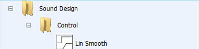

The LinSmooth module can be found in Sound Design/Effects folder or by using the search window in the module browser. It is called “Lin Smooth”.
![](../../__attachments/3037200454/image-20240104-235919.png?inst-v=afeb83b1-861e-46b8-b4de-1c642321bb7f)
Figure 1. Location in Module Browser

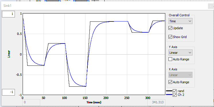

The modules with smoothing built-in use a one-pole IIR filter whose rise-time is defined as the time for the output to go from 0% to about 62% when the input goes from 0% to 100%. The rise and fall times for this type of filter are the same. The shape of the transition is exponential.

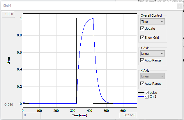

In the example below, the smoothing time is set to 20 msec.
Black: lnput signal
Blue: Smoothed signal
![](../../__attachments/3037200454/att_3_for_3037200454.png?inst-v=afeb83b1-861e-46b8-b4de-1c642321bb7f)
Exponential smoothing

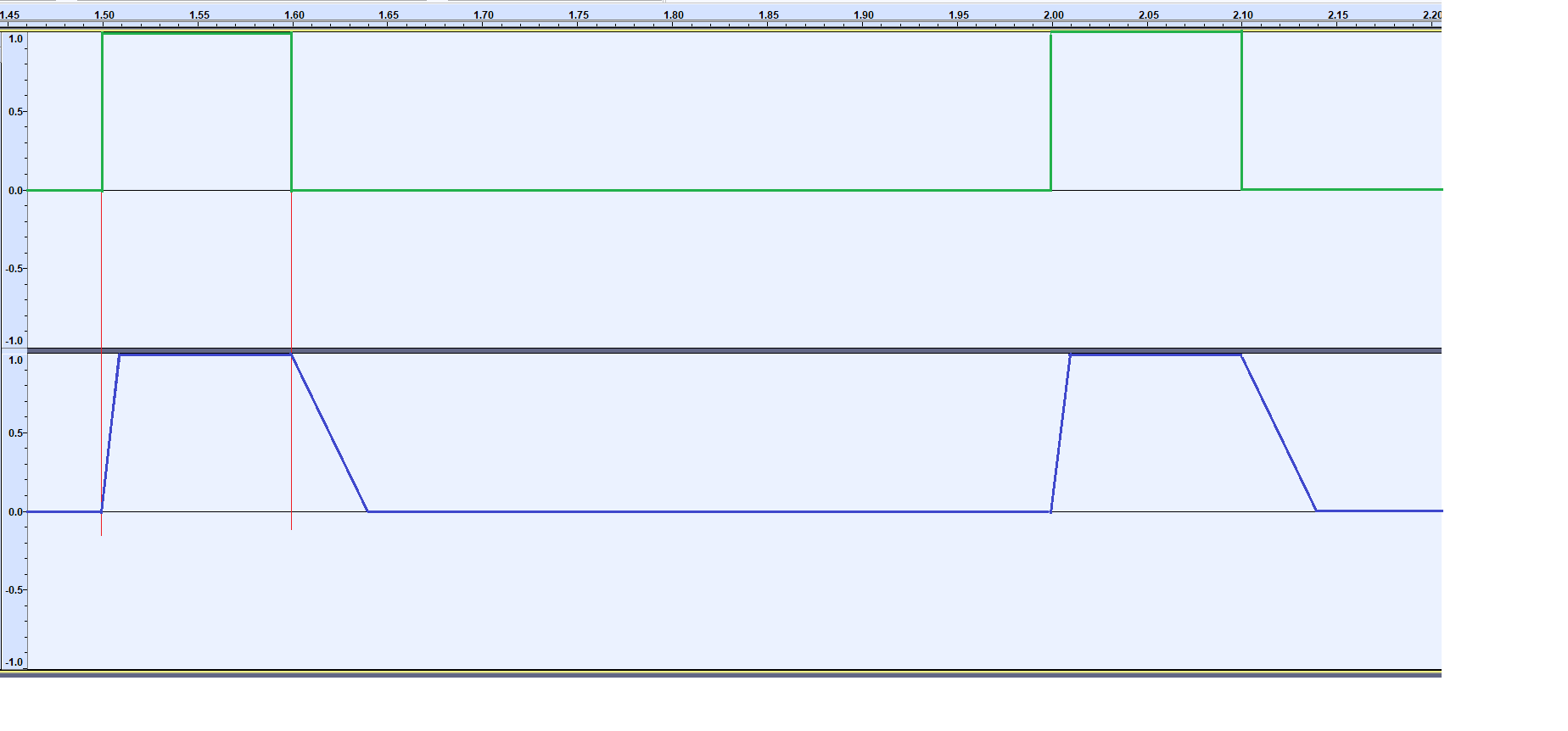

The LinSmooth supports individual slope control for increasing (TimeUp) and decreasing (TimeDown) levels.
Green: LinSmooth Input
Blue: LinSmooth Output
Settings:
![](../../__attachments/3037200454/att_1_for_3037200454.png?inst-v=afeb83b1-861e-46b8-b4de-1c642321bb7f)

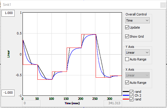

The attached file LinSmooth_vs_ExpSmooth.awd generates a random number between -1 and 1 every 50 msec. The same signal is sent to a LinSmooth module and a ScalerV2 module, the latter with a DC Source of 1.0 and set to linear gain mode. The scaler’s output therefore shows the gain signal with the ScalerV2 module’s built-in exponential smoothing applied.
First, let’s set the smoothing times for both modules to 10 msec.
Black: LinSmooth output
Blue: ScalerV2 output showing exponential smoothing
![](../../__attachments/3037200454/att_4_for_3037200454.png?inst-v=afeb83b1-861e-46b8-b4de-1c642321bb7f)

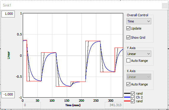

Red: Random input
![](../../__attachments/3037200454/att_5_for_3037200454.png?inst-v=afeb83b1-861e-46b8-b4de-1c642321bb7f)

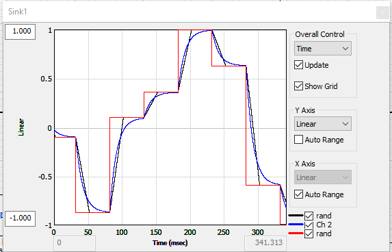

In the example below, the LinSmooth’s up and down smoothing times are set to 20 msec. The Scaler’s smoothing time is set to 10 msec. The two controls track more closely (which may or may not be your goal).
Red: Random input
![](../../__attachments/3037200454/att_6_for_3037200454.png?inst-v=afeb83b1-861e-46b8-b4de-1c642321bb7f)

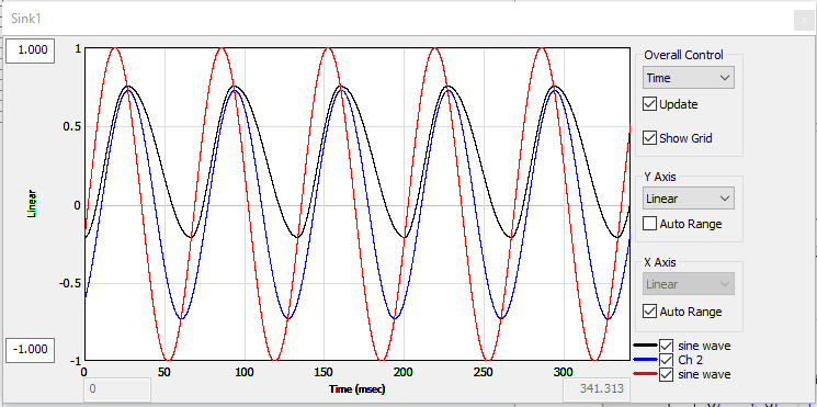

Using LinSmooth with Continuously Varying Signals
You can also use LinSmooth to change the shape of continuous signals such as sine waves. This example shows a 15 Hz sine wave. Note that the input sine wave (red) goes from -1.0 to 1.0.
Blue: through the exponential smoothing of the ScalerV2 (which acts as a low pass filter, attenuating and shifting in phase, but doesn’t change the shape).
Black: through a LinSmooth module with Up time = 10 msec and Down time = 30 msec. The signal is attenuated and shifted in phase, but its shape has been changed as well. The change in shape will increase with the sine wave’s frequency. This introduces harmonics into the result and is a form of distortion.
