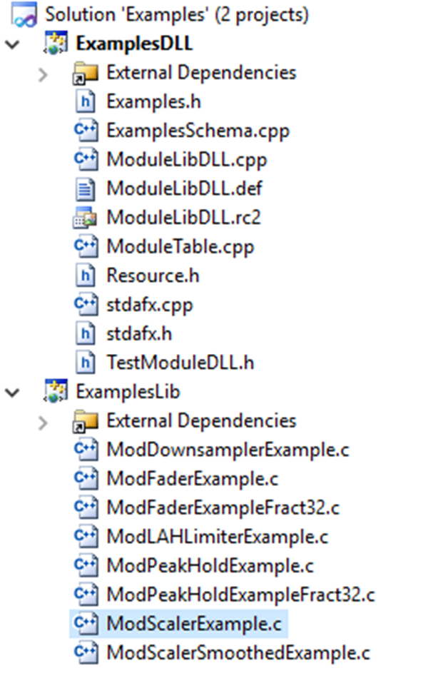

make_examplesOpen up the Visual Studio solution <AWE>\AWEModules\Source\Examples\Examples.sln
The solution contains two projects shown below:
The ExamplesLib compiles the module source files and builds an overall library. The ExamplesDLL project builds the DLL. ExamplesLib is easily understood by C programmers. Understanding ExamplesDLL requires some Windows expertise. Fortunately, you can use the Examples projects as starting points for your own custom DLL development and do not have to delve into the underlying Windows issues.
To build the audio module DLL, right-click on ExamplesDll and select Rebuild, ensuring that the x86 Release configuration is selected. The project dependencies are set so that first ExamplesLib will be built followed by ExampleDll.

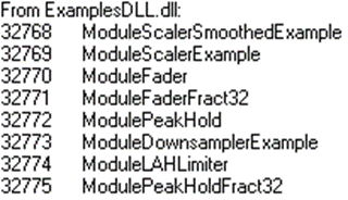

If the DLL was properly built, you'll be able to open the Server and see the new library of examples listed. Select Target > List Modules and scroll down the list looking for the ExamplesDLL.dll entry:
