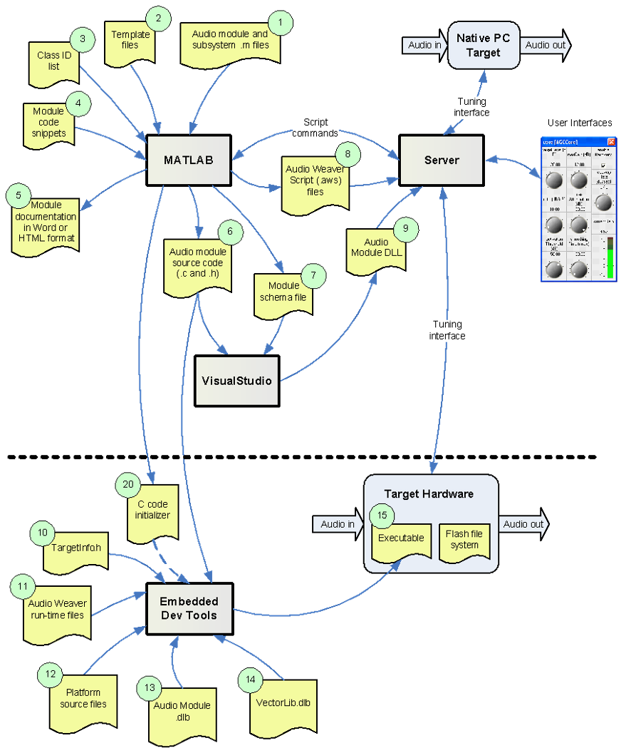

The Audio Weaver environment utilizes MATLAB, a PC-based Server, a hardware target, and development tools for the hardware target, as shown in Figure 1.  Much of the design is orchestrated by MATLAB including describing modules, generating code, and generating documentation.
Steps 1 through 9 shown above the dark line in the figure below are for creating custom audio module DLLs on the PC.  The main output is an audio module DLL shown as item 9.  The DLL encapsulates all of the information required by the Server to natively execute an audio module.  This includes the module C functions – Constructor, Set, Get, Process, and Bypass – and schema information describing the module instance data structure to the Server.  A DLL may contain one or more audio modules.
The custom module DLL is copied into the same directory as the AWE_Server executable.  When the Server is launched, it loads all of the audio module DLLs contained in the executable directory and the new modules are then available for use.
Items 10 through 15 shown below the dark line sare associated with creating custom audio modules on an embedded target.  You first create the custom audio module DLL on the PC and then compile the generated module source files (item 6) using your embedded development tools.  Several libraries and source files are pulled together to create the new executable for the target (item 15).
Also shown in the figure below is a C code initializer file (item 20).  This file is used when the target lacks a tuning interface, and initializes the audio processing to a known state.
This document focuses exclusively on items 1 through 9 – those associated with creating custom audio module DLLs on the PC.  The AWE-Core™ Integration Guide takes you through the remaining steps needed to update the audio module library on an embedded target and to create C code initializers.
Overall Audio Weaver module design environment.  The steps above the dark line are required to develop custom audio modules on the PC.  The steps below the dark line are for developing custom audio modules for an embedded processor.
