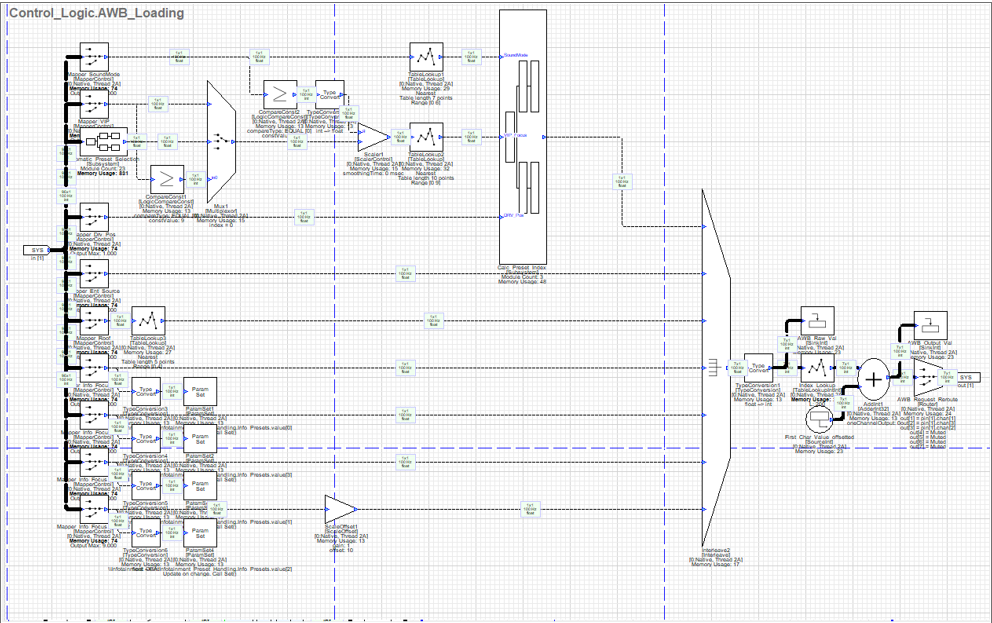

The BSP needs to first load the “structure AWB” to create the system, and afterwards, depending on car network signals, the corresponding “parameter AWB”
  1. Car network signals are forwarded into signal flow
  2. Mapping and naming of AWBs are done inside of signal flow
  3. Naming is based on 4 ASCII characters, packed into a single 32-bit integer value
  4. 32-bit integer is read out by BSP, BSP then loads file according to name

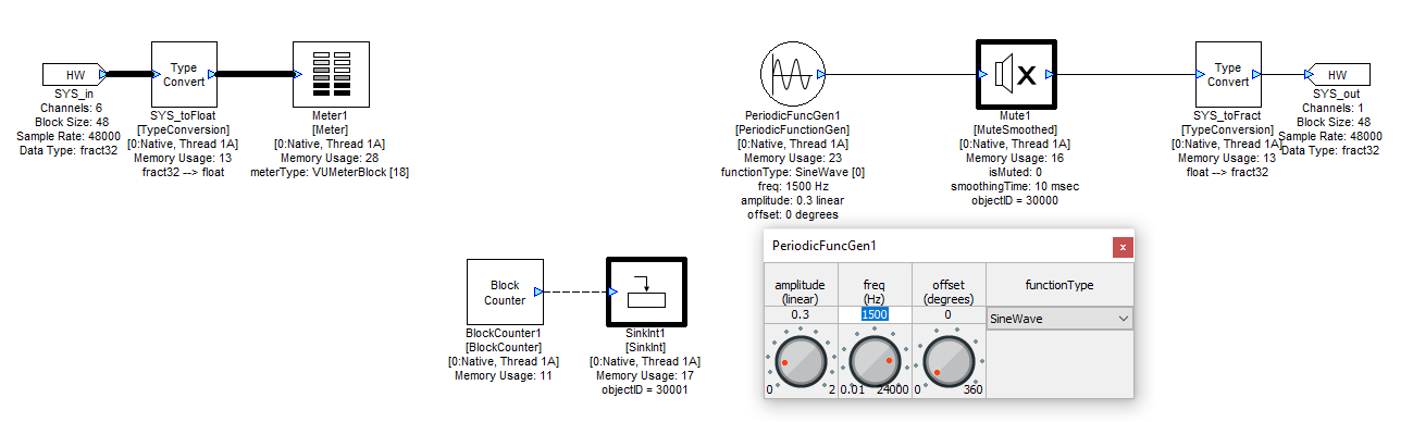

  3. In the design, make changes to the parameters you wish to change. In this example the design “HW_Button_Mute.awd is used from the Control Interface and Debugging app note here: Control Interface Usage and Debugging and the change made was in the PeriodicFuncGen1 module on the “freq” parameter (from 1000 to 1500Hz):

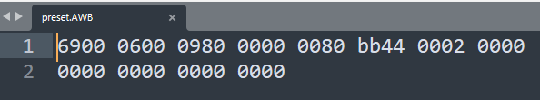

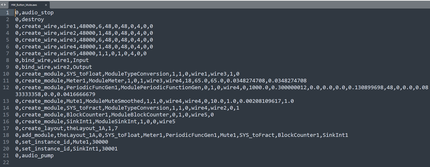

  1. A new preset.aws file will be generated in the current matlab path and shows the following:
This is in contrast to the structure .aws which shows the entire layout as such:
  1. (Optional, or proceed to step 8) Before converting this preset.aws to an .awb we can run a simple test that the preset script works when executed. Start by running the design, in this case with freq set back to 1000. This could also be run Natively or Embedded using the structure .aws from the Server window by going to File → Execute Script:
  1. With the design running, in the Server window go to File → Execute script again, but this time select preset.aws. The design should continue to run, with the only change being the frequency parameter.

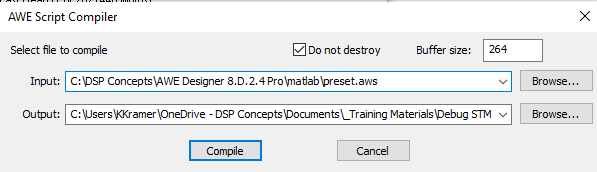

  2. With the preset.aws confirmed to be working, we can convert to an .awb file by going to File → Compile Script in the Server window:
9. Select the preset.aws source file and destination for an .awb in the AWE Script Compiler Window:
This will generate the target specific binary command for changing the frequency to 1500Hz:
  1. This .awb can also be executed from Server window in the same manner as the .aws file.

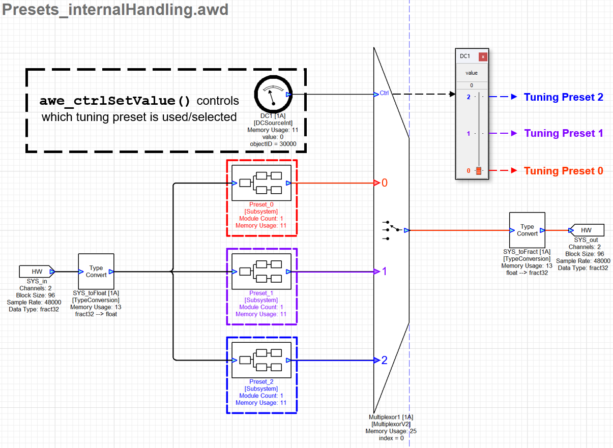

Internal Handling
Presets can also be handled internally in the signal flow
•Modules that can be used for this are for example:
NOTE: Functionality in Param Set Table V2 can also be achieved with combining the Array Set and Table Source V2 modules for multi-dim tables or Param Set modules for scalar variables. But Param Set Table V2 adds more convenience, e.g. it supports writing into scalar values (not arrays only), Array Set by itself does not support "OnChangeSet" behavior, hence fewer number of modules in total will be required.
