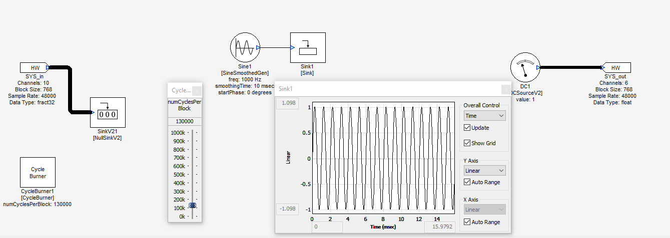

Create a dummy design with Audio Weaver similar to Figure 1. Correctly configure the input/output of the design as the target system requires. If a passthrough design is already available, that may be used as well.
Figure 1: Dummy Design with Cycle Burner
Add “Sine Smoothed Gen” and “Sink Display” modules to the design. Leave the Sink window open to increase data exchange while it runs.
Add a “Cycle Burner” module to the design. Set numCyclesPerBlock to 1000 and run the design on the target.

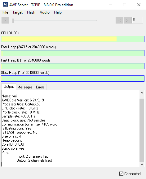

Gradually increase numCyclesPerClock while monitoring through the AWE Server. Stop once the CPU load reaches at least 75% (Figure 2).
Allow AWE Designer to continue running the design for at least 1 hour.
There should be no crashes or server disconnections during the stability test. If any occur, debugging is needed to address the issue.

Monitor the CPU load in the AWE Server window during the run. Adjust “Number of Biquads to load” to reach at least 75% CPU load in the AWE Server window.

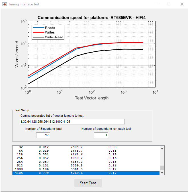

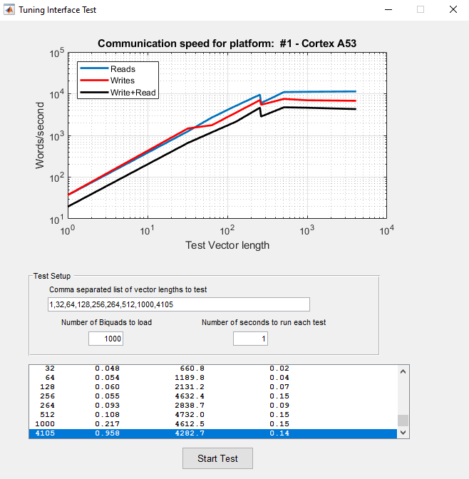

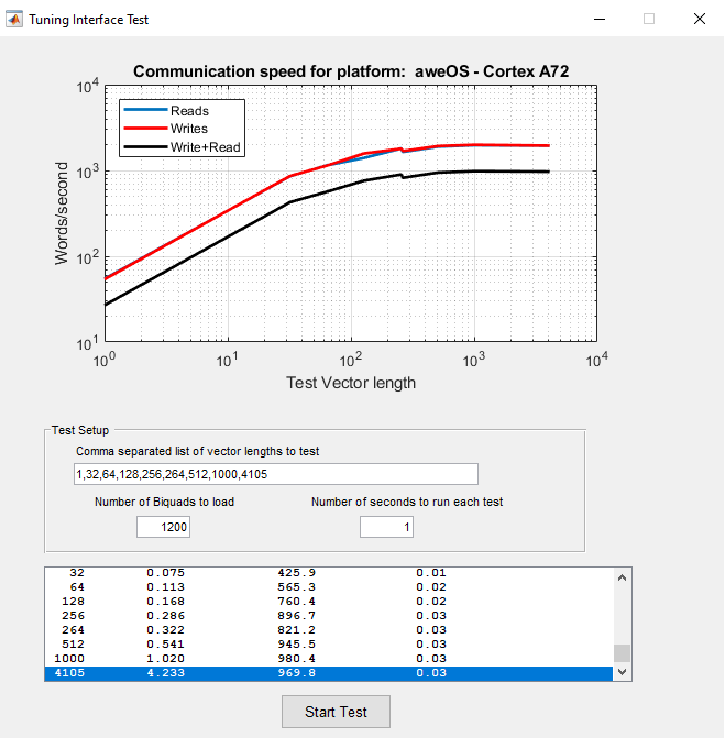

Test results may vary depending on the interface used for tuning. TCP/IP is the recommended interface if the target platform supports it. TCP/IP normally offers sufficient bandwidth for the tuning traffic (Figure 3). AWECoreOS also provides APIs to directly enable the TCP/IP interface for easy integration (Figure 4). Other interfaces are also supported such as USB HID and Serial UART but the interface bandwidth may differ. When UART is used, the baud rate should be at least 115200 (Figure 5).
Figure 3: Typical TCP/IP Results
Figure 4: USB (HID) tuning interface as tested on RT685
Figure 5: Serial UART at 115200 Baud Rate as Tested on Raspberry Pi 4
If the test result on the target platform is slower with the corresponding interface than what is shown above, it should be investigated. Please reach out to the DSP Concepts support team for assistance if needed.
