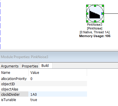

The ClockDivider field in Properties when left blank will default to 1A0. This represents clock divider “1”, subLayoutID “A” and instance “0”. The instance value can be changed to move that module to a designated core (4 virtual cores by default in Designer [0,3]) and profiled separately. The clock divider changes as a result of buffering up or down.
Note: The clock divider field is only user editable for source modules and automatically assigned for the rest.
For example, if 1A0 were changed to 1A1, profiling for that module would could be seen on the second instance on the Server:

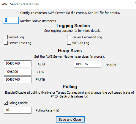

NOTE: By default, 4 virtual instances are created in Designer Native. These can be changed in Server Preferences, and memory will be divided between them:

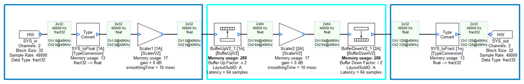

To change block sizes within a design, Buffer Up creates a new layout within Audio Weaver and is used in conjunction with Buffer Down. This layout will appear as a continuation of the signal flow in the same design file, however the portion of the system between Buffer Up and Buffer Down will operate at a different block size (whole number multiple of the input block size) and in a different layout, designated in the module’s properties tab.
The layoutSubID allows you to run multiple sets of modules at the same clockDivider in different layouts by setting the block size, and layoutSubID. For instance, the system input pin is always in layout 1A, and any layouts with the same clock divider could reside in 1B, 1C, alphabetically up to 1P. By changing to a higher block size, the user would be creating a second clock divider, where the user can add up to 16 layout subIDs in this new block size (2A, 2B, 2C, etc.).
Multithreading Example:
For the middle part of this layout to run, the outer parts of the layout
need to run twice (two pumps of 32 samples = 64 block size)
When you build a layout like this, Audio weaver will split it into two layouts. The layouts are processed in separate threads because they have different block sizes.
The higher priority layout will execute the far left and right sections of the system
The lower priority layout will execute the middle section of the system

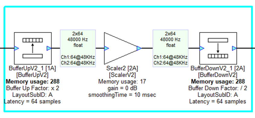

Latency effects of Multithreading

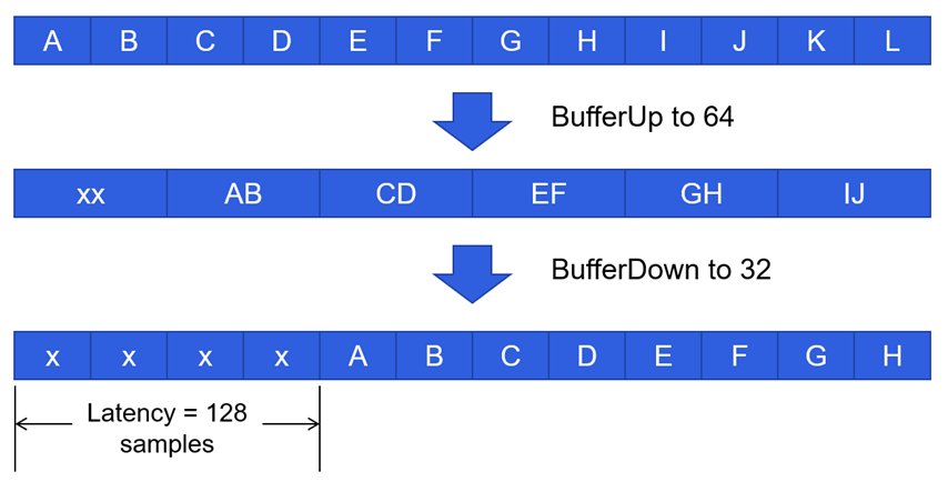

When a system’s block size is multiplied X times to buffer up, the smaller block size portion of the layout will need to run X number of times to fill the higher block size buffer. Additionally, when buffering down, the larger block size will pump smaller portions to the lower block size X number of times. Shown in Figure 2.0, buffering up incurs 64 samples of latency, then buffering down incurs another 64 samples, for a total of 128. At a sample rate of 48kHz, this would amount to 2.6ms of latency.
Latency as Result of Buffering Up/down

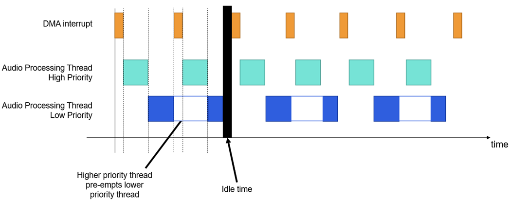

Processing Priority
The high priority thread will be given however many ticks are needed between DMA interrupts, before the lower priority thread is able to be processed. If the lower priority thread is not finished processing before the next DMA interrupt, processing will be paused until the next time the high priority thread is finished processing.
Processing Priority of 2 Threads

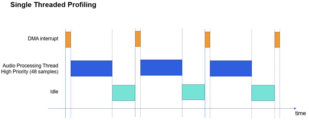

Single Thread Example

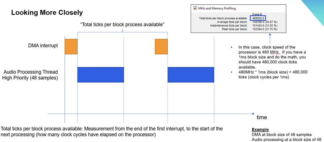

Profiling
In the example below, a system with a block size of 48 samples is run on a processor with a clock speed of 480 MHz.
With a sample rate of 48,000 Hz, each block will take 1 ms to process.480 MHz * 1 ms = 480,000 ticks per block process available.
