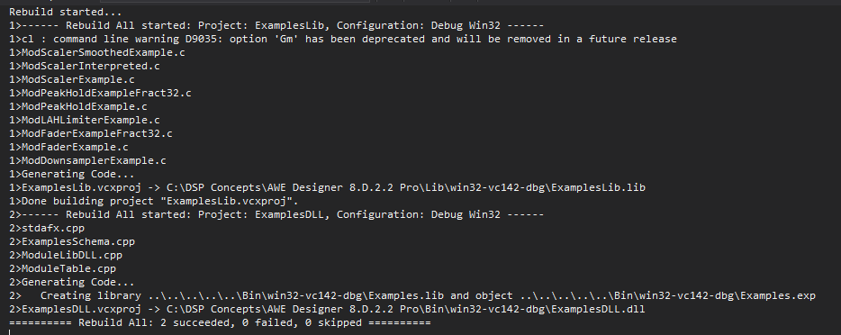

Rebuild the solution to recompile everything. Successful output is shown below.
![](../../__attachments/3344499311/att_47_for_3037724858.png?inst-v=a3548390-4fa1-4c4d-97c4-7b05523329b5)

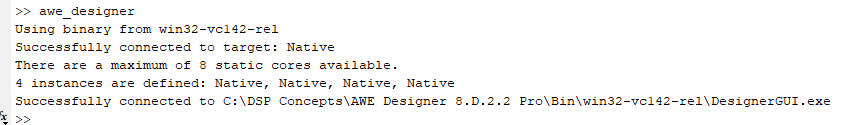

Run Audio Weaver from MATLAB.
![](../../__attachments/3344499311/att_4_for_3037724858.png?inst-v=a3548390-4fa1-4c4d-97c4-7b05523329b5)

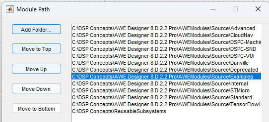

Confirm that the Examples folder is in your module path (File->Set Module Path).
![](../../__attachments/3344499311/att_48_for_3037724858.png?inst-v=a3548390-4fa1-4c4d-97c4-7b05523329b5)

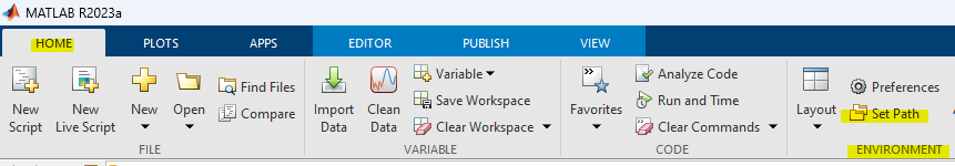

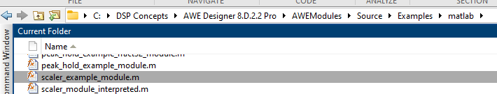

Make sure that the module’s “matlab” folder is either the current folder, or in the MATLAB path.
![](../../__attachments/3344499311/att_5_for_3037724858.png?inst-v=a3548390-4fa1-4c4d-97c4-7b05523329b5)
or
![](../../__attachments/3344499311/att_49_for_3037724858.png?inst-v=a3548390-4fa1-4c4d-97c4-7b05523329b5)
We’ll demonstrate the Scaler Example module.

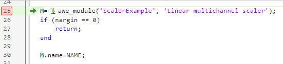

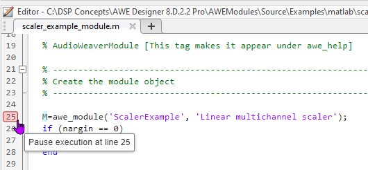

Open the file “scaler_example_module.m”.
To add a breakpoint to your MATLAB code, click on the line number. Add a breakpoint on the “awe_module” instruction line.
![](../../__attachments/3344499311/att_50_for_3037724858.png?inst-v=a3548390-4fa1-4c4d-97c4-7b05523329b5)

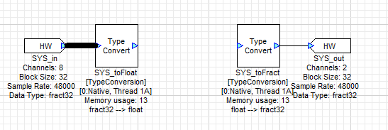

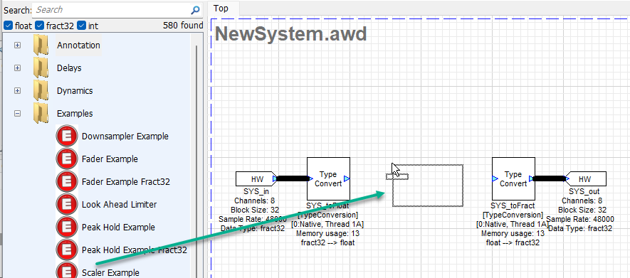

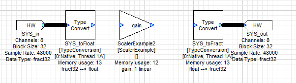

In this example layout, we have started by removing the deinterleave and interleave modules from the default layout. Find the “Examples” folder in the Module Browser and drag a Scaler Example module into your layout.
![](../../__attachments/3344499311/att_54_for_3037724858.png?inst-v=a3548390-4fa1-4c4d-97c4-7b05523329b5)

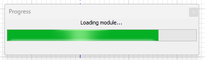

When you drop the module, you see the “Progress” dialog continuously. That’s because you hit the MATLAB breakpoint.
![](../../__attachments/3344499311/att_6_for_3037724858.png?inst-v=a3548390-4fa1-4c4d-97c4-7b05523329b5)

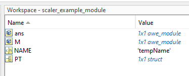

Check the value of variables in the “Workspace”.
![](../../__attachments/3344499311/att_9_for_3037724858.png?inst-v=a3548390-4fa1-4c4d-97c4-7b05523329b5)

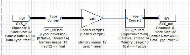

Complete the layout as shown:
![](../../__attachments/3344499311/att_14_for_3037724858.png?inst-v=a3548390-4fa1-4c4d-97c4-7b05523329b5)

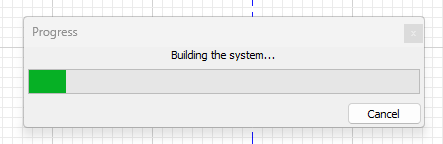

Now build and run the layout.
![](../../__attachments/3344499311/att_15_for_3037724858.png?inst-v=a3548390-4fa1-4c4d-97c4-7b05523329b5)

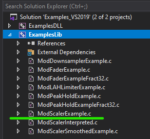

Locate ModScalerExample.c in the Solution Explorer and open it.
![](../../__attachments/3344499311/att_16_for_3037724858.png?inst-v=a3548390-4fa1-4c4d-97c4-7b05523329b5)
Add a breakpoint at the awe_modScalerExampleProcess() function.
![](../../__attachments/3344499311/att_17_for_3037724858.png?inst-v=a3548390-4fa1-4c4d-97c4-7b05523329b5)

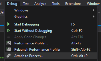

In VS2019, select “Debug->Attach to Process”.
![](../../__attachments/3344499311/att_18_for_3037724858.png?inst-v=a3548390-4fa1-4c4d-97c4-7b05523329b5)

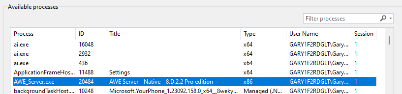

Choose “AWE_Server.exe” from the list, then click on the “Attach” button.
![](../../__attachments/3344499311/att_51_for_3037724858.png?inst-v=a3548390-4fa1-4c4d-97c4-7b05523329b5)

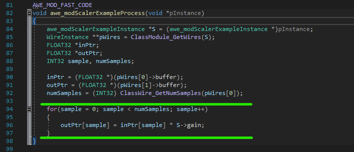

![](../../__attachments/3344499311/att_52_for_3037724858.png?inst-v=a3548390-4fa1-4c4d-97c4-7b05523329b5)
The green lines highlight the inner loop which processes all samples in the block one by one.

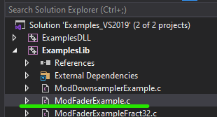

In the VS2019 Solution Explorer, open ModFaderExample.c.
![](../../__attachments/3344499311/att_22_for_3037724858.png?inst-v=a3548390-4fa1-4c4d-97c4-7b05523329b5)

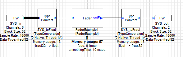

Start a new layout and remove the DeInterleave and Interleave modules.
![](../../__attachments/3344499311/att_27_for_3037724858.png?inst-v=a3548390-4fa1-4c4d-97c4-7b05523329b5)

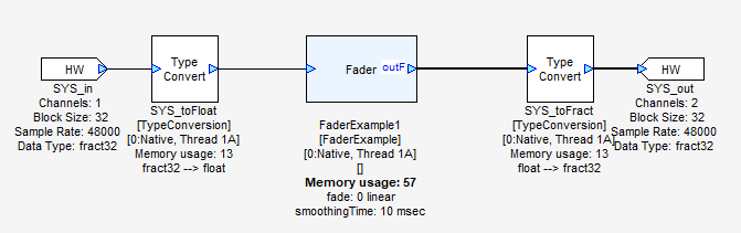

Drag in the Fader Example module and complete the layout as shown.
![](../../__attachments/3344499311/att_28_for_3037724858.png?inst-v=a3548390-4fa1-4c4d-97c4-7b05523329b5)
Set numChannels on the input pin to 1.
![](../../__attachments/3344499311/att_29_for_3037724858.png?inst-v=a3548390-4fa1-4c4d-97c4-7b05523329b5)
![](../../__attachments/3344499311/att_30_for_3037724858.png?inst-v=a3548390-4fa1-4c4d-97c4-7b05523329b5)

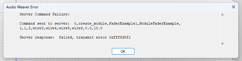

Build and run the layout. This time, we see a more detailed error when we hit the breakpoint.
![](../../__attachments/3344499311/att_31_for_3037724858.png?inst-v=a3548390-4fa1-4c4d-97c4-7b05523329b5)
AWE Server is still “there”, but we have stopped it, so the Designer Application times out. This is all normal.

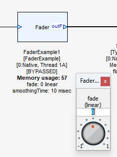

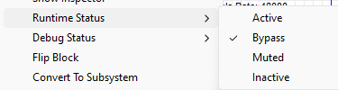

Use the Fader’s popup menu to bypass the module.
![](../../__attachments/3344499311/att_42_for_3037724858.png?inst-v=a3548390-4fa1-4c4d-97c4-7b05523329b5)

Bad things can happen
AWE Server can crash. It may be necessary to restart it from AWE Designer.
AWE Designer can crash. It may be necessary to restart it.
It may be necessary to restart MATLAB.
It may be necessary to force kill MATLAB using Task Manager.
You may have to reattach the VS2019 debugger to AWE Server (use “Debug->Reattach to Process”)
