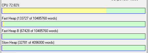

Running this program gives the following results on a Windows 10 PC with the following specs:
AMD Ryzen 5 2600 CPU @ 3.40 GHz
16 GB RAM
AWE Server display:
![](../../__attachments/3343910044/att_1_for_3038941651.png?inst-v=a3548390-4fa1-4c4d-97c4-7b05523329b5)
Figure 1. Performance with FIR Module

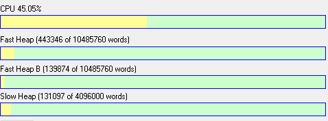

Now run the LongFIRExample1a.awd in AWE Designer. Here is the performance, along with a table comparing these results to the previous example which used the regular FIR module.
![](../../__attachments/3343910044/att_3_for_3038941651.png?inst-v=a3548390-4fa1-4c4d-97c4-7b05523329b5)
Filter | CPU | Fast Heap | Fast Heap B | Slow Heap | Total RAM |
FIR | ~73.0% | 133727 | 67428 | 32781 | 233,936 |
Long FIR | ~45.0% | 443346 | 139874 | 131097 | 713,217 |
As you can see, using the Long FIR module achieves a roughly 28% saving in CPU cycles at the expense of using about 3 times as much RAM on this PC. The actual differences in performance and RAM usage will depend on the actual device running the program.

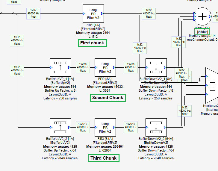

Let’s take a look at the example patch. The input signal is sent to three parallel processing paths, identified as “First Chunk”, “Second Chunk” and “Third Chunk”.
![](../../__attachments/3343910044/att_15_for_3038941651.png?inst-v=a3548390-4fa1-4c4d-97c4-7b05523329b5)
The impulse response WAV file has been broken into 3 chunks by the MATLAB script, matching the size of the data to the length (in taps) of each filter. The audio data goes directly to FIR1 which is implementing the first chunk of the impulse response (512 taps). The subsequent Long FIR Filter V2 blocks need to have BufferUpV2 blocks added to increase the size of data that is being processed at one time. Here’s how to do it. (The supplied LongFIRExample.awd file implements this).
Set the length (Argument “L”) of the first Long FIR module to 512.
In the BufferUpV2 block for the second chunk, adjust the BufferUpFactor to be 512/2 * (input pin block size). In this example that is 512/(2 * 32) = 8.
Set the length L of the FIR2 module to an integer multiple of the FIR1 module’s length. In this case we have used 512 * 7 = 3584.
Note that the total length of FIR1 and FIR2 is 512 + 3584 = 4096.
In the BufferUpV2 block for the third chunk, adjust the BufferUpFactor to be 4096/2 * (input pin block size). In this example that is 4096/(2 * 32) = 64.
The length of FIR3 is determined by taking the total length of the first two chunks and subtracting that from the total length of the impulse response’s WAV file in samples. In this example, 67,421 - 4096 = 63,325. Now you need to round that to the next highest multiple of (FIR1 + FIR2)’s length. That is calculated as 4096 * (floor (63,325 / 4096) + 1) = 65536. We’ll add (65536 - 63325 = 2211) zeroes at the end of the data.

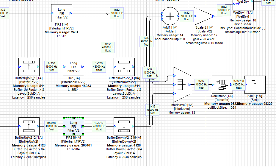

Reconstructing the filter response
The output of FIR1 goes to the first input of Adder Add1.
The output of FIR2 goes through a BufferDownV2 block and then to the second input of Add1.
The output of FIR3 goes through a BufferDownV2 block and then to the third input of Add1.
![](../../__attachments/3343910044/att_17_for_3038941651.png?inst-v=a3548390-4fa1-4c4d-97c4-7b05523329b5)

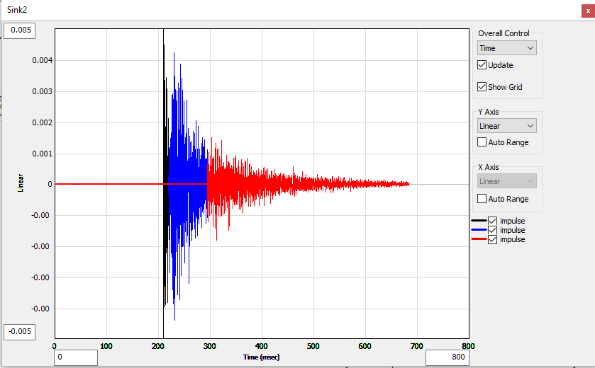

This design also interleaves the 3 signals onto a single wire and sends them through a Rebuffer module and onto a Sink, so that we can see that the impulse response has been reconstructed from the 3 separate filters and properly time aligned. The Interleave, Rebuffer, and Sink modules are not needed other than to see this and can be omitted from your own designs.
The Multiplexor1’s index checkbox has been selected, so that we are feeding impulses from ImpulseMSecSource1 to the filter. This allows you to check both the basic sound of the reverb and visually compare the reconstructed impulse response with the original signal.
Run the patch, then click on “Sink2” to open the waveform display.
![](../../__attachments/3343910044/att_13_for_3038941651.png?inst-v=a3548390-4fa1-4c4d-97c4-7b05523329b5)
You can see by the colors that the composite impulse response has been reconstructed by adding the 3 signals together.

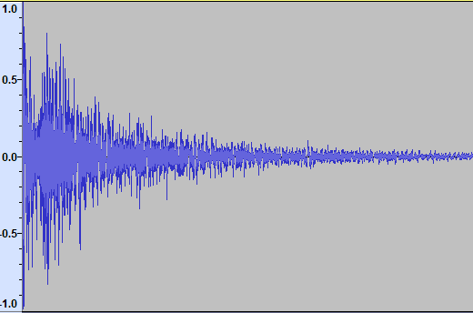

For comparison, here is the waveform view in Audacity of the original WAV file.
![](../../__attachments/3343910044/att_10_for_3038941651.png?inst-v=a3548390-4fa1-4c4d-97c4-7b05523329b5)

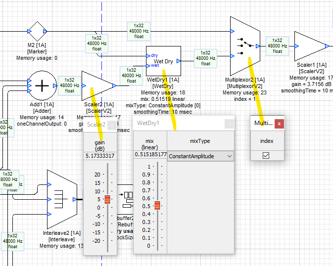

Signal Mixing and Bypass
Scaler2 allows you to adjust the level of the reconstructed reverb signal. This feeds into WetDry module WetDry1, which lets you set the balance between the dry (input) signal and wet (reverb). At a setting of 0, you just hear the dry signal. At 1.0, you only hear the reverb signal.
The MultiplexorV2 Multiplexor2 implements a bypass function. When the index checkbox is selected, the reverb is engaged.

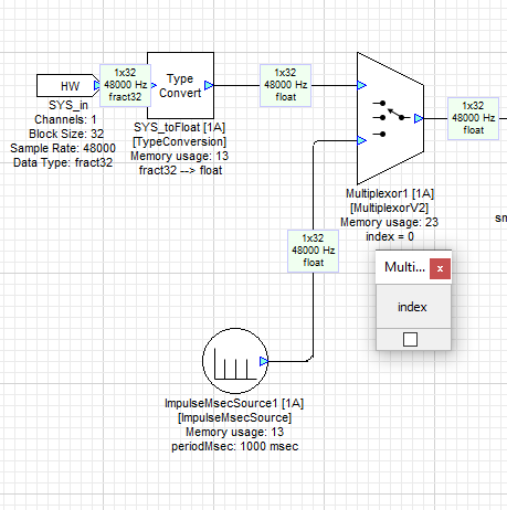

Input Signal Selection
Using the MultiplexorV2 Multiplexor1, you can select either the default signal source, or a series of impulses (clicks) that repeat once a second (if the index is checked). Impulses are a convenient and consistent way to test reverb algorithms.
