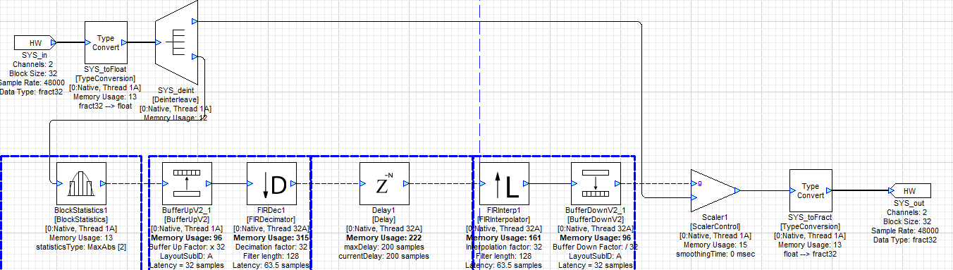

Example 1: Using a control signal coming in on the input pin
Delaying Control Signals - example 1.awd
In this example, the control signal which we wish to delay at a lower sample rate is coming in on the layout’s input pin on channel 2 at 48 kHz with a block size of 32. Channel 1 carries the audio data which will have its gain adjusted by the delayed control signal.
The first sample rate reduction occurs as a result of the Block Statistics module which outputs a block size of 1 regardless of the input Block Size. The output sample rate is the input sample rate divided by the input block size. 48000/32 = 1500 Hz.
In order to reduce the sample rate further, we have to buffer up after which we can use a decimator. The buffer up factor and the decimation factor are set to the same value (32) resulting in a signal of block size 1 which is at 1500/32 = 46.875 Hz. This sets the resolution of the delay setting to 1/46.875 = 21.3 msec per sample.
The delay module is now operating with a block size of 1 at 46.875 Hz. In this example, 200 samples will result in a delay of about 4.27 seconds. If we had run the delay line at 48000 Hz, this same delay would have required 204,800 samples.
Following the Delay module, we use a FIR Interpolation module to return the signal sampling rate to 1500 Hz (48000/32). Finally, a BufferDown module reduces the block size to 1 which makes it equivalent to a control signal coming from a DC Source.
The total delay time includes the latency of the Buffering, Decimation, and Interpolation stages in addition to the Delay module itself.
View the accumulated delay by selecting View->Accumulated Delay.
Accumulated Delay
The accumulated delay in this example is 6591 samples @ 1500 Hz or 4.394 seconds. The Delay itself contributes 4.267 seconds, so the delay contribution of the additional processing is about 0.127 seconds.

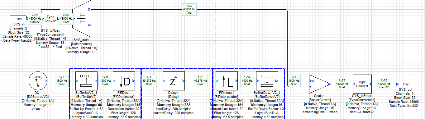

Example 2: Using a control signal coming from a DC Source.
Delaying Control Signals - example 2.awd
This is very much like the first example, with the exception that we set the DC Source to run at 1500 Hz (input sample rate/input block size) with a Block Size of 1, so the first BlockStatistics module is not needed.

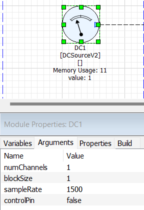

Set the DC Source’s blockSize and sampleRate.
Delaying a DC Source

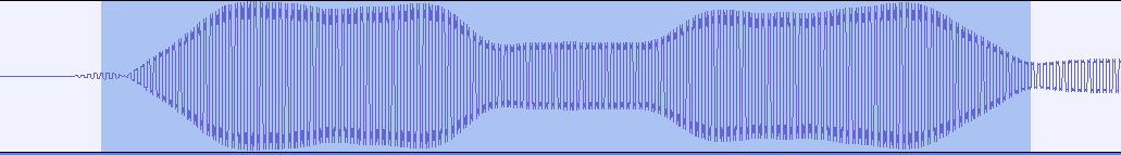

When using the FIR interpolator, if the filter length is too short, you will see artifacts in the delayed control signal.
Delayed control signal with FIR length = 32.
Delayed control signal with FIR length = 128.
