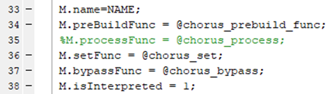

Add the line "M.isInterpreted = 1;" to the <modulename>_module.m file (found in the “matlab” folder of your custom module) anywhere after the “M = awe_module(…” assignment in the “matlab/” directory of your custom module.
![](../../__attachments/3170697571/image-20231121-160635.png?inst-v=326272e9-cc04-48f3-a51a-5d633eb0a230)
Figure 4

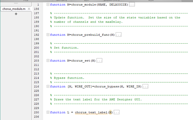

Separate out functions contained in the <modulename>_module.m file to individual .m files.
![](../../__attachments/3170697571/image-20231121-160302.png?inst-v=326272e9-cc04-48f3-a51a-5d633eb0a230)
![](../../__attachments/3170697571/image-20231121-160309.png?inst-v=326272e9-cc04-48f3-a51a-5d633eb0a230)
Figure 2 - Before separating functions into unique .m files
![](../../__attachments/3170697571/image-20231121-160420.png?inst-v=326272e9-cc04-48f3-a51a-5d633eb0a230)
![](../../__attachments/3170697571/image-20231121-160426.png?inst-v=326272e9-cc04-48f3-a51a-5d633eb0a230)
Figure 3- After separating functions into unique .m files
NOTE: Confirm there is a corresponding .m file for any function being defined.
Move any module function up to the same folder as the <modulename>_module.m

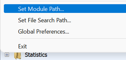

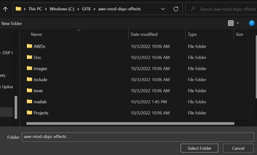

Set Module Path in Designer
In Designer Standard, go File-> Set Module Path, then click Add Folder, select your custom module folder, and click Select Folder. Your module should now show in the modules tab and load into Designer.
![](../../__attachments/3170697571/image-20231121-160821.png?inst-v=326272e9-cc04-48f3-a51a-5d633eb0a230)
![](../../__attachments/3170697571/image-20231121-160839.png?inst-v=326272e9-cc04-48f3-a51a-5d633eb0a230)
Figure 5- Add Module Path

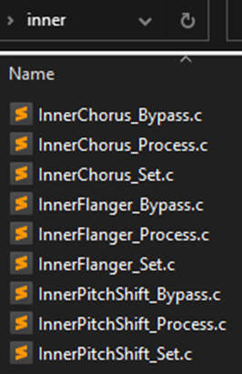

Not all files used to create a custom module are necessary to have present when running the compiled module. The Mod<XYZ>.c and inner<XYZ>.c files may contain sensitive source code, but can be removed from the file path before sending and the custom module will still work.
![](../../__attachments/3170697571/image-20231121-160900.png?inst-v=326272e9-cc04-48f3-a51a-5d633eb0a230)
![](../../__attachments/3170697571/image-20231121-160915.png?inst-v=326272e9-cc04-48f3-a51a-5d633eb0a230)
Figure 6 - Removing Source and Inner c files
