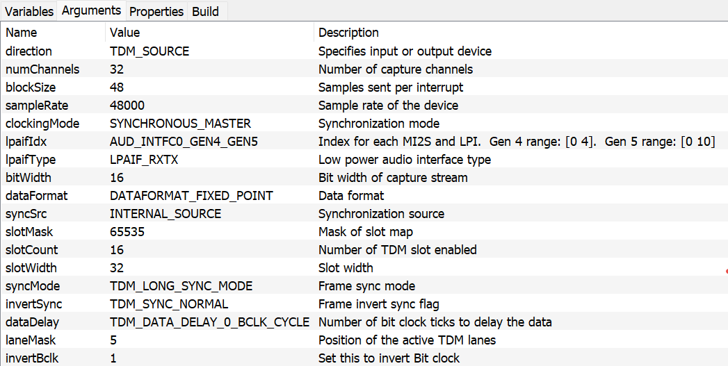

Module Arguments [R4.1]
The module has a large number of arguments.
direction - specifies whether this is a sink device (=0) or a source device (=1):
When configured as a TDM_SOURCE, the module has an audio output port (on the right), and a Timing Information port (TI) located on the top:
When configured as a TDM_SINK, the module has an input port on the left side and a Timing Information port (TI) located on the top:
numChannels, blockSize, and sampleRate - specify the properties of the TDM port. If this is an input module, then these values will also specify the properties of the output wire. If this is an output port, then the wire properties at the input must match these values. The sampleRate value is taken from a droplist:
clockingMode - specifies the clocking properties that was described above:
All other properties are taken directly from the AudioLite APIs and are used when opening the port. Here is a short explanation of the settings, more information can be found in Qualcomm documentation.
{lpaifIdx, lpaifType} - this pair of settings uniquely the port on the Snapdragon SOC. The lpaifType is only used in Gen 4 silicon and identifies different hardware subsystems on the SOC. For Gen 5 silicon, all TDM ports are included in the same hardware subsystem and this setting is ignored. lpaifIdx is the “port index” and specifies the port within a specific subsystem.
dataFormat - taken from AudioLite. You should only use “DATAFORMAT_FIXED_POINT”.
syncSrc - Specifies the source of the frame sync signal. Options include INTERNAL_SOURCE (generated by SoC as the clock master) or EXTERNAL_SOURCE (from an external clock input into the SoC).
slotMask - Bitmask specifying which active TDM slots to use. Each bit represents a time slot in the TDM frame. For example, 0x03 enables slots 0 and 1 (bits 0 and 1 set). This is an unsigned 32-bit value since a TDM port can have up to 32 slots.
slotCount - Total number of TDM slots in each frame. For example, set this to 2 for stereo data or 8 for 8 channel data. The number of bits in slotMask equals slotCount.
slotWidth - Width of each individual slot, in bits. Typical values are 8, 16, and 32. This controls slot packing and data padding.
syncMode - Specifies how the type of frame sync signal operates. Options are TDM_SHORT_SYNC_BIT_MODE (1-bit sync pulse) or TDM_LONG_SYNC_MODE (sync active for half of the full frame) or TDM_SHORT_SYNC_SLOT_MODE (sync active for the first slot of the full frame).
invertSync - Boolean setting to invert frame sync signal polarity. Used when the external codec expects opposite sync edge (e.g., active-low instead of active-high).
dataDelay - Number of bit clocks between the frame sync and valid data. Typical values are 0,1, or 2, affecting word alignment.
laneMask - Bitmask specifying which physical data lanes are active. E.g., 0x1 for lane 0 only, or 0x3 for lanes 0 and 1. Used in multichannel/multilane modes.
bitWidth - Total valid bit width per sample on the wire. Must be equal to or less than slotWidth.
invertBclk - Boolean setting to invert bit clock polarity.
A single TDM port can connect with multiple data lines. Each data line is called a “lane” and a port can have up to 8 individual lanes. The laneMask is a bit field that specifies which lane(s) (or data lines) are used by the port. The number of lanes equals the number of nonzero bits in the laneMask. Using more lanes increases the number of channels in the port.
Each data line / lane on a physical TDM port can be configured to be either an input or an output. In this mode, the input and output will share the same frame sync and bit clock, and the user must assure that the two ports are configured with matching parameters: bitWidth / slotCount / slotWidth / invertSync / dataDelay / syncMode / syncSrc / slotMask / dataFormat.
Each lane of a port has a total of slotCount channels in the TDM frame structure. slotMask is a bit field which specifies which of the slots will be used. The number of active slots equals the number of non-zero bits in the slotMask. For example, you can have slotCount = 32 and be connected to an A2B network. However if slotMask = 0xFF, you are only reading/writing 8 slots of the 32 available.
The total number of channels at the output (or input) of the port equals the numChannels argument. This must match (number of lanes) x (active slot count). This is checked within the Designer code and you will receive an error if this condition is not satisfied.
