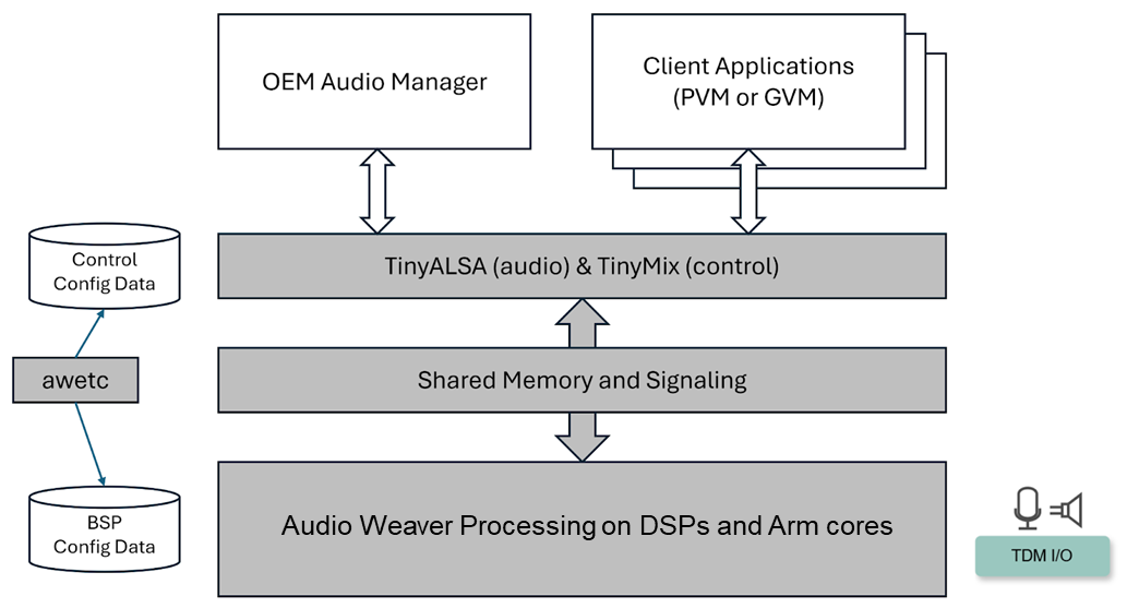

The high-level architecture is shown below. All of the client interactions with Audio Weaver are through TinyALSA (for real-time audio) and TinyMix (for control) plugins. Internally, Audio Weaver communicates with the plugins through shared memory and IPCC signaling. Additionally, there are configuration files generated through the Audio Weaver Target Configurator (awetc) application. One of the configuration files (awe_config.bin) is used to configure the audio processing cores and contains information such as heap sizes and number of threads. There is a second configuration file (awc_index.txt) containing information about tunable variables and ALSA devices.

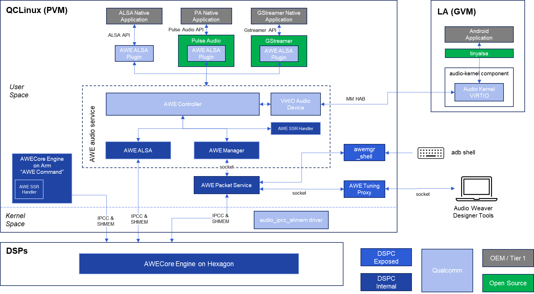

A more detailed view is shown below. This is to help you understand the inner workings but in reality there are only a few exposed and documented interface points for OEMs and Tier 1’s:
  • Audio APIs like ALSA, Pulse Audio, and GStreamer
  • TinyAlsa and TinyMix
  • awemgr_shell for command line control of the audio processing during development
  • AWE Tuning Proxy for connecting the Audio Weaver Designer tools
