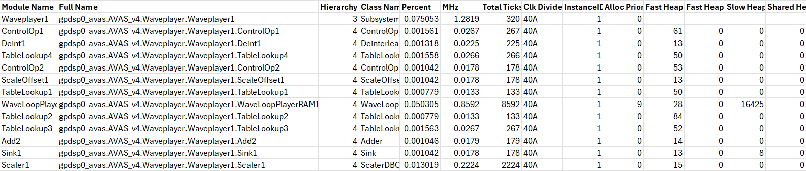

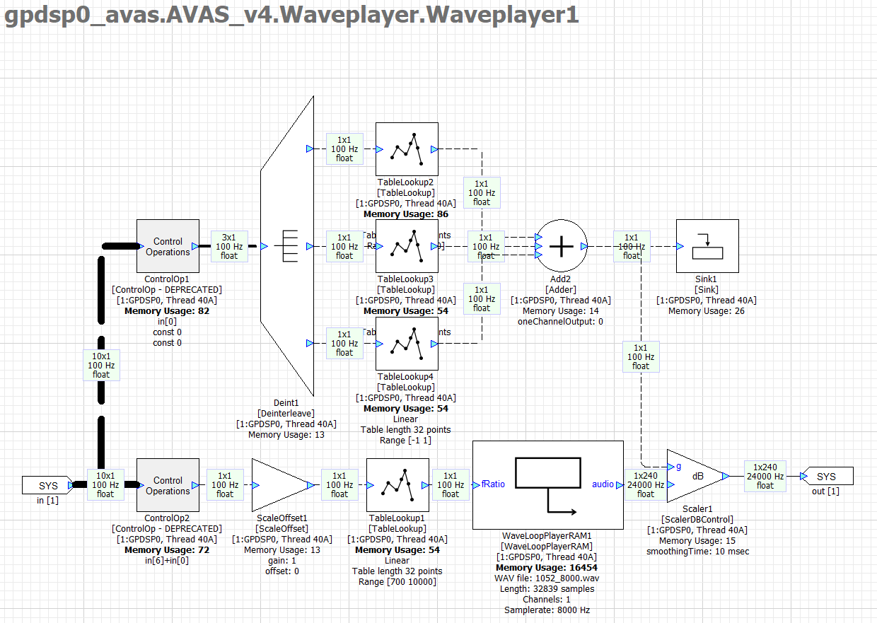

This measurement was performed on GPDSP0 on the 8255 ADP. The profiling was for a typical looping WAV player used in AVAS applications and all data is in RAM. This player has a variable playback rate and performs fractional sample interpolation. The output data was at 24 kHz and the subsystem for one wave player is shown below:
The total CPU load for this subsystem was 1.28 MHz (out of 1700 MHz). The detailed per module profiling is:

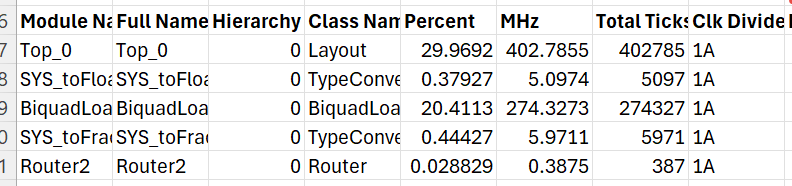

Single Threaded Processing
In this experiment, the system was doing audio I/O with TDM modules and using a BiquadLoading module to increase the CPU load. All processing was on the ADSP.

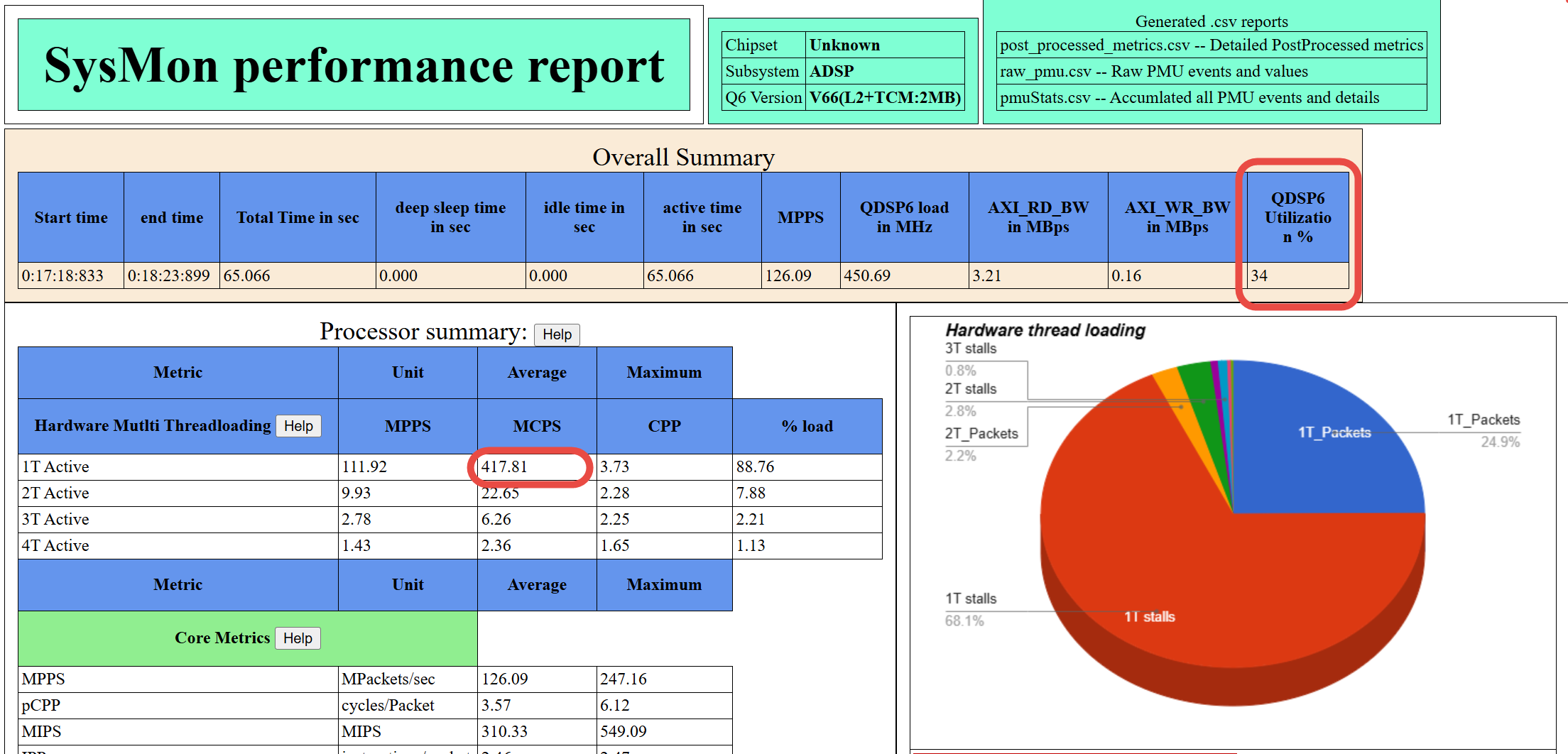

30% Loading in Audio Weaver
SysMon Profile
SysMon reports that the QDSP6 load was 34% and the average load for the 1T thread was 417.81 MHz. This matches closely what Audio Weaver reports.

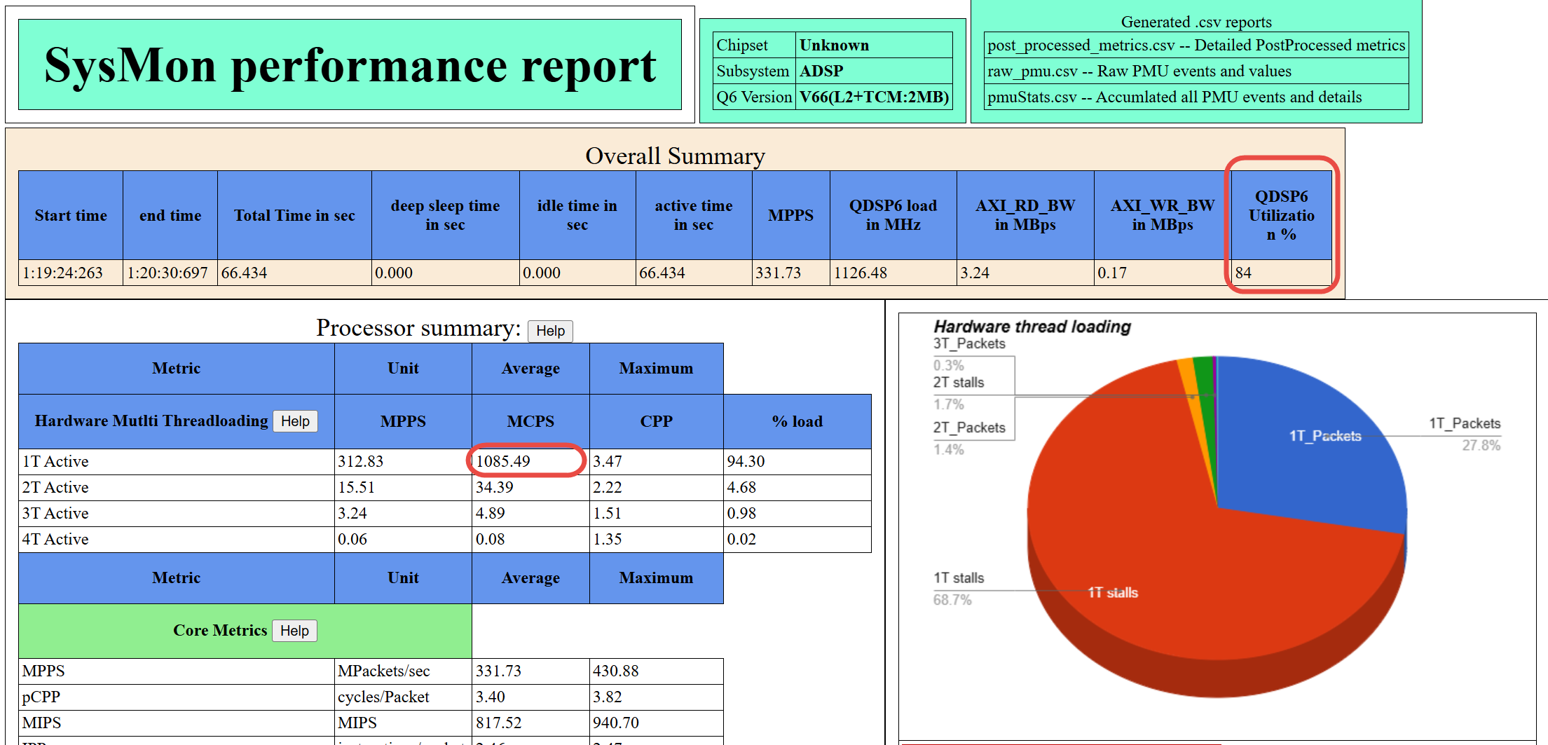

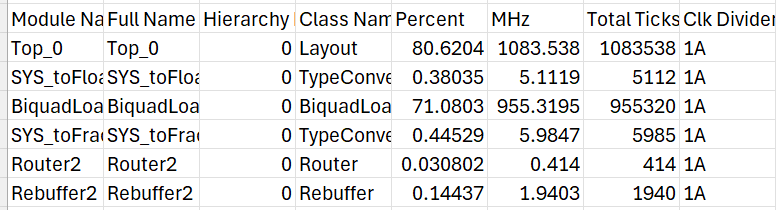

80% Loading in Audio Weaver
SysMon Profile
SysMon reports 84% total utilization with the average MCPS of 1085 MHz.

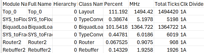

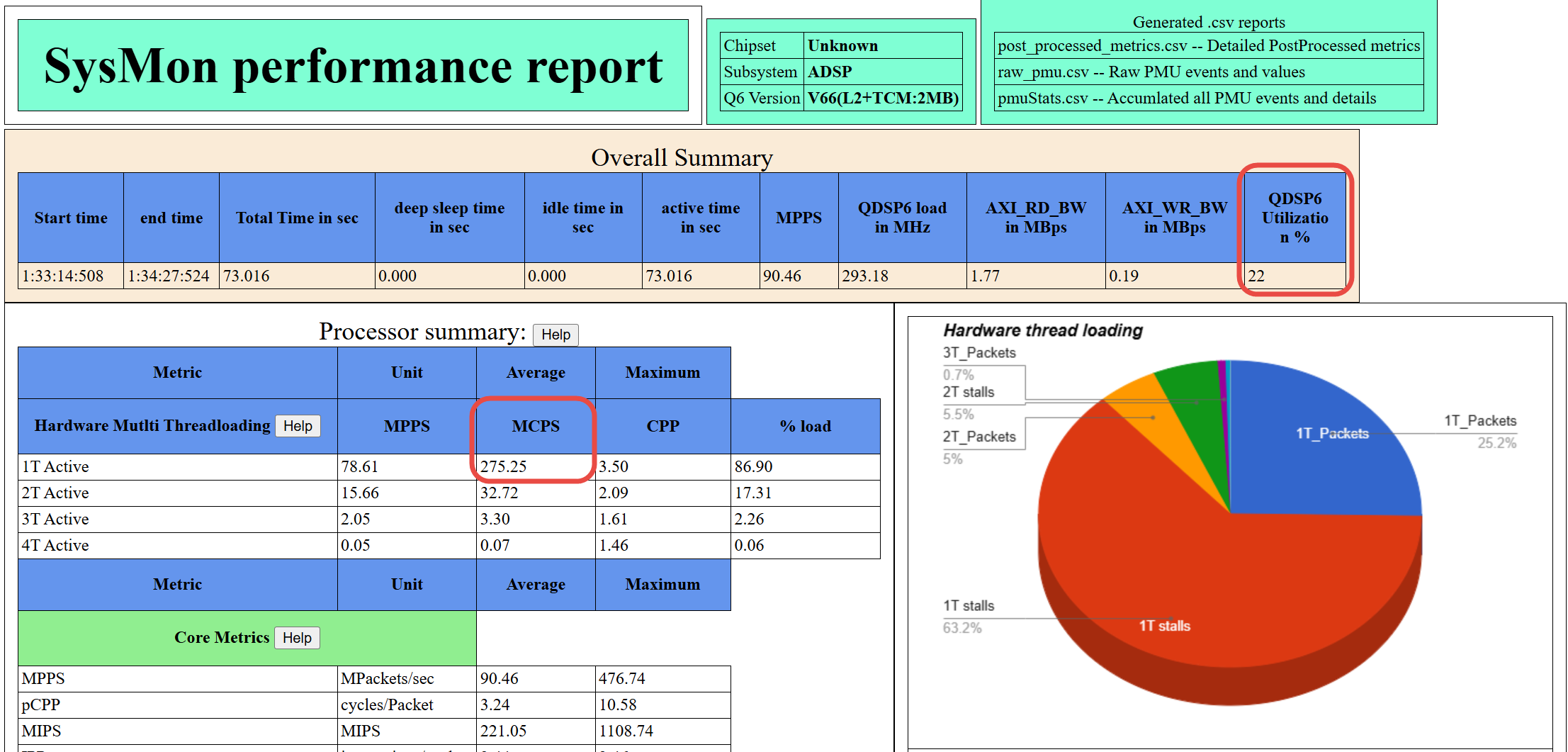

110% Loading in Audio Weaver
This is the overload scenario. Audio Weaver correctly captures the load, but behind the scenes it is stopping processing and attempting to restart.
SysMon Profile
The SysMon profile now only shows 22%. This is because of Audio Weaver’s resynchronization logic.
