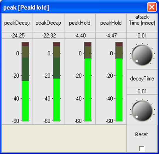

The next portion of the peak_hold_example_module.m file contains the inspector information. We only show the .peakHold variable since the others are similar or have already been discussed. The inspector drawn is:
![](../../__attachments/2748822349/image-20221228-185211.png?inst-v=afeb83b1-861e-46b8-b4de-1c642321bb7f)
This example has a stereo input. The first two meters shown are .peakDecay
for both channels. The second two meters show .peakHold
. The MATLAB code for drawing the .peakDecay
meters is:
M.peakDecay.guiInfo.transposeArray=1;
M.peakDecay.guiInfo.range=[-60 10];
M.peakDecay.guiInfo.controlType='meter';
M.peakDecay.guiInfo.attribStr='mapping=db20';
add_control(M, '.peakDecay', 'topRight');

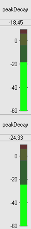

The .peakDecay
variable is defined in MATLAB as a column vector. In this case, since there are two input channels, the vector is of dimension 2x1. When the meter control is drawn, the default behavior is to draw it as 2 high and 1 wide (this matches the MATLAB variable size)
![](../../__attachments/2748822349/image-20221228-185304.png?inst-v=afeb83b1-861e-46b8-b4de-1c642321bb7f)
This is not what we want — we want the controls to be side by side. To achieve this, the array of values has to be transposed to form a row vector. The statement
achieves this. Next, the range of the control is set, the variable is tied to a meter control, and finally, the control is instructed to convert from linear measurements to dB for display. This completes the MATLAB code for the .peakDecay
inspector control. The .peakHold
inspector specification is almost identical.

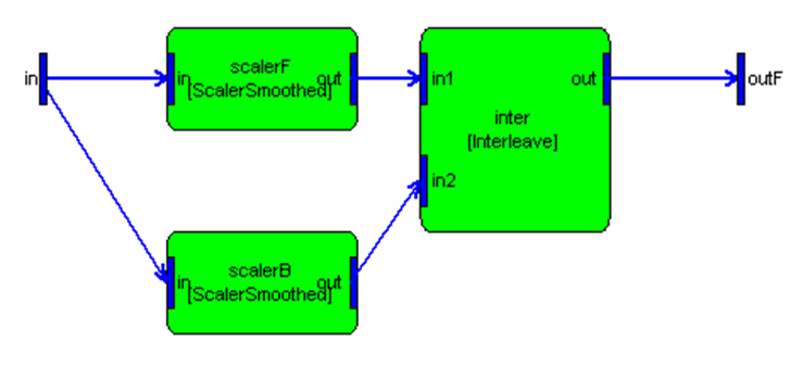

This example teaches how to create a new module class out of a subsystem and shows how to implement a custom bypass function. The fader module has a single mono input pin, a stereo output pin, and 3 internal modules:
![](../../__attachments/2748822349/image-20221228-190511.png?inst-v=afeb83b1-861e-46b8-b4de-1c642321bb7f)
The input signal is scaled by scalerF
to yield the front channel and by scalerB
to yield the back channel. The output pin is stereo with the first channel representing the front and the second channel the back. The scalers are set so that a portion of the input signal is fed to each of the front and back channels. The fader implements constant energy panning using a sine/cosine response.

Then add the modules to create the subsystem
add_module(SYS, scaler_smoothed_module('scalerF'));
add_module(SYS, scaler_smoothed_module('scalerB'));
add_module(SYS, interleave_module('inter', 2));
Then connect them together:
connect(SYS, '', 'scalerF');
connect(SYS, 'scalerF', 'inter.in1');
connect(SYS, '', 'scalerB');
connect(SYS, 'scalerB', 'inter.in2');
connect(SYS, 'inter', '');

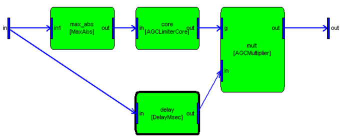

The compiled subsystem contains 4 internal modules:
![](../../__attachments/2748822349/image-20221228-191722.png?inst-v=afeb83b1-861e-46b8-b4de-1c642321bb7f)

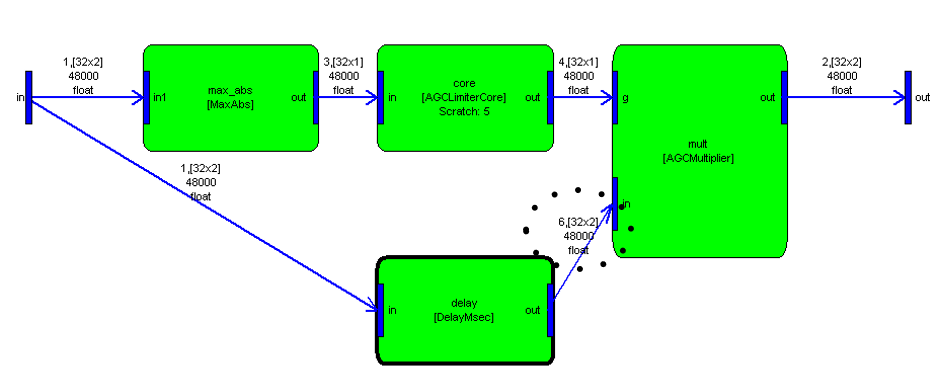

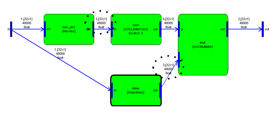

Disambiguating Wire Allocation
If look at the default subsystem including wiring information, we see:
![](../../__attachments/2748822349/image-20221228-192804.png?inst-v=afeb83b1-861e-46b8-b4de-1c642321bb7f)
By default, the input and output pins are mono and the system ends up using 3 scratch wires:
>> SYS=lah_limiter_example_module('LAH');
>> SYS=prebuild(SYS);
>> SYS.scratchPin
ans =
[1x1 struct] [1x1 struct] [1x1 struct]
This subsystem is designed to operate on an arbitrary number of channels. However, the wire allocation shown above is only applicable when the input is mono. (To see this, consider the MaxAbs module. This module always has a mono output and is assigned to wire #3. The signal path through DelayMsec can be N-channel and is also assigned to wire #3). If this system is run with stereo inputs, then the wire allocation is incorrect and the audio processing will fail.
To fix this problem, force the system input pin to have 2 channels by default.
pinType=SYS.max_abs.inputPin{1}.type;
SYS.inputPin{1}.type.numChannels=2;
The pin still holds an arbitrary number of channels, but its default value is 2. When the subsystem is now routed, the wires will be allocated as:
![](../../__attachments/2748822349/image-20221228-192822.png?inst-v=afeb83b1-861e-46b8-b4de-1c642321bb7f)
The system now requires a total of 4 scratch wires, with a new scratch wire, #6 assigned to the output of DelayMsec
. Furthermore, the buffer allocation is now general purpose and will work with any number of input channels.
