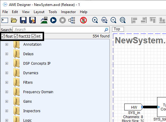

At the top of the module browser, there is a checkbox to filter based on the different module data types. (See below.). This will filter out modules for hardware that operates on specific sample data type (fract32 for fixed-point). The integer module libraries are typically used for control operations and work on both fixed-point and floating-point targets. The type convert module allows any data type to transfer into the others. This may be destructive if converting to a type with lower resolution.

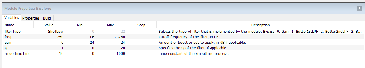

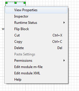

An audio module gets instantiated when dragged to the canvas from the Module Browser, located on the left hand side of the canvas. Module arguments can only be changed in Design mode and affect memory allocation, pins, and wiring. Module variables are tunable parameters which can be changed in either mode. Arguments tend to define memory allocation for the module, which can’t be changed during runtime. For example, in an FIR filter, the length of the filter (number of taps) is specified as an argument. This length affects memory allocation and as a result setting these arguments is only allowed in Design mode. The FIR coefficients (a variable) can change at any time.
After a module is instantiated, change its arguments and variables by right-clicking and selecting “View Properties.”

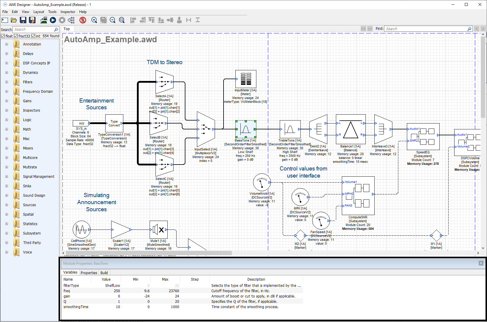

This opens up the Module Properties manager beneath the AWE Designer canvas:
![](../../__attachments/2748811096/Properties%20pane.png?inst-v=afeb83b1-861e-46b8-b4de-1c642321bb7f)
AWE Designer with Module Properties Manager Shown
![](../../__attachments/2748811096/Properties%20pane%202.png?inst-v=afeb83b1-861e-46b8-b4de-1c642321bb7f)
Module Properties Manager (Detail View)

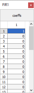

Most modules also have an associated Inspector. The inspector allows changing of the module’s tunable parameters. Inspectors can be used in Design mode and Tuning mode by double-clicking on a module, or by right-clicking and selecting “Inspector.” The inspector for an FIR filter holds the filter coefficients. (See below.) These parameters can also be changed under the “Variables” tab in the module properties window.

Within the properties window, in the variables tab, many modules will have range attributes, with an optional ‘step’ to determine adjustable resolution for the slider or knob control. The Max and Min values determine the allowable tuning range, and can be adjusted at any time.

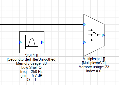

A useful design feature is to see variable values without having to open all of the inspectors. The original design appears as:
![](../../__attachments/2748811096/module%20variables%201.png?inst-v=afeb83b1-861e-46b8-b4de-1c642321bb7f)
To show variable values, select “Module Variables” under the View menu. With variables shown, it appears as:
![](../../__attachments/2748811096/module%20variables%202.png?inst-v=afeb83b1-861e-46b8-b4de-1c642321bb7f)

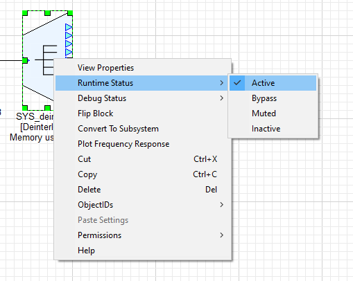

Changing the module status is useful for debugging and making simple changes to the processing at run-time. The module status can be changed in both Design mode and Tuning mode.
The Module Status can be changed by right-clicking on a module and selecting “Module Status \to→ ”. To change the module status of a group, select multiple modules(including subsystems) with drag and select or by pressing ctrl, and right-click to change the status of all selected modules.

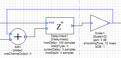

Feedback Wires
Feedback occurs when a wire is routed backwards to an input earlier in the system. Feedback wires must be manually specified.
The manual specification of feedback wires is a limitation of the way that Audio Weaver resolves wiring information. Recall that Audio Weaver starts at the input of the system and then propagates wire size information module-by-module. When it first reaches a feedback point, it will have not yet resolved the size information for that wire and cannot proceed further. As a result, wires must be manually marked as feedback.
To make a feedback wire, right click a wire and select “Feedback”. The wire will turn blue to indicate that it is a feedback wire. For each marked feedback wire, Audio Weaver will create a dedicated buffer to store its data. At system startup, data in the wire is initialized to all zeros.

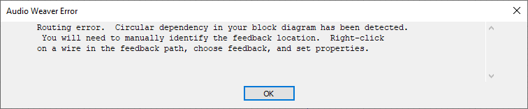

If a feedback wire is left unmarked, the following error will appear after an attempt to build the system:
![](../../__attachments/2748811096/image-20230105-181950.png?inst-v=afeb83b1-861e-46b8-b4de-1c642321bb7f)
To solve this, locate the feedback point in the block diagram and then mark the feedback wire.

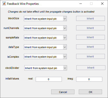

Wire size information must be set using the “Feedback Properties” dialog which is reached by right-clicking on the feedback wire. The following dialogue box opens, allowing the ability to set the wire’s block size, number of channels, sample rate, data type, and whether or not it is complex. This should match the pins that the wire is connecting.

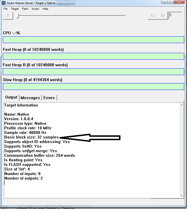

Each hardware target has a fundamental block size to specify how many samples per block are handled by the real-time audio I/O functions. This is shown on the Server window when the Server launches. (See below.)

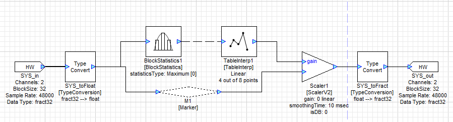

Interpolator and decimator modules increase or decrease the blockSize. Some modules also output a single value control signal (blockSize = 1). For example, the BlockStatistics module can be configured to output the average value of a block of samples. This data will be one value per block. Control signals are drawn with dashed lines instead of solid lines.
In the example below, the BlockStatistics1
module computes the RMS level of the signal and a lookup table (TableInterp1) turns this into a linear gain to be applied by Scaler1. The signals into and out of the lookup table module are control signals.
