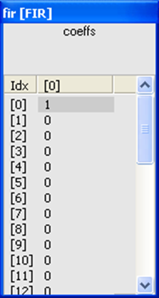

Each of the modules appears as a hyperlink, and clicking on an item provides detailed module specific help. The help provided is above and beyond the comments shown in the file header and accessed via the standard MATLAB “help” command. You can also obtain help for a specific module using the MATLAB command line. For example, to get help on the FIR filter module, type:
awe_help fir_module
Manipulating Parameters

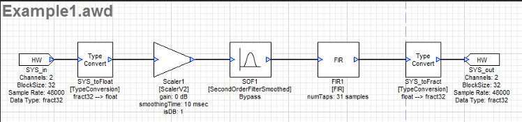

This returns a MATLAB data structure which contains the entire state of the Designer GUI. We won’t go into the details here; the only item of interest is the field .SYS which we call the system structure
GSYS.SYS
SYS_toFloat: [TypeConversion]
Scaler1: [ScalerV2]
FIR1: [FIR]
SYS_toFract: [TypeConversion]
The system structure contains one entry per module in the system. Looking more closely at Scaler1 we see all of the internal parameters of the module:
GSYS.SYS.Scaler1
gain: 0 [dB] // Gain in either linear or dB units.
smoothingTime: 10 [msec] // Time constant of the smoothing process.
isDB: 1 // Selects between linear (=0) and dB (=1) operation

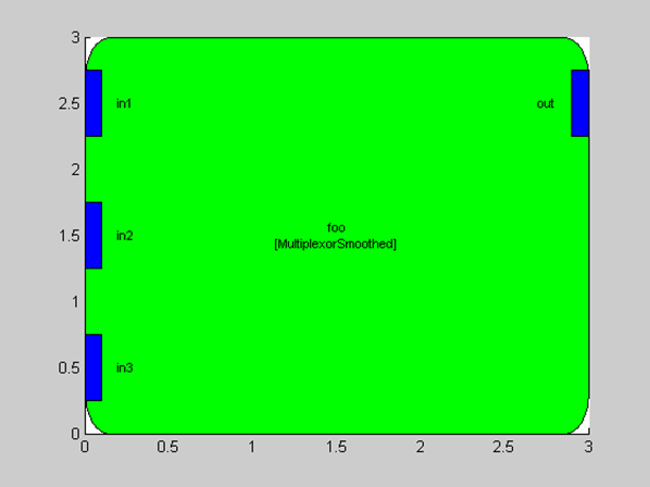

We begin by creating a single instance of a smoothly varying scaler module. This module scales a signal by a specified gain. The module is “smoothly varying” which means that the gain can be updated discontinuously and that the module performs internal sample-by-sample smoothing to prevent audio clicks. At the MATLAB command line type:
The module is created and assigned to the variable “M”. The module also has an internal name “foo” which will become important when the module is added to a system. The function “scaler_smoothed_module” is referred to as the “MATLAB constructor function” for this module. Examine the contents of the variable M by typing
M
at the MATLAB prompt. (This time we leave off the semicolon which causes MATLAB to display the result to the command line.) We see:
gain: 1 [linear] // Gain in linear units.
“foo” – the name of the module assigned when the module was created.
“ScalerSmoothed” – the underlying class name or type of the module. Modules of the same class share a common set of functions.
“Gain control with…” – this is a short description of the function of the module.
The next two lines list exposed interface variables that the module contains. A variable may display applicable units in brackets (e.g, [msec]) and have a short description.
The scaler_smoothed_module smoothly ramps the gain using a first order exponential smoother. The time constant of the smoothing operation is controlled by the variable "smoothingTime".
The module M is implemented using MATLAB’s object oriented programming techniques. The module corresponds to the class @awe_module. (This is not important to the novice user but for people familiar with MATLAB, it explains the underlying MATLAB implementation.)
You can treat the module M as if it were a standard MATLAB structure. You can get and set values using the “.” notation:

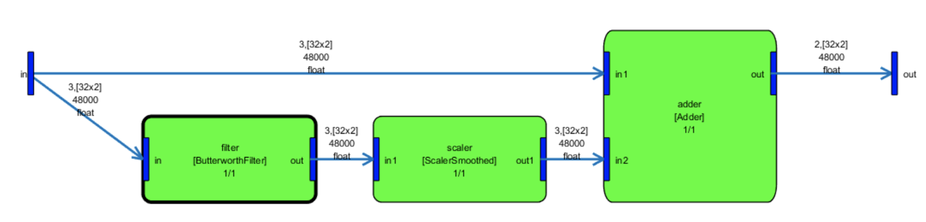

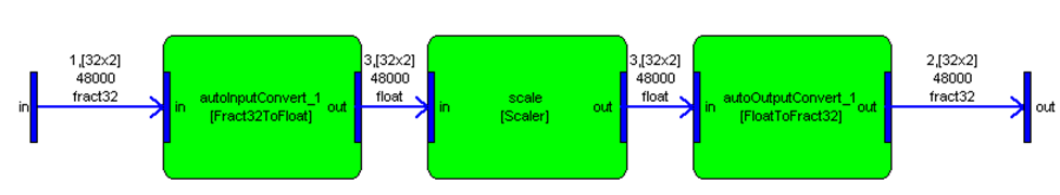

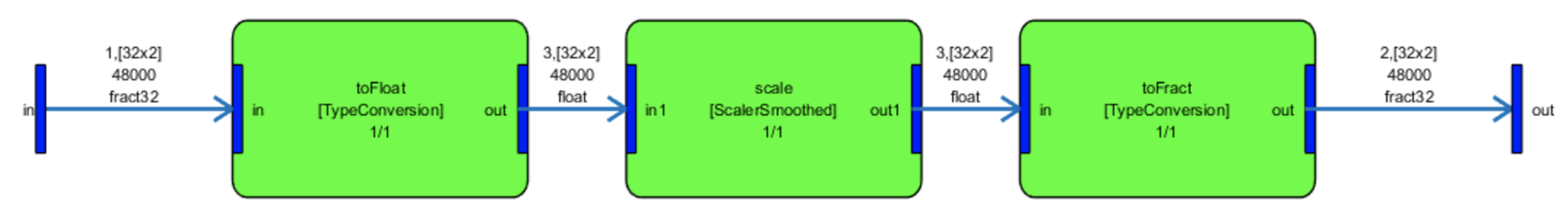

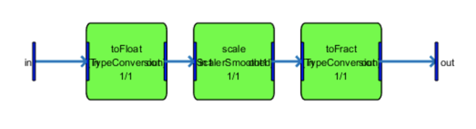

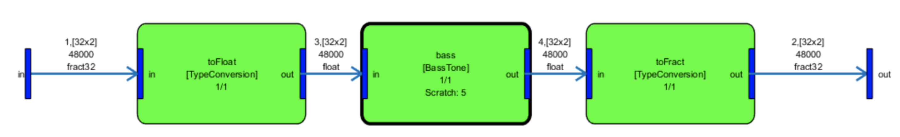

Audio Weaver also has rudimentary drawing capabilities. Execute the command
The input and output of the subsystem are represented by the narrow filled rectangles at the left and right edges of the figure. The modules are drawn as green rectangles and connections are represented by the lines with arrows. The draw command is useful for checking to make sure that the wiring of a subsystem is correct, especially complicated subsystems containing multiple modules.
The subsystem is now fully defined and ready to be run on the target. In this tutorial, we will run the subsystem natively on the PC. Issue the MATLAB command:
SYS=build(SYS);
The build command begins a long sequence of events needed to instantiate the system on the target. First, it runs a routing algorithm to determine the order in which to execute the modules and then it allocates input and output buffers called “wires” to hold the data. Next the individual modules are instantiated. When done, MATLAB will report the total amount of memory required to build the system
Fast Heap: 398 (10239602)
FastB Heap: 0 (10240000)
Slow Heap: 0 ( 4194304)
At this point, the system has been created in the Server. The only thing left to do is enable real-time audio flow. This can be done in two different ways. First, to use the line input to the sound card, use:
You'll need to attach an external source, such as a CD player or MP3 player, to the line or microphone input of your PC. Alternatively, to play audio from a stored audio file, use
Files can be specified with an absolute path, or a relative path, as shown above. Relative paths are addressed relative to the location of the AWE_Server executable. The command awe_server_command.m used above sends messages directly from MATLAB to the Server. The string passed is the actual message sent to the Server and you will see the string appear in the Server window.

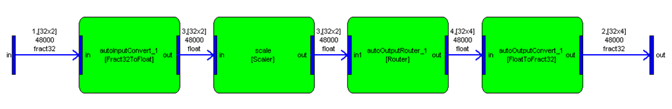

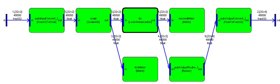

You can see the data types on the figure drawing by clicking on the toolbar button on the figure window.
sampleRate
dataType
where wireIndex is a unique integer identifying the wire. Wire indexes start at 1. blockSize and numChannels indicate the number of samples per block and the number of interleaved channels. In this case, we see that each wire contains two channels (stereo) with 32 samples per block. The sample rate is 48000 Hz. The data arrives as fract32, is converted to floating-point, processed by a floating-point scaler, and then converted back to fract32.
The process of determining the sizes of the pins and wires in the system is referred to as pin propogation. Essentially, the dimensions and sample rates of the input and output pins of the overall system are fixed by the target hardware. The pin information then flows from the input pins through the wires to the output of the system. At this point, we verify that the propagated output pin information matches the actual sizes of the output pins.

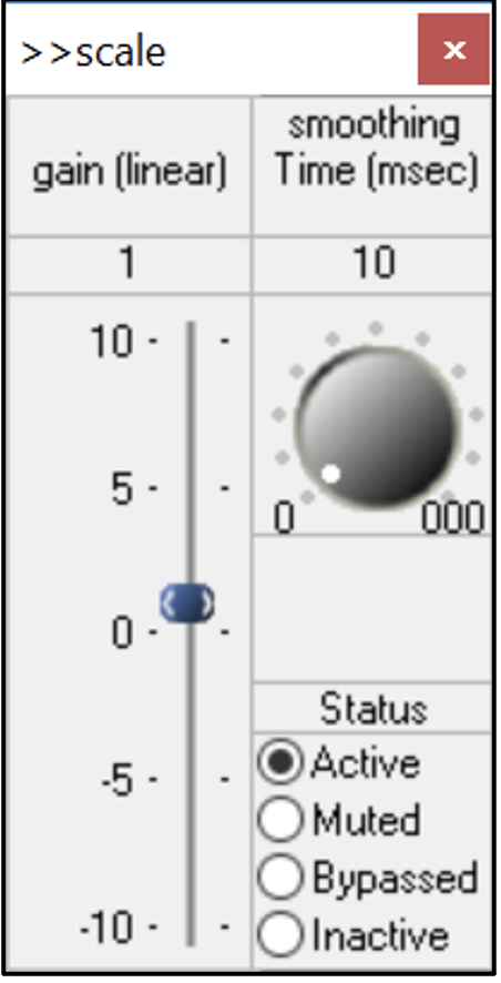

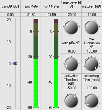

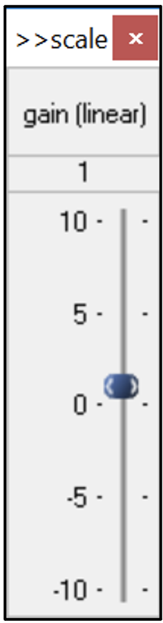

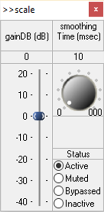

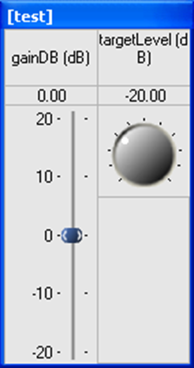

Audio Weaver also provides Server side user interfaces. To see the interface for the scaler, type
inspect(SYS.scale);
The following figure appears:

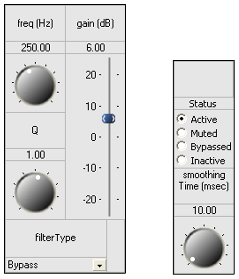

This interface is referred to as an inspector in Audio Weaver. They allow you to adjust parameters on the Server while audio is running in real-time. There are sliders for the tunable parameters: .gain and .smoothingTime. The Server is able to draw inspectors when creating systems using the MATLAB automation API and these inspectors are shown in this document. The inspectors drawn by the Designer GUI are slightly different but their functionality is equivalent.
Double-clicking on the title bar of the inspector reveals extended controls. (This feature is only available in Server drawn inspectors; not in the Designer GUI inspectors.) These controls are used infrequently and are hidden during normal use.
Note the control labeled "Status" found on the extended control panel. Each module has an associated run-time status with 4 possible values
Active – The module's processing function is being called. This is the default behavior when a module is first instantiated.
Bypassed – The module's processing function is not called. Instead, the module's input wires are copied directly to its output wires. An intelligent algorithm attempts to match up input and output wires of the same size.
Inactive – The module's processing function is not called and the output wire is untouched. This mode is used almost exclusively for debugging and the output wire is left in an indeterminate state. In this example, setting the module to Inactive will cause the contents of the output wire to be recycled resulting in a periodic 1.5 kHz whine.

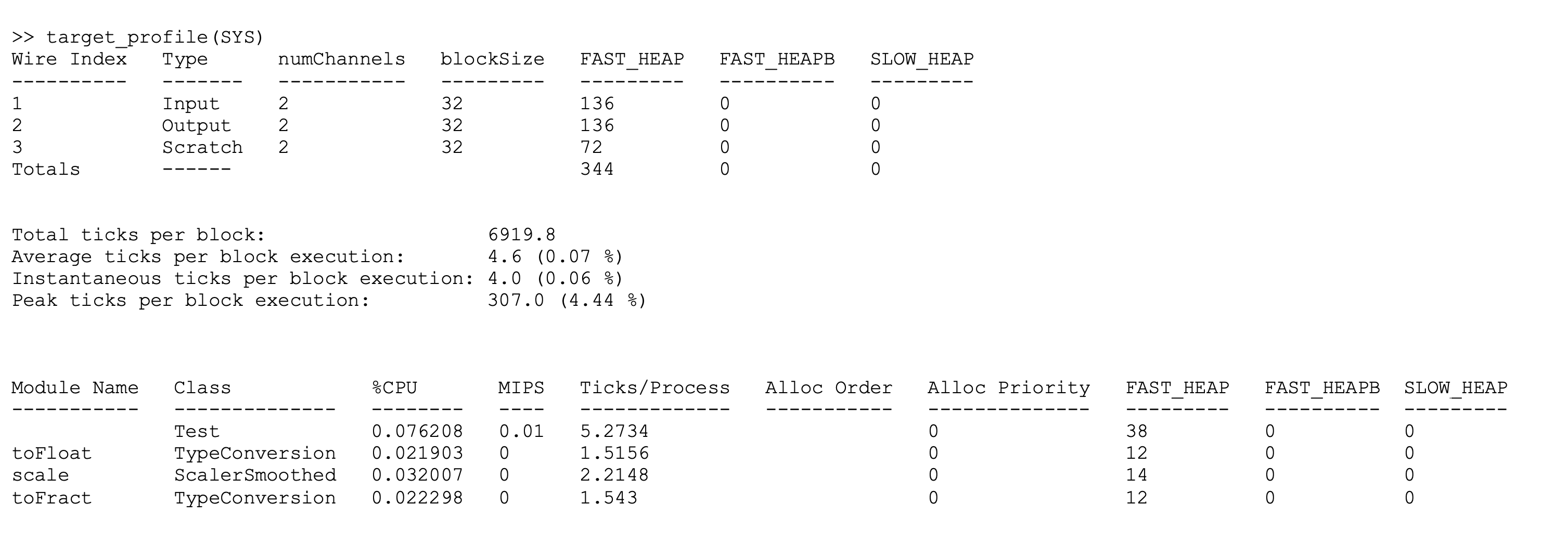

Several other useful features are available after a system is built. You can determine the MIPs and memory load of the algorithm by the command:
The profile indicates that the wire buffers require a total of 344 32-bit words and that the scaler module itself requires 14 32-bit words. The real-time processing load is about 0.07% of the CPU. The profile isn't that interesting for a such a small system but becomes important for complex systems.

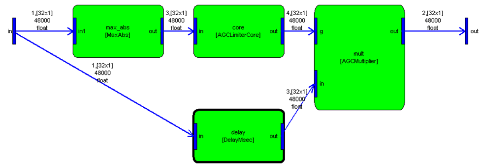

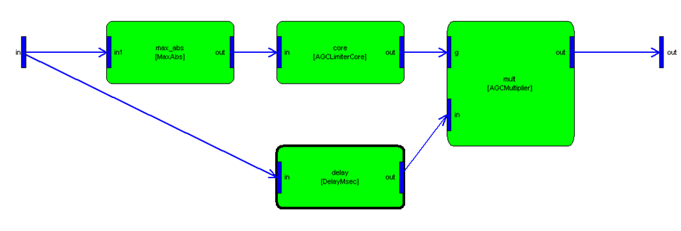

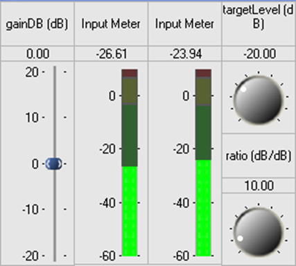

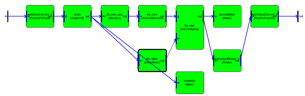

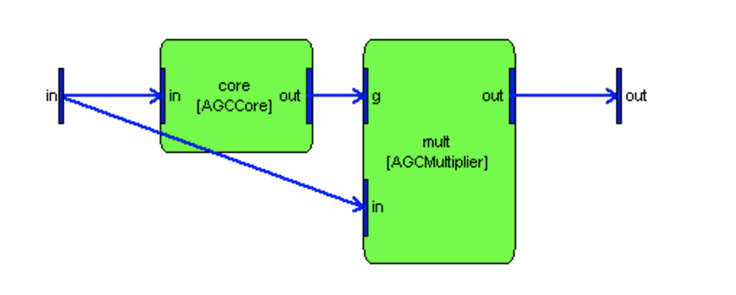

Automatic Gain Control
In this example an automatic gain control (AGC) normalizes the output playback level independent of the level of the input audio. In addition to the AGC, the system has a volume control and input and output meters.
T=target_get_info;
version: '1.0.0.5'
processorType: 'Native'
commBufferSize: 4105
maxNumCores: 8

where numIn and numOut may vary depending on which sound card is in use. Using T, we then add input and output pins to the system which match the sample rate of the sound card. Both pins are stereo and have a 64 sample block size.

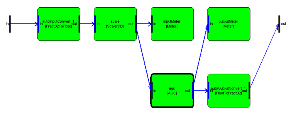

connect(SYS, '', 'toFloat');
connect(SYS, 'scale', 'agc');
connect(SYS, 'toFract', '');

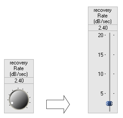

add_control(SYS, '.scale');
The .range field of the variable sets the range of the control slider or knob. The .size field controls its graphical size on the inspector.

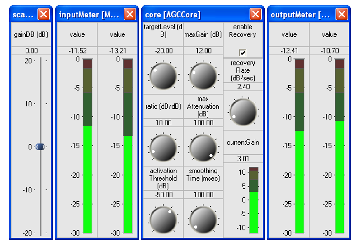

build(SYS);
inspect(SYS);
test_start_audio;
The script test_start_audio.m begins real-time audio playback. On the PC, an MP3 file is used as the audio source, and on an embedded processor, the line input is the source. The final system built is shown below:

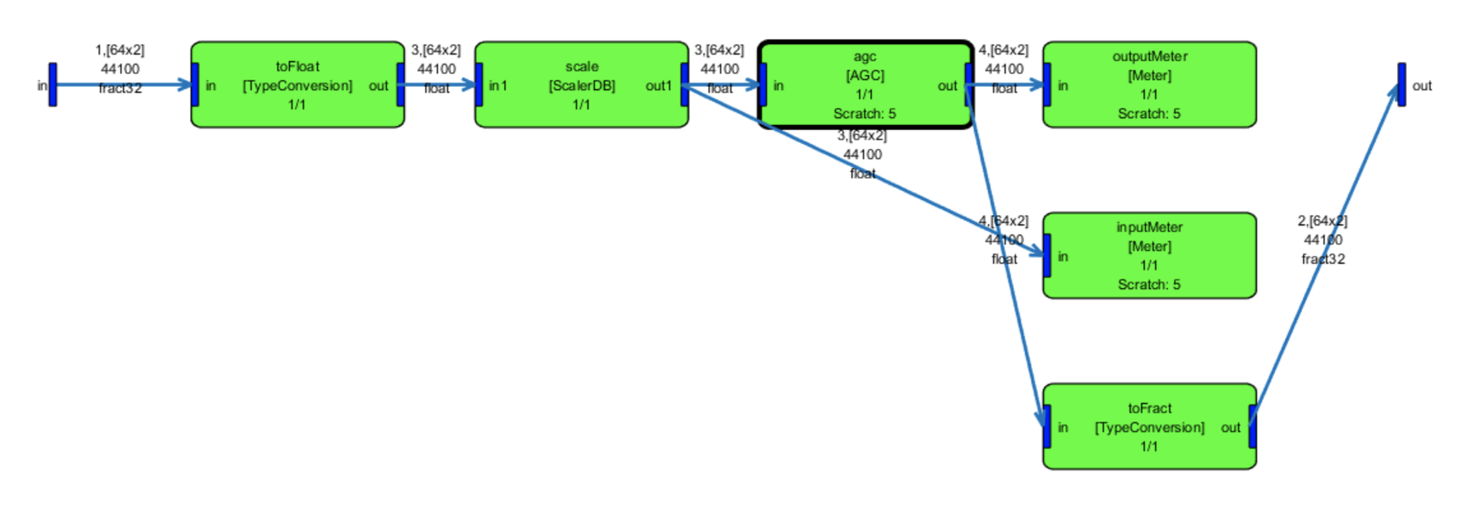

The AGC module is drawn in bold and is itself a subsystem. Peering inside, we see:

This example demonstrates how to use the second_order_filter_module.m to create bass and treble tone controls. The steps should start looking familiar. We create the overall system and then add input and output pins that match the target in terms of sample rate:
T=target_get_info;
We then add two instances of the second_order_filter_module.m in addition to the type conversion modules. This filter is a general purpose second order filter ("Biquad") with a large number of built-in design equations. The filters are named "bass" and "treble".
Configure the bass filter to be a low shelf. This filter is exactly what is needed for a bass tone control. Set the corner frequency of the shelf to 500 Hz. and the default gain to 0 dB.
SYS.bass.filterType=8;
SYS.bass.freq=500;
SYS.bass.gain=0;
SYS.treble.filterType=10;
SYS.treble.freq=3000;
SYS.treble.gain=0;
To connect all of the modules together.we use a special form of the connect.m command which allows us to make multiple connections with a single command. Start at the input of the system, go through the bass and treble modules, and then to the system output.
Add user interface information. We'll label the sliders "bass" and "treble" and set their ranges. Then add these controls to the master inspector panel.
SYS.bass.gain.range=[-12 12];
Finally build the system, draw the inspector, and start real-time audio playback. The awe_inspect('position', [0 0]) command specifies the screen coordinates where the inspector should be drawn. If not provided, the inspector is drawn to the right of the last inspector.
build(SYS);
inspect(SYS);
test_start_audio;

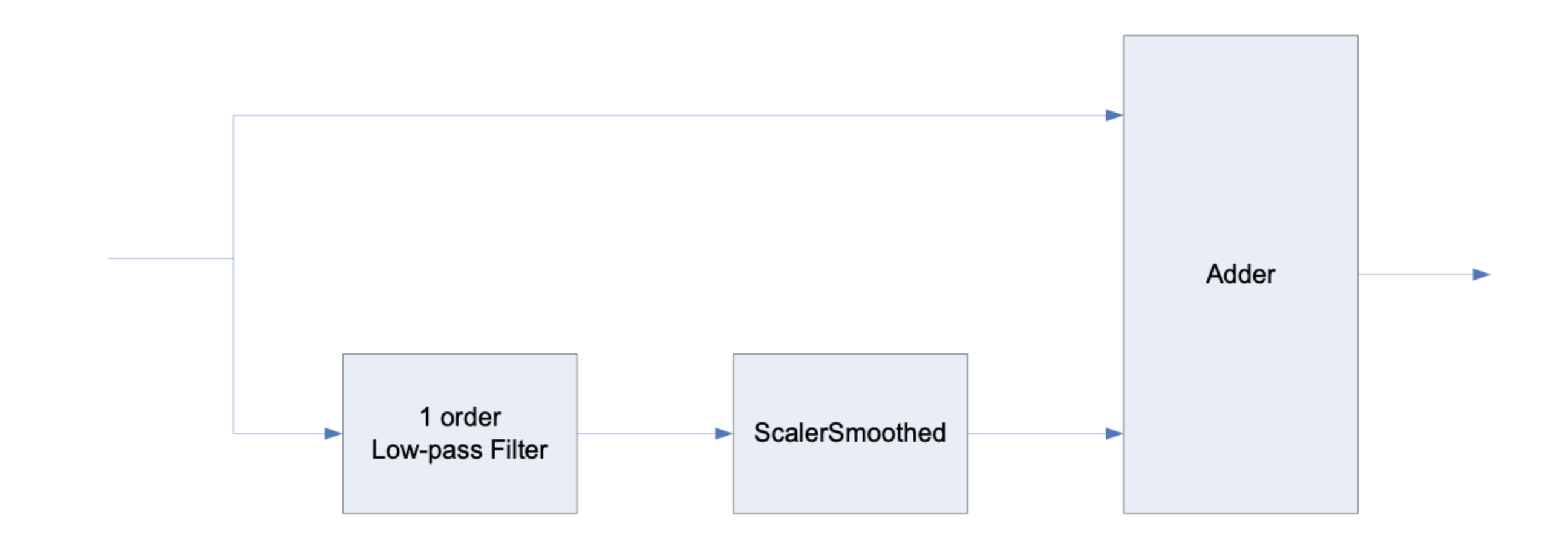

A diagram showing the overall tone control design is shown below. The design is quite simple. A first order lowpass filter is applied, scaled, and then added back to the input. When the scale equals 0 (in linear units), then the input signal is unchanged. Positive scale factors increase the amount of bass energy. Negative scale factors – up to a maximum of -1 – decrease the amount of bass energy.
Figure 1. Schematic diagram of the bass tone control system that will be constructed as a subsystem.
SYS.name=NAME;

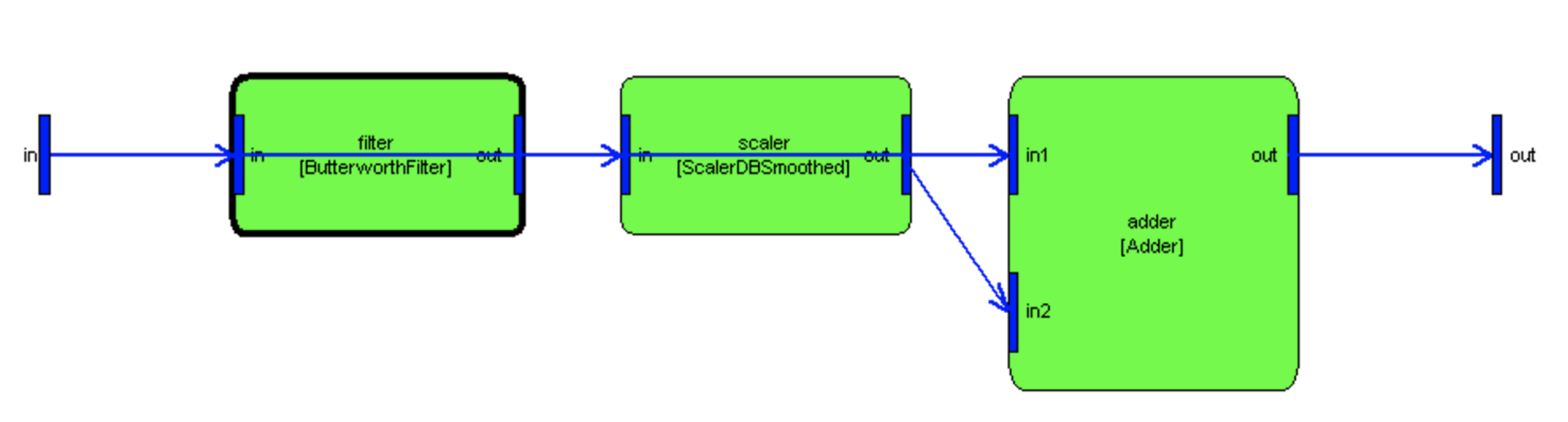

The first module is a first order Butterworth filter. The second module is a smoothly varying scaler that determines the amount of bass energy that is summed back in. The final module is a 2 input adder.
Next, we add input and output pins to the system. Note that no restrictions are placed on the block size, number of channels, or sample rate.
PT=new_pin_type;
connect(SYS, '', 'filter');

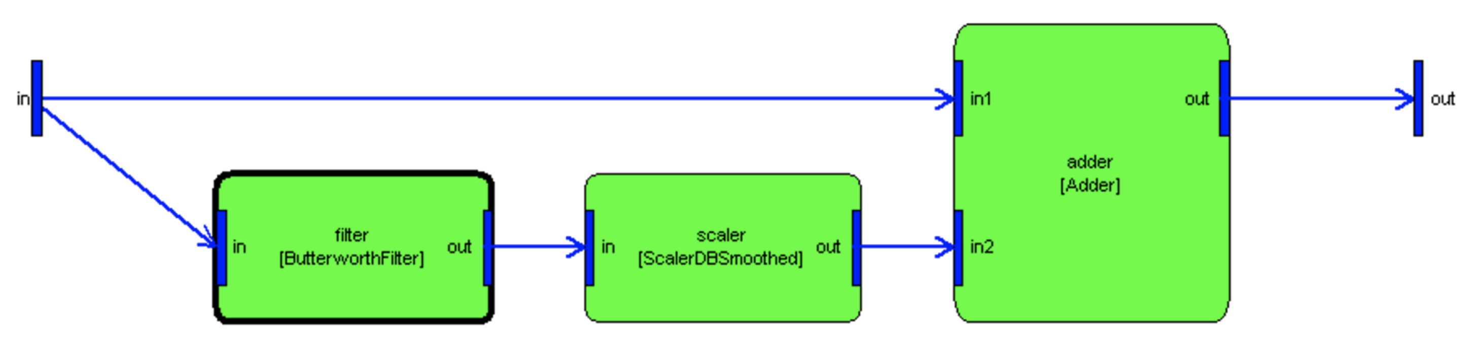

draw(SYS)
Figure 2. Bass tone control as drawn by Audio Weaver. Note that the input pin on the left has two connections: the first is to the filter and the second is to the top of the adder.
Audio Weaver isn't too smart about drawing figures. As can be seen there is some confusion because the wires overlap each other. We can nudge the adder module slightly higher in the figure with the statement:
We are almost done. The tone control still needs an adjustable gain setting. We will define a high-level interface variable “gain” as shown below:

If we draw the overall system, we see a little more information displayed. First, at the high-level:
Modules with dark borders, like the bass module, indicate a subsystem. You can look inside the subsystem by right-clicking and selecting "Navigate In" or "Open in New Window", or by using the MATLAB command:
draw(SYS.bass);

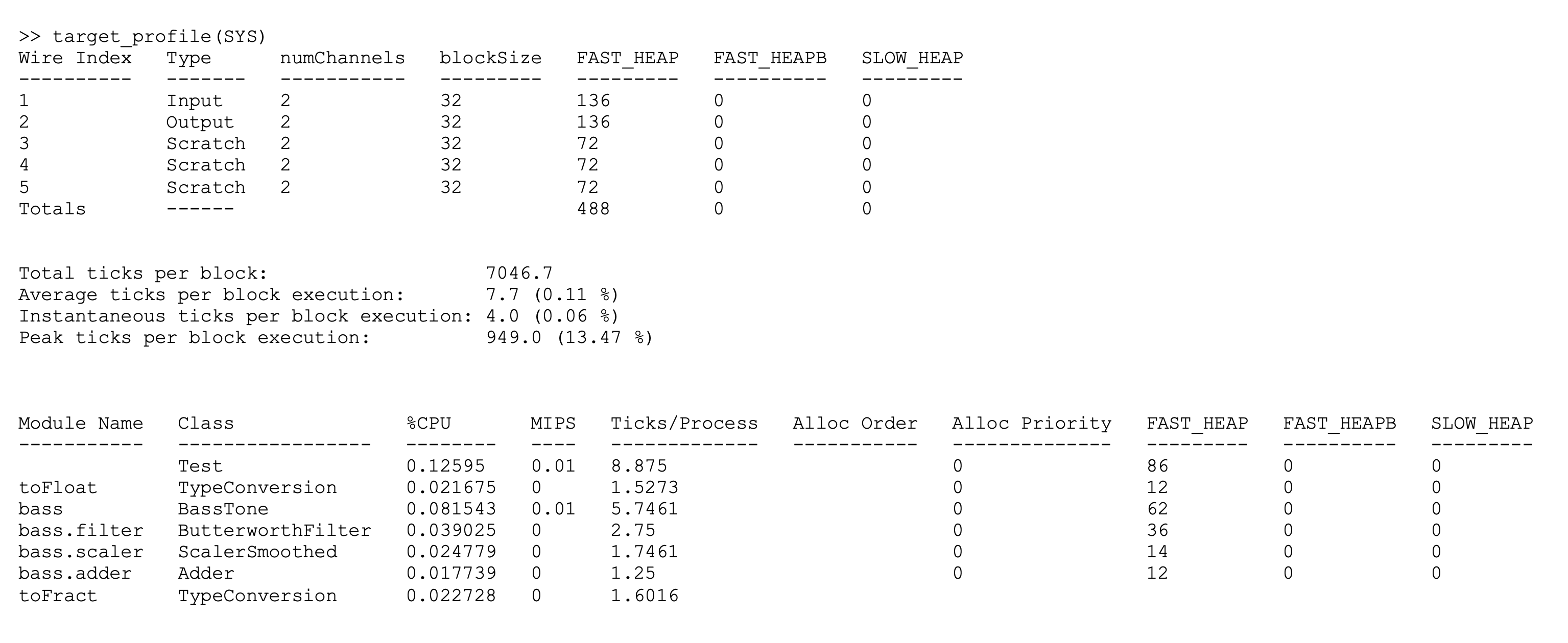

changes the low frequency gain to 6 dB. We can also obtain detailed profiling information:

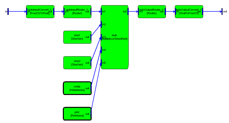

The module names "sine1" and "mult" are obvious because they were specified when the modules were created. The pins names may not be obvious since they appear within the module's constructor function. To determine the names of a module's pins, you can either utilize the detailed help function awe_help described in Online Help (recommended)
draw(M)
If the module has only a single input or output pin, then you need only specify the module name; the pin name is assumed. Since the sine wave generator module in the multiplexor example has only a single output pin, the example above reduces to:
Inputs and outputs to the subsystem are specified by the empty string. Thus,
connect(SYS, '', 'mult.in1');
connects the input of the system to the first input of the multiplexor. Similarly,
connect(SYS, 'mult', '');

Audio Weaver is setup to handle several special cases of connections at build time. First, if an input pin is unconnected, Audio Weaver will insert a source module and connect it to the unconnected input. Either a source_module.m (float) or source_fract32_module.m is added based on the first input to the system.
Note: Audio Weaver is guessing at the type of pin that needs to be connected.
sink_module.m Floating-point data
sink_fract32_module.m Fixed-point data
sink_int_module.m Integer data
Note: This is always correct since the pin type is inherited from the module's output pin.
If the subsystem has a direct connection from an input pin to an output pin, then a copier_module is inserted. If a module output fans out to N outputs of the subsystem, then N-1 copier modules are inserted.
Note: This is required since each output of the subsystem is stored in a separate buffer.

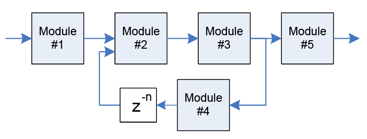

Determines the execution order of the modules in the system.
Propagates pin information starting from the input inputs, through all of the modules, to the output pins. This resolves pin sizes and sample rates.
Calls any prebuild functions associated with modules and subsystems. In some cases, this resolves array sizes.
Allocates wires buffers and scratch pins.

All Audio Weaver targets pass data in fract32 format to and from the audio processing. The system SYS has floating-point inputs and outputs. Audio Weaver automatically inserts format conversion modules to the system. Before being built, the system has a single module:
>> SYS
scale: [Scaler]
>> SYS
scale: [Scaler]
As expected, the fract32 input is converted to floating-point for processing by the scaler module. Then the floating-point result is converted to fract32 to match the target's output pin.
When disabled, building the above system will fail. You have to manually insert the type conversion modules yourself.
Audio Weaver also automatically matches the number of channels in your system to the number of channels supported by the physical hardware. If there is a mismatch, then router modules are automatically inserted.
Consider the scaler example again. The system has 2 input and 2 output channels. If the system is built on the Audio Weaver Demo Board, which has 2 inputs and 4 outputs, then there would be a mismatch at the output: 2 channels from SYS connected to 4 channels on the target. Audio Weaver automatically corrects this by inserting a router module. After building, the system will be:
>> SYS
scale: [Scaler]
autoOutputRouter_1: [Router]
Automatic matching of data types and number of channels is a new feature introduced in Audio Weaver 2.0. Along with this change, all target platforms were standardized to have a common fract32 data type. Automatic matching simplifies the overall process of building systems, especially on a floating-point target since the required type conversion modules are automatically inserted.
target_profile.m
target_profile(SYS, FORMAT)
Computes profiling information (processor and memory utilization) for a system running in Audio Weaver. Arguments:
FORMAT - an optional string that is passed to profile_display that controls the formatting of the output data. Refer to the function profile_display.m for an explanation on how to use this argument.
When called with no output arguments, the function displays detailed profiling information to the MATLAB output window. When called with an output argument:
SYS=target_profile(SYS)
SYS=agc_example;
This instantiates and builds the system SYS. Then, profile the system as:
target_profile(SYS)
Wire Index Type numChannels blockSize FAST_HEAP FAST_HEAPB SLOW_HEAP
1 Input 2 32 69 0 0
2 Output 2 32 69 0 0
3 Scratch 2 32 69 0 0
4 Scratch 1 32 37 0 0
5 Scratch 2 32 69 0 0
Totals ------ 313 0 0
Total ticks per block: 2330.7
Average ticks per block execution: 196.5 (8.43 %)
Peak ticks per block execution: 8029.0 (344.48 %)
Module Name Class %CPU Ticks/Process FAST_HEAP FAST_HEAPB SLOW_HEAP
test 4.3841 102.2572 106 0 0
.autoInputConvert_1 Fract32ToFloat 0.60327 14.1237 10 0 0
.scale ScalerDB 0.58582 13.6902 12 0 0
.inputMeter Meter 0.8056 18.2739 18 0 0
.agc AGC 1.172 26.6096 38 0 0
.agc.core AGCCore 0.65698 14.9027 27 0 0
.agc.mult AGCMultiplier 0.51497 11.7069 11 0 0
.outputMeter Meter 0.69979 15.9085 18 0 0
.autoOutputConvert_1 FloatToFract32 0.51764 13.6514 10 0 0
= test //
scale: [ScalerDB]
inputMeter: [Meter]
agc: [AGC]
outputMeter: [Meter]
The top section reports wire usage. The system requires a total of 6 wires and there is detailed size information for each wire. All together, the wires require 313 words of storage, and all words are 32-bit integers in Audio Weaver. The memory break down is per heap, and the wires are allocated within the memory heap named "FAST_HEAP".
The second half of the information pertains to the modules. The first line with the class name "test" is the overall system. Below is a break down by subsystem and by module. The overall system requires 4.3841% of the CPU, which in this case is a 263 MHz SHARC 21371 processor. The column "Ticks/Process" is target specific and indicates the average number of clock ticks needed to execute the function. On the SHARC, each clock tick represents 1 processor cycle, or about 3.8 nanoseconds. On the PC, each clock tick represents 100 nanoseconds. The clock tick measurements are smoothed in real-time by a first order IIR filter. The smoothing is roughly equivalent to averaging the tick counts over 100 calls to the processing function.
SYS=target_profile(SYS);
In this case, the profiling information is stored within the system structure SYS. The wire usage is contained within each of the input, output, and scratch pins. For example, to see the number of words used by the first wire in the system

'Bypassed' – the module's inputs are copied directly to its outputs. The generic version copies the ith input pin to the ith output pin. A module may also define a custom bypass function if the generic version is not appropriate. Refer to Custom Modules Developer's Guide for further details about custom bypass functions.
'Inactive' – Nothing happens. When inactive, a module's output buffers are unchanged. Be careful when using inactive mode because the contents of the output buffers is undefined and will be propagated to downstream modules. Inactive mode is used primarily for debugging. When a module is placed in inactive mode, you may hear a periodic squeal at the block rate. This occurs when the module's output buffer is not touched and the previous contents are continuously recycled.
Some modules allow you to modify the run-time status via the inspector. The status control appears as 4 radio buttons as shown below:
The run-time status can be changed during design time or in real-time. Note that changes occur instantly without smoothing, and audible clicks may result. To set a module's run-time status, use the command

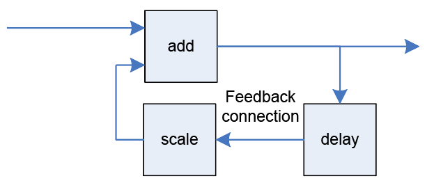

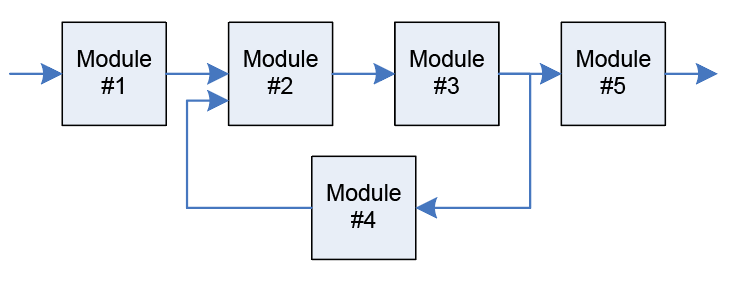

Audio Weaver also supports feedback on a block-by-block basis. The location of the feedback must be explicitly identified using a fourth argument to the connect function
By default, ISFEEDBACK=0 and a standard feedforward connection is made. Set ISFEEDBACK=1 to indicate feedback. See Feedback for a detailed discussion of using feedback within Audio Weaver systems.
The connection function performs rudimentary error checking when called. An optional fifth input argument performs more detailed checking:

When wire information is shown, each connection in the diagram is labeled with its wire index, block size, number of channels, and sample rate. The notation used is
sampleRate
dataType
The wire index identifies a wire within the subsystem. Wires are always indexed in the same manner: wire(s) attached to input pins (#1), wire(s) attached to output pins (#2), and intermediate scratch wires (#3, and #4). The wire indexes shown are local to the subsystem. That is, within every subsystem, the wires are indexed as input wires, output wires, and then scratch wires.
Some modules may utilize the same wire for both input and output. This "straight across" wire buffer allocation is specified within the module's constructor function. Further details are found in Custom Modules Developer's Guide (No modules in the limiter_example.m have straight across wiring).

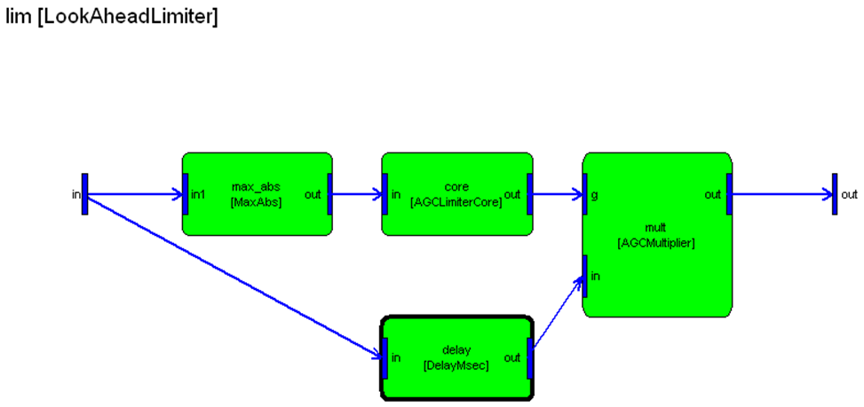

A subsystem drawing also gives insight into the execution order of the internal modules. The modules execute from left to right and top to bottom. For example, after the limter_example.m builds, the subsystem contains the modules:
>> SYS=limiter_example;
>> SYS
= test //
scale: [ScalerDB]
lim: [LookAheadLimiter]
firstMeter: [Meter]
secondMeter: [Meter]
The modules are executed in the order listed. First 'scale' executes, then 'lim', and so forth. Looking at the subsystem drawing, we see this same ordering enforced.
Audio Weaver tries its best to make legible drawings based on the order of execution of the modules. In some cases, the drawings are difficult to understand because of overlapping wires and modules. Consider the example below taken from echo_subsystem_example.m. The figure has a feedback wire – from the output of EchoHighCut to the first input of EchoFeedbackScaleAdd. Also, the output of the system is taken from EchoDelay. Both of these connections are not at all clear from the drawing.

Thus, we are connected to pin 1 on module 3 within the subsystem. Looking inside, we find:
>> SYS.module{3}
max_abs: [MaxAbs]
core: [AGCLimiterCore]
delay: [DelayMsec]
mult: [AGCMultiplier]
>> SYS.module{3}.inputPin{1}
ans =
type: [1x1 struct]
usage: 'input'
description: 'Audio Input'
referenceCount: 0
isFeedback: 0
coord: [NaN NaN]
wireIndex: 3
findconnectionsrc.m

The flatten.m function traverses a subsystem and searches for subsystems with virtual hierarchy. When a virtual subsystem is found, all of the modules in the subsystem are promoted one level to the upper system, reconnected, and finally the original virtual subsystem is deleted. This process repeats until all virtual subsystems have been flattened.
As an example, consider the subsystem created by the test script limiter_example shown in the Limiter Example Figure Drawing. The system shown is the one prior to flattening. The actual system running on the target is
draw(flatten(SYS))
What is happening here? Well, the limiter subsystem, SYS.lim, uses virtual hierarchy. The limiter contains the 4 modules shown below:
During the build process, all 4 of the modules comprising the limiter subsystem are promoted one level in the hierarchy and rewired. The delay module, lim_delay, however, is not flattened out. It uses full hierarchy and the target processor contains a module of class DelayMsec.
Examining the last figure closely, one sees that the names of the modules from the limiter subsystem have been mangled. That is, the names have been prepended with the name of the original subsystem. This can also be seen in the flattened system shown below:
>> flatten(SYS)
= test //
scale: [ScalerDB]
lim_max_abs: [MaxAbs]
lim_core: [AGCLimiterCore]
lim_delay: [DelayMsec]
lim_mult: [AGCMultiplier]
firstMeter: [Meter]
Typically, the user does not need to be concerned with flattening – it occurs automatically behind the scenes. The flattened system is hidden and the user continues to interact with the original hierarchical system. However, the flattened system is in fact instantiated on the target. The hierarchical system SYS maintains the mapping from the hierarchical system to the flattened system. Making a change to the hierarchical system causes a corresponding change in the flattened system. The mapping is maintained within the .targetInfo.mangledName field of each module. For example, the mangled name of the limiter core module on the target is:

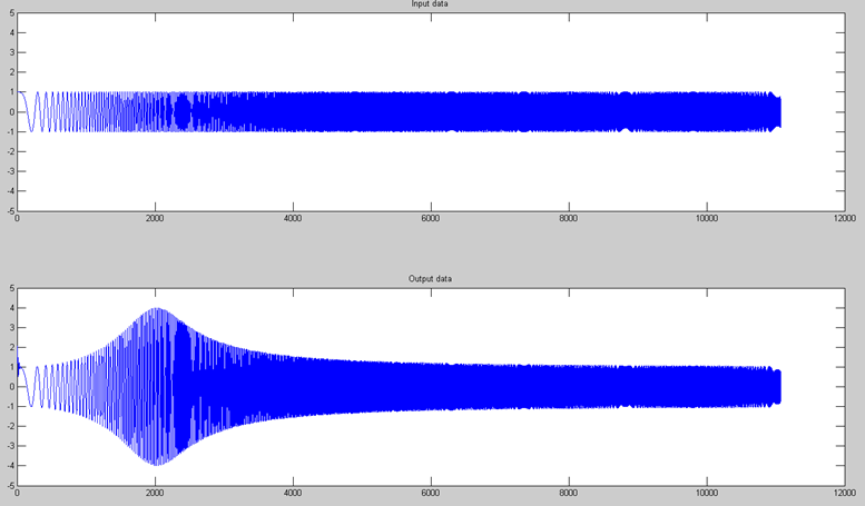

A linear chirp signal with duration 0.25 seconds is created in MATLAB. The length of the signal is rounded up to the nearest 64 sample block size.
duration=0.25;
L=SR*duration;
numBlocks=ceil(L/blockSize);
L=numBlocks*blockSize;
n=0:(L-1);
n=n(:);
T=n/SR;
WIRE_IN={x};
y=WIRE_OUT{1};
subplot(211);
plot(x);
set(gca,'YLim', [-5 5]);
title('Input data');
subplot(212);
plot(y);
title('Output data');
The resulting figure is shown below. The top subfigure shows the input to the system. Note that it has an amplitude of +/-1dB. The bottom subfigure shows the output of the system. Note that it has a peak gain of 4, which equals 12 dB, at 2kHz:
Example of the output generated by the process.m function. The top figure is the input signal, a linear chirp. The bottom figure is the output of the second order filter module. The filter is configured as a peaking filter centered at 2kHz.

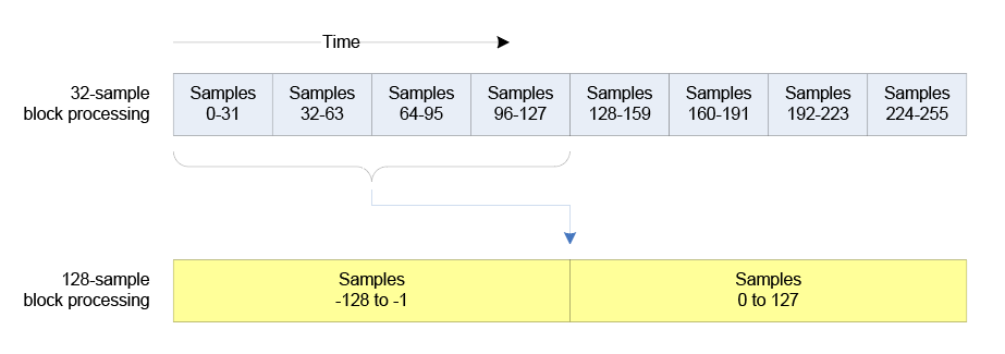

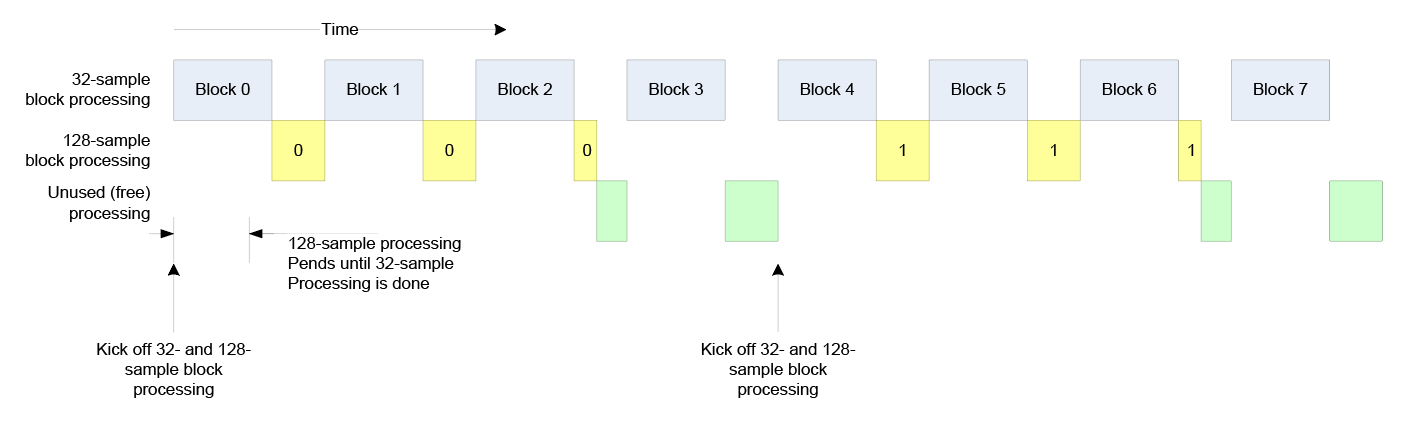

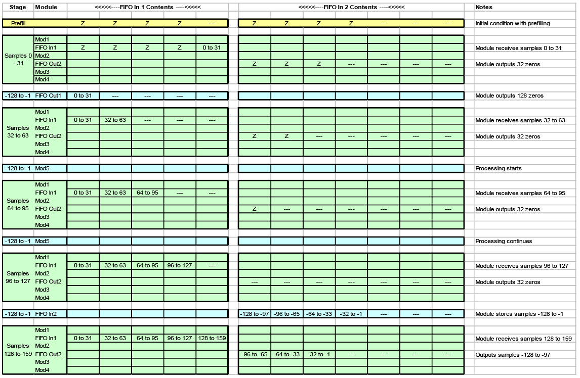

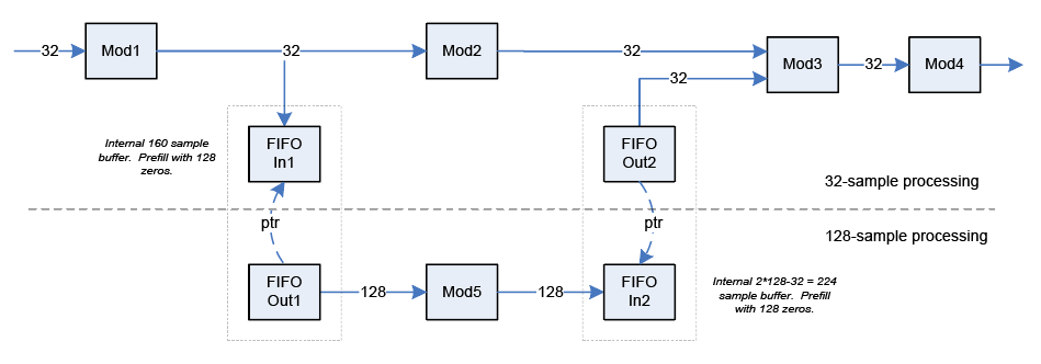

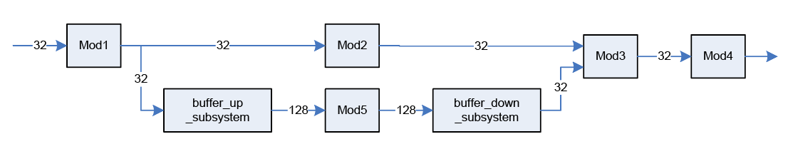

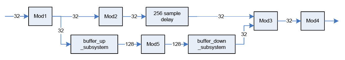

We now go into more detail to describe how multiple audio processing threads are implemented in Audio Weaver. The figure below shows processor activity when audio is processed in 32- and 128-sample blocks (1 msec and 4 msec).
The top line of blue blocks indicates when 32-sample audio processing is active. This happens at regular intervals and since this is the smallest block processing (and thus the highest priority), the 32-sample processing always runs to completion. The blocks are sequentially numbered from 0 to 7. The second line of yellow blocks indicates when the 128 sample block processing is active. Block 0 of the 128-sample processing actually starts at the same time as block 0 of the 32-sample processing. However, since the 32-sample block processing is higher priority, the 128-sample thread is suspended until the 32-sample processing is complete. Once the 32-sample processing is done, the 128-sample processing begins. Block 0 of the 128-sample processing takes some time to complete and during this time it is interrupted by the high priority 32-sample block processing. That is why block 0 of the 128-sample processing is divided into 3 different segments. Block 0 of the 128-sample processing completes and this leaves some unused processing shown in blue. The entire process repeats every 128 samples.
An important question to consider is which samples are available at each time slice for processing. This is illustrated below. The diagram has been slightly simplified to make it easier to follow. Although the 128-sample block processing is shown continuously processing, it is in fact interrupted by the 32-sample block processing.
The main thing to note is that there is a 128 sample delay between the 32- and the 128-sample block processing. This delay occurs because we have to wait until we have a complete 128-sample block before kicking off the processing. This delay requires buffering and Audio Weaver provides two subsystems which serve as interfaces between different sized block processing:
Internally, each subsystem contains a fifo_in_module.m and a fifo_out_module.m. These FIFO’s provide the buffering needed to connect the two clock domains. Expanding the subsystems we see:
The fifo_in_module copies data from its input pin to an internal circular buffer. The fifo_out_module has a pointer variable which is initialized (in buffer_up_subsystem.m) to point to the fifo_in_module.m. When the fifo_out_module.m is executed, it copies data from the fifo_in_module to its output pin. In the example above, the FIFO Out1 module copies data out in blocks of 128 samples while the FIFO Out2 module copies data out in 32-sample blocks. Each fifo_in_module is also pre-filled with a number of zero samples.

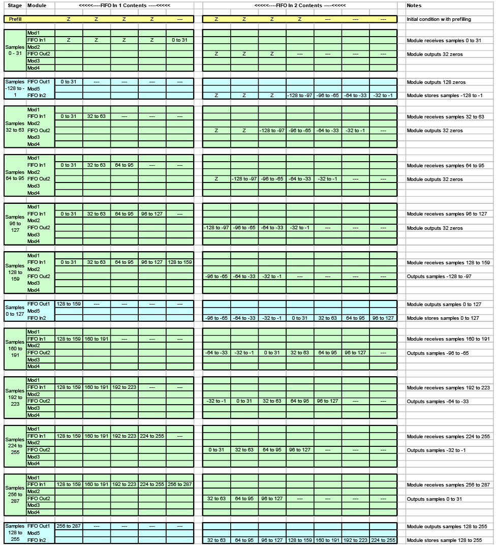

Let’s look closely at the behavior of this system. The execution order for modules in the 32-sample domain is:
FIFO Out1, Mod5, FIFO In2
The figure below shows how the processing progresses block-by-block. The focus is on what data is contained within each FIFO buffer. The data enters the FIFO on the right hand side and then exits on the left hand side. Each cell corresponds to 32-samples. “Z” indicates that the cell has been prefilled with zeros. “---“ indicates that there is no data in the cell. That is, the FIFO is not full. And finally, numbers in a cell indicate specific sample indices. Negative values refer to numbers from the previous block. The yellow blocks correspond to the initial prefilling. The green blocks correspond to the 32 sample processing and the blue blocks correspond to the 128 sample processing.
It can be seen that prefilling is important because some of the fifo_out_module’s are asked to output data before the input is available. You can also ascertain where the buffer sizes came from. Each FIFO buffer becomes full sometime during the processing cycle. And finally, keep an eye on the 0 to 31 block of input samples. It takes quite a bit of time to work its way through the system. It is not until the final set of green boxes that the 0 to 31 samples are output. In fact, the latency through the two buffering stages is exactly 128 samples; twice the larger block size. This relationship holds for other block sizes as well.
There are certain assumptions built into the figure below. First, the example assumes that all of the 128 sample block processing completes before the second block of 32-samples is processed. This is not a hard requirement since large block processing is only useful if the processing can extend over multiple smaller 32-sample blocks.
Time evolution of the FIFO buffers when 32- and 128-sample block sizes are mixed. This shows the case when the 128-sample processing completes before the next block of 32-samples is processed.
The below figure shows how the processing evolves if the 128 sample block size processing takes much longer to complete. You’ll note that the data in FIFO In2 arrives just in time to fullfill the request to output 32-samples. The overall latency remains at 256 samples.
Time evolution of the FIFO buffers when 32- and 128-sample block sizes are mixed. This shows the case when the 128-sample processing takes a long time and completes just before the 4th block of 32-samples is processed.

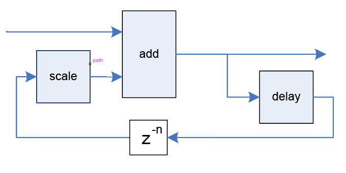

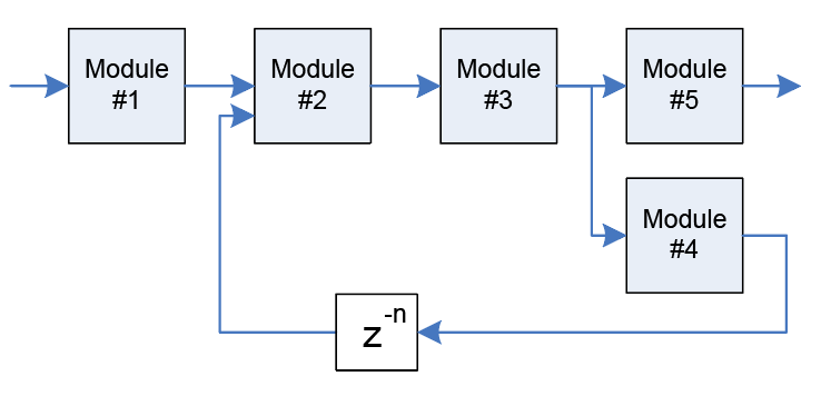

Feedback
Feedback is a key building block for audio algorithms and is frequently used in reverberation and dynamics processors. There are a number of issues to keep in mind when using feedback in Audio Weaver. This section describes how to add feedback to a system and gives a complete example of a subsystem incorporating feedback.
Most connections in Audio Weaver are feedforward. That is, the output of a module (or the input of the subsystem) serves as input for subsequent modules. Audio data flows from left to right in the signal flow diagram.

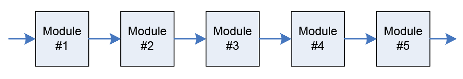

Feedback occurs when an audio signal travels from right to left in the signal flow diagram. The output of a module serves as input to an earlier occuring module in the system.
Systems with feedback can only be realized when there is a delay in the feedback path. Audio Weaver automatically inserts the delay for you, and the delay occurs on a block-by-block basis. If you need less delay you'll need to reduce the block size of the system.
Point-to-point connections in Audio Weaver are specified via the connect.m function described in connect.m The connect.m command has an optional fourth argument which is used to indicate feedback.
When you make a feedback connection, you explicitly identify the location at which the feedback and the associated delay occur. Recall that connections between modules correspond to buffers of data. The routing algorithm allocates buffers as needed and attempts to reuse buffers whenever possible in order to conserve memory. When feedback occurs, a new wire buffer is allocated and never reused. This wire buffer holds the delayed data and implements the delay of 1 block.
The location of the feedback connection affects the behavior of the system. For example, suppose that the feedback connection in the previous diagram occurs between modules 4 and 2. Then the delay will be inserted at that location:
where n = blockSize. Note that the delay occurs as a result of the buffer management. A delay module is not inserted at this location. The modules in the subsystem will execute in the following order:
Module #1
Module #2
Module #3
Module #4
Module #5

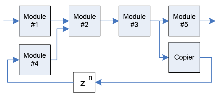

Alternatively, suppose that the feedback occurs between modules 3 and 4. Module 3 will then have both a feedforward and a feedback connection. If a feedback buffer is allocated for the output of module 3, then the input to module 5 will also be delayed – but this is not the desired behavior. To deal with this special case topology, Audio Weaver automatically inserts a copier module into the system at the output of module 3. The feedback connection is isolated from the feedfoward connection by the copier. The system is then as shown below:
Resulting signal flow when the feedback point is specified between module 3 and module 4. A copier module is automatically inserted to isolate the feedfoward and feedback connections at the output of module 3.
Module #1
Module #4
Module #2
Module #3
Module #5

Feedback Delay System

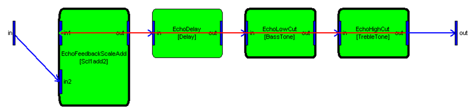

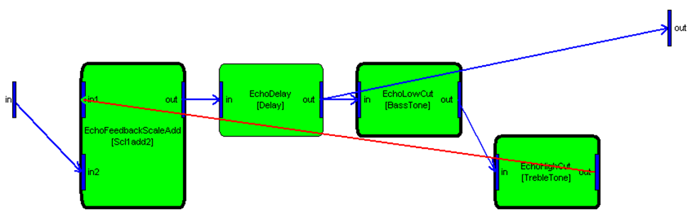

An example of how feedback is used in practice is contained in the file feedback_delay_subsystem.m. This subsystem realizes the system shown below:
Portions of the MATLAB source file are shown below. Feedback connection is made with connect(SYS, 'delay', 'scale', 1); and feedback Pin Type is set with feedbackPinType.isComplex = -1;.
% Set default input arguments
if (nargin < 2)
MAXDELAY=1024;
% Creates the subsystem
SYS.name=NAME;
% Add the modules
% Add input and output pins
pinType=new_pin_type;
connect(SYS, '', 'add.in1');
connect(SYS, 'add', '');
connect(SYS, 'add', 'delay');
SYS.scale.gain=0.8;
% Add the GUI
return;

Audio Weaver allows you to design custom user interfaces for audio modules and subsystems. The user interfaces are designed by MATLAB commands and translated into Audio Weaver script. The user interfaces created are drawn by the Audio Weaver Server and exist outside of the MATLAB environment. This section begins with a brief tutorial that demonstrates how to use existing user interfaces and to create interfaces for a custom subsystem.
Quick Tutorial

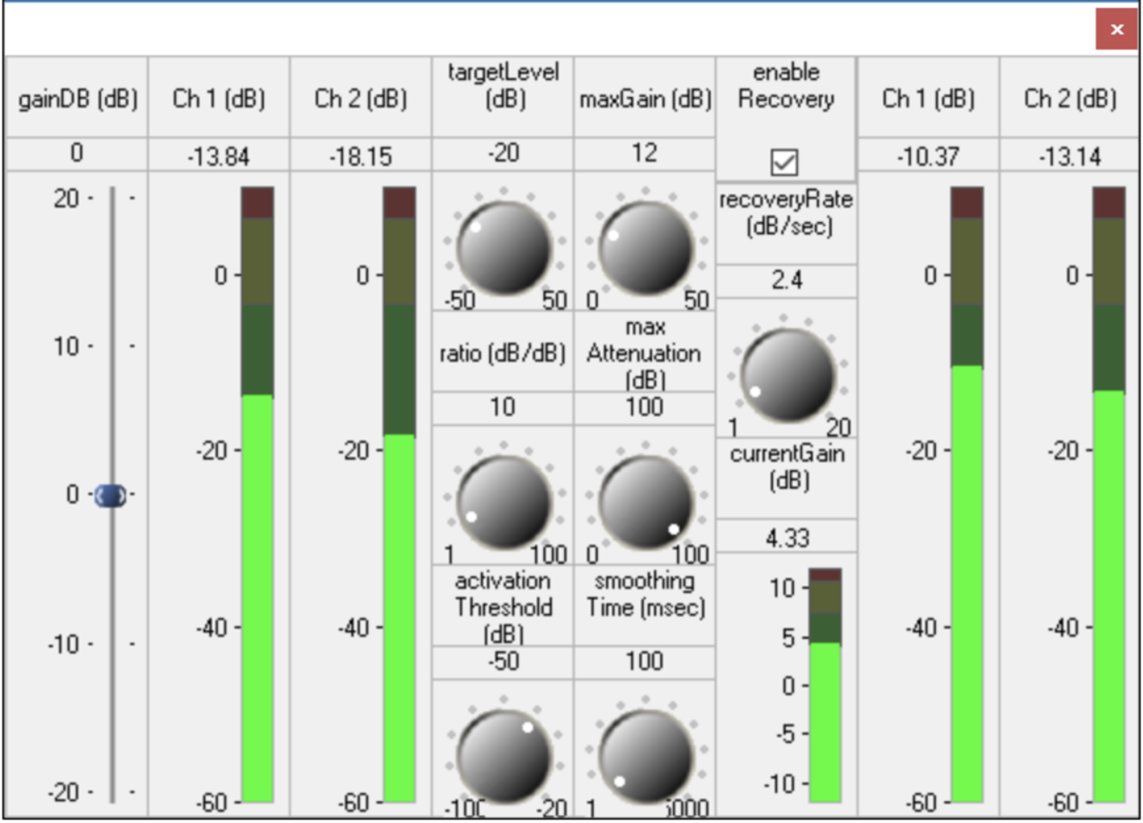

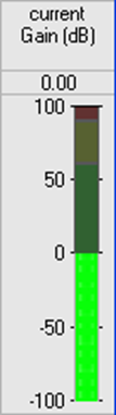

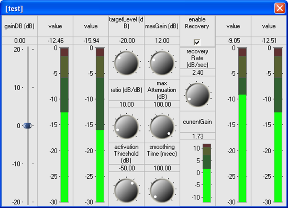

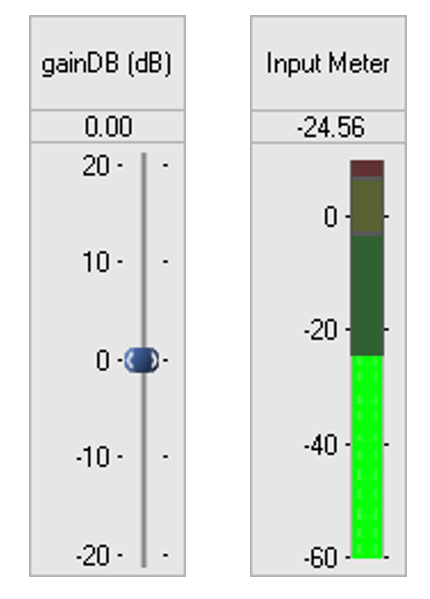

Run the example system agc_example.m. The script instantiates the system shown below and begins real-time execution.
The script also draws the user interfaces, called inspectors, shown here:
These commands specify the ranges of controls and their sizes on the inspector panels. The commands to draw the inspectors are:
inspect(SYS.scale);
inspect(SYS.inputMeter);
inspect(SYS.agc.core);
inspect(SYS.outputMeter);
The first command, awe_inspect('position', [0 0]), specifies the screen position at which to draw the first inspector. The remaining 4 commands draw an inspector for each of the 4 internal modules. The inspectors are positioned from left to right (and the order of inspector drawing was purposefully chosen to mimic the audio signal flow in the subsystem.)
If you double-click on the title bar of a window, the inspector dialog may increase in size revealing additional "extended controls". For example, the scalerDB module reveals two more controls:
Using Controls
Clicking on a slider advances the control part way.
Grabbing and moving a slider updates the variable continuously.
An edit box directly above a slider or knob shows the current value. Clicking on an edit box allows you to type in a value.
Left clicking on a knob instantly turns the knob so that it is positioned over the click location.
Turn a knob by left clicking, and holding, a point on the knob. While you are actively turning a knob, you can increase the turn radius to more precisely adjust the value.
Knobs can wrap around from the minimum to the maximum value. Beware!
6.3. Creating Subsystem Control Panels
Now let us go a step further and draw a single control panel containing the individual inspectors for all 4 modules. Add the following lines prior to the "build" command within the agc_example.m script:
The first command exposes all of the controls from the internal module "scale" on the overall inspector. The second command exposes all of the controls from the "meter1" module and positions these controls to the right of the "scale" controls. This repeats for two more modules. The add_control.m commands add GUI information to the SYS object – they don't draw the controls themselves. After the system is built and running on the Server, the overall control panel is drawn by:
inspect(SYS)
In this example, we combined several control panels into an overall control panel. The same process applies to adding controls for individual variables. The form of the command is similar, except that we specify the full path name of a variable as the second argument. For example, to expose only the "gainDB" and "targetLevel" variables, use the following commands:

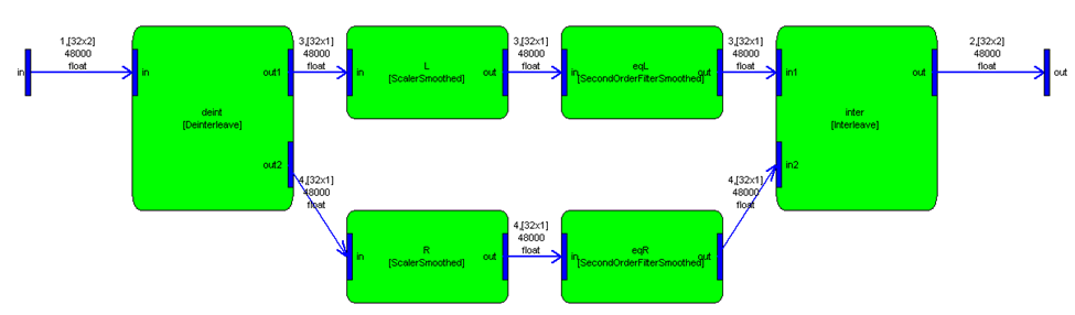

Consider the system shown in the figure below. This system is contained within the example script test_gui_ganged.m. The system has a stereo input, stereo output, and separate processing for the left and right channels. (Note that this is a contrived example since you could achieve the same result more easily and more efficiently by using stereo processing throughout.) To expose individual controls for the left and right gains, you would use the commands:
add_control(SYS, 'L.gain');
add_control(SYS, 'R.gain');
Similarly, we can gang together the set of inspector controls for the second order filter modules. The second order filter module has six different controls; four are on the non-expanded panel and two are on the expanded panel:
There are a few things to keep in mind when ganging together controls. First, the same inspector value is written to all of the variables. If you need finer control, such as a balance control that uses different gains for different scalers, you'll need to develop a custom audio module with its own set function. Second, the variable updates are not truly simultaneous. Instead, they'll be separated by a few milliseconds in time. If you need truly simultaneous updates, then develop a custom inspector.
Compare the combined inspector panel with the ones shown in the 4 inspector panels. All of the controls are there, but some of the (quite useful) labels shown in the window title bars are gone. For example, what do the first two level meters graphs correspond to? We can improve the combined inspector by overriding some of the variable names. By default, Audio Weaver utilizes the variable name as a label shown on the inspector. Override this default behavior by adding the command

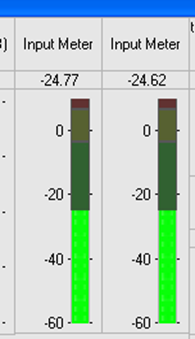

Prior to issuing the add_control(SYS, '.meter1') command. The inspector now draws as:
All of the default information needed to draw an inspector control comes from the detailed information within each awe_variable object. As we just saw, the default information can be overridden by setting fields within the variable's .guiInfo field. Other examples include:
Changing the range of a knob or meter:
Changing it here would have restricted the range for both MATLAB usage and when drawing the inspector.Changing the units shown

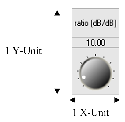

Audio Weaver uses a set of normalized coordinates when drawing controls. The coordinates are chosen such that a knob has a size of exactly 1 X-unit by 1 Y-unit:
You can also override the default size of a control by modifying the .guiInfo field. For example, the knobs and sliders in the overall dialog shown in the combined inspector panel have been vertically aligned by setting the control sizes:
Changing the Inspector Layout
The inspector panel shown in the combined inspector panel consists of 4 separate "sub-inspectors", one for each internal module. By default, Audio Weaver draws sub-inspectors and individual controls from left to right. Subsequent controls are added to the right of the last control.
An optional 3rd argument to add_control.m allows you to specify the position of the control. The syntax is:
where POSITION is either:
A 1x2 vector [offsetX offsetY] of normalized control units. The control is drawn at position [X Y] + [offsetX offsetY] where [X Y] is the position of the last control drawn.
One of the relative positioning strings 'right', 'topRight', 'below', 'bottomLeft', or 'bottomRight'. The control is drawn relative to the position of the last control. This is described below.
The difficulty with using the [offsetX offsetY] syntax is that you must know the size of the last control drawn in order to effectively use this form of the command. The relative positioning strings are much more useful and we focus on their usage below.
The 'right' command positions the next control immediately to the right of the last control added. The 'below' command positions the next control immediately below the last control added. The 'topRight' command positions the next control at the top edge of the dialog to the right of the right-most control. The 'bottomLeft' command positions the next control at the bottom edge of the lowest control all the way to the left. The 'bottomRight' command positions the next control below the lowest control and to the right of the right most control. A few examples will make this clear.
"gainDB" is the first control drawn and always appears at the top left corner of the inspector dialog.
"Input Meter" is drawn to the "right" or "topright" of "gainDB".
"targetLevel" is drawn to the "right" or "topright" of "InputMeter".
"ratio" is drawn "below" "targetLevel"
"activationThreshold" is drawn "below" "ratio".
"maxGain" is drawn to the "topright" of "activationThreshold".
"maxAttenuation" is drawn "below" "maxGain".
"smoothingTime" is drawn "below" "maxAttenuation".
"right" positions the next control one column to the right of the last control.
"below" positions the next control one row down from the last control.
"topRight" starts adds a new column to the right edge and positions the next control in the first row.

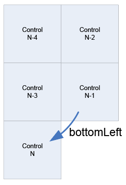

"bottomLeft" adds a new row at the bottom and positions the next control in the first column.
"bottomRight" adds a new row at the bottom and and to the right.

If the variable is an array, then controlType='grid' and the following is drawn:

An audio module can be in one of four run-time states: Active, Muted, Bypassed, and Inactive, as described in Real-Time Tuning. The module status is set using a group of radio buttons. To add a module status control, use the syntax:
where "moduleName" is the name of the module. The control has a normalized size of 1 by 1 and appears as shown below:
Note that the variable "moduleStatus" does not exist within the module. Instead, special case code is used to instantiate this control.

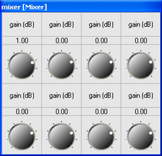

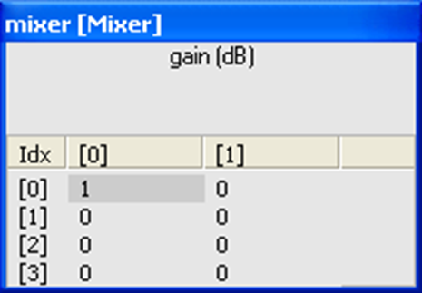

The default controlType assigned to an array variable is a grid control. The grid control displays a 2-dimensional matrix of values and is similar to an Excel spreadsheet. There are times when an array of controls (knobs, sliders, meters, etc.) is more convenient than a grid control. For example, consider a 4-input 2-output mixer_module.m The mixer gains are stored in a 4 x 2 matrix .gain of cofficients and the default inspector interface would appear as:

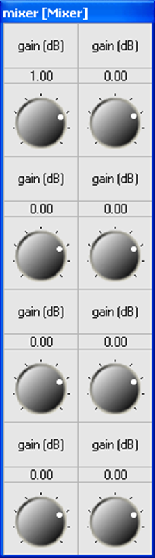

Mixers are typically drawn with knobs. Would it be possible to draw an "array of knobs"? Yes, simply override the controlType by setting
The inspector then draws as:
This is getting closer, but not exactly what is wanted. Mixer interfaces typically have each column dedicated to an input channel and each row dedicated to each output. We need to transpose the array of coefficients:
Certain other modules use arrays of controls when drawing themselves. For example, the meter_module.m is designed to operate on multichannel signals and uses a separate meter control for each audio channel. The meter_module.m script overrides the default grid control with a 'meter' module. The interfaces shown in 4 inspector panels and the Overall inspector panel have two controls shown for both the meter1 and meter2 modules. That is because these modules are displaying stereo information and thus a pair of meters is shown.

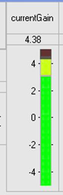

Logarithmic knob or slider. In audio, it is useful to have a knob that acts on a logarithmic scale for controlling frequency. To enable this, set:
You can see an example of this within the sine_gen_module.mRestricting knobs and sliders to even values:

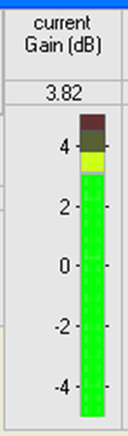

module.variable.guiInfo.attribStr='stepSize=2';Converting a linear value to dB for meter display. Often an audio module performs calculations in linear space whereas the preferred display is in dB. Instead of performing the linear to dB conversion on the target, you can perform it in the meter itself. Use:
