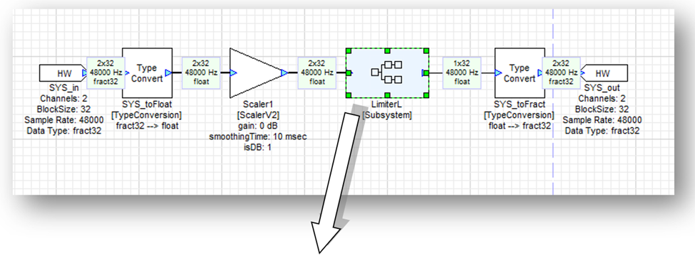

Subsystems can be used to organize your layout into coherent groups. To create a subsystem, drag out the Subsystem module from the Subsystem folder, then double click or right click and select ‘Navigate In’ to design the internal system. If more I/O is needed, add System Input and Output pin modules from the Subsystem folder of the module browser.
![](../../__attachments/2807727527/image-20221230-001649.png?inst-v=afeb83b1-861e-46b8-b4de-1c642321bb7f)
![](../../__attachments/2807727527/image-20221230-001655.png?inst-v=afeb83b1-861e-46b8-b4de-1c642321bb7f)

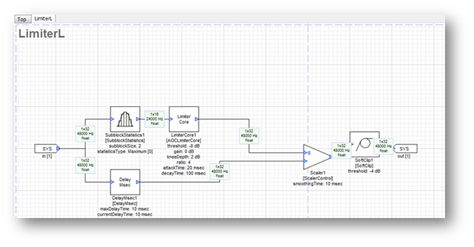

You can navigate through hierarchies either with the tabs at the top of the canvas, or by right clicking the canvas and selecting ‘Navigate Up’.

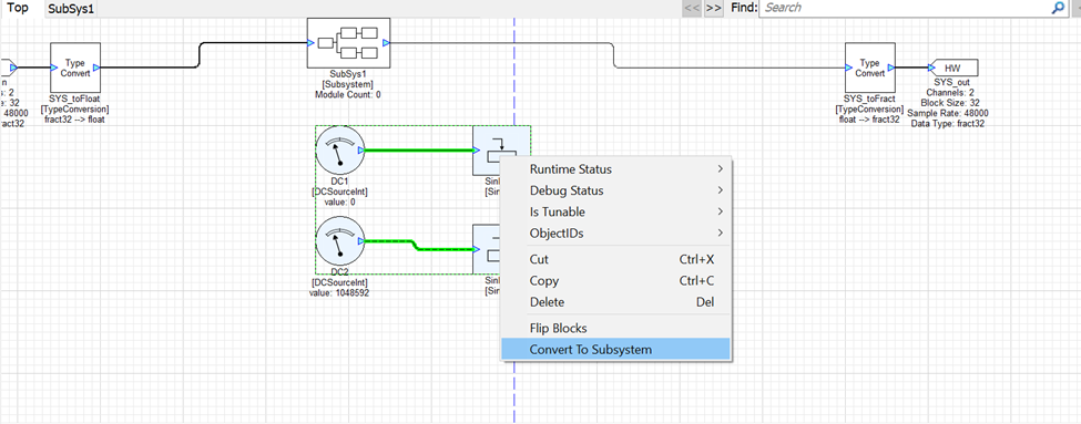

Convert To Subsystem
Instead of dragging out a new subsystem and manually adding modules, a user can create a subsystem from an existing set of modules. To do this, select a module or set of modules, right click, then select the Convert To Subsystem option. This will replace the selected modules with a new subsystem that contains the selected modules. Just as usual, a user can navigate through the different hierarchies with the ‘Navigate Up’ or ‘Navigate In’ options.

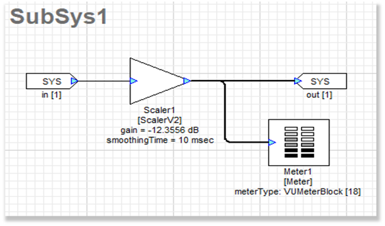

In this example, a subsystem has been created with a ScalerV2 module and a Meter module. The desire is to have a knob to control gain, and a meter to show the output level.
![](../../__attachments/2807727527/image-20221212-234521.png?inst-v=afeb83b1-861e-46b8-b4de-1c642321bb7f)

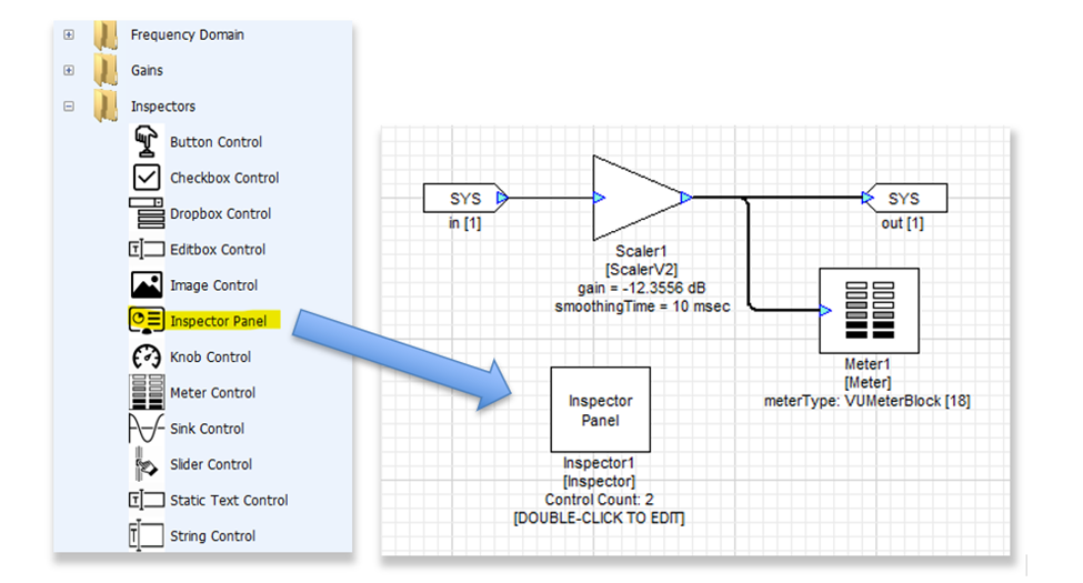

The scaler module and meter module are necessary to attach to the knob control and meter control. First, select “Inspector Panel” from the module palette under the “Inspectors” heading.
![](../../__attachments/2807727527/image-20221212-234554.png?inst-v=afeb83b1-861e-46b8-b4de-1c642321bb7f)

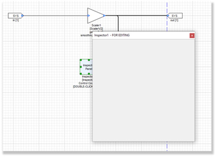

Drag the Inspector Panel onto the canvas. Double click the Inspector Panel to edit, a blank Inspector Panel will open in Edit Mode as in the following figure. Edit Mode can be used to add, delete, move or change properties of inspector controls.
![](../../__attachments/2807727527/image-20221212-234610.png?inst-v=afeb83b1-861e-46b8-b4de-1c642321bb7f)

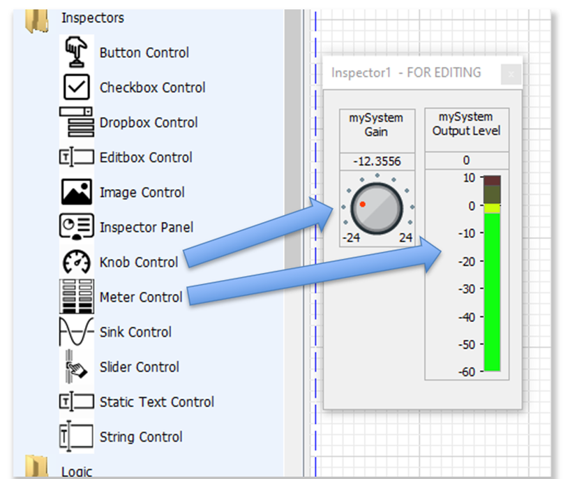

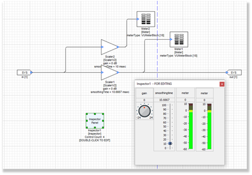

Drag a knob and meter inspector control from the palette:
![](../../__attachments/2807727527/image-20221212-234618.png?inst-v=afeb83b1-861e-46b8-b4de-1c642321bb7f)
If the editable user mode dialog is not large enough to accommodate the default size of the control, it cannot be placed – increase the size of the Inspector Panel, then retry placement.

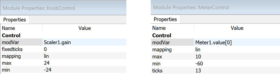

Before testing the dialog, one must attach the control to a module variable. Right click on the meter and knob controls in the Inspector Panel and click View Properties in the pop-up menu. Enter Scaler1.gain in the modVar field, and Meter1.value[0] in the modVar field of the meter. If the names of the modules were changed after placement, enter those names instead of Scaler1 and Meter1:
![](../../__attachments/2807727527/image-20221212-234648.png?inst-v=afeb83b1-861e-46b8-b4de-1c642321bb7f)

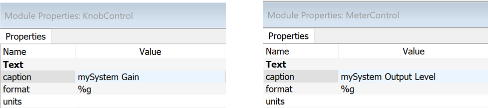

“Knob” and “meter” are generic, so one can rename them and customize the subsystem with the caption property:
![](../../__attachments/2807727527/image-20221212-234708.png?inst-v=afeb83b1-861e-46b8-b4de-1c642321bb7f)

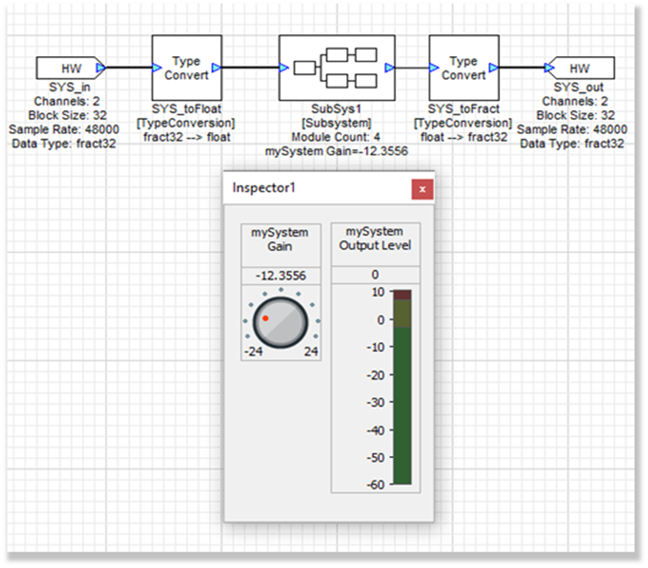

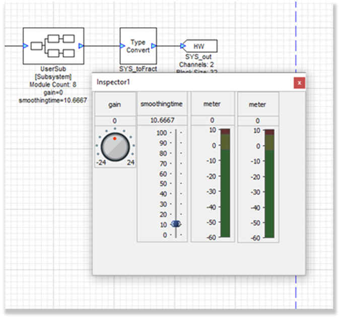

Next, ascend the hierarchy to the top level, where double clicking the subsystem will show the inspector dialog in Control Mode. Control Mode can be used during design time or run time to change the values of the module variables linked to each inspector control. For example, the knob control will change the subsystem’s gain module variable. The subsystem module block will show updates of the values as in the next figure:
![](../../__attachments/2807727527/image-20221212-234725.png?inst-v=afeb83b1-861e-46b8-b4de-1c642321bb7f)

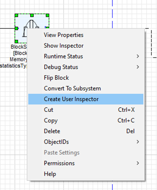

As a starting point, a user can right-click a module and select “Create User Inspector” to create a new Inspector Panel with the controls for this module.
![](../../__attachments/2807727527/image-20221212-234752.png?inst-v=afeb83b1-861e-46b8-b4de-1c642321bb7f)

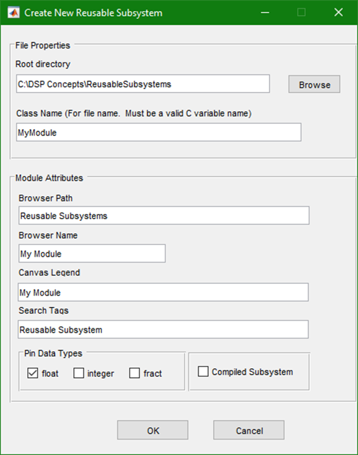

A new dialog window appears, titled “Create New Reusable Subsystem”, with the following entry fields (see figure below). Complete and edit these fields accordingly for this Reusable Subsystem:
Root Directory - root folder for the Reusable Subsystem’s generated folders/files (see Generated Folders/Files)
Class Name - Unique file name for the generated output files.
Browser Path - Category in which module will appear under in the module palette
If the subsystem was dragged onto an existing module directory in the Module Palette, this will be automatically populated with that existing directory name. Otherwise, this will be automatically populated with the new directory name “Reusable Subsystems”.
Browser Name - The name of the module that will appear in the module browser
Canvas Legend - The text which will appear in the reusable subsystem block when on the Canvas.
Search Tags - Search terms to locate this module in the Module Browser
Pin Data Types - Valid data types for module input pins (can select multiple types)
Compiled Subsystem – If checked, creates a Compiled Reusable Subsystem
Once the fields are set, click OK, and the Reusable Subsystem will be created.

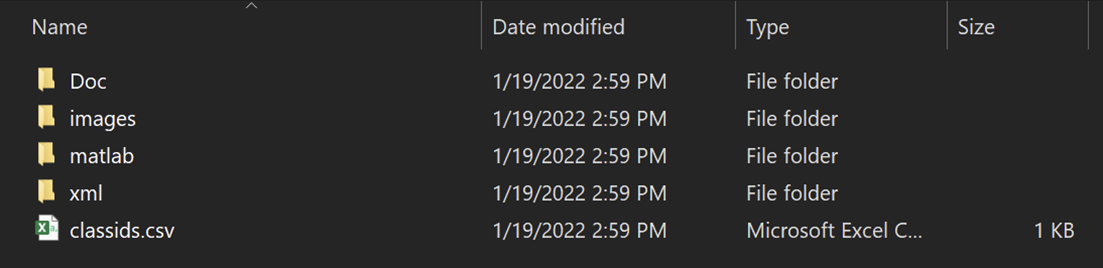

When a user clicks OK and creates a new Reusable Subsystem, Designer generates the necessary output files and folders, and adds them to the appropriate MATLAB paths. The location of this generated output depends on the Root Directory that was entered at creation time. This folder structure should not be modified by the user to ensure the Reusable Subsystem’s compatibility with Designer. See below for information about the generated output.
![](../../__attachments/2807727527/image-20221212-235000.png?inst-v=afeb83b1-861e-46b8-b4de-1c642321bb7f)
