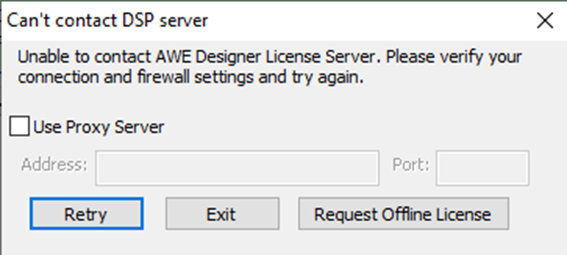

If not able to connect to the DSP concepts license server, either because the user is offline or if a corporate firewall is blocking access, the following message box will appear:
![](../../__attachments/2879261461/image-20221214-231641.png?inst-v=afeb83b1-861e-46b8-b4de-1c642321bb7f)
Click the ‘Request Offline License’ button to see the information needed to request a license key from DSP Concepts that can be used to enable Designer without accessing the license servers. Email the information to licensing@dspconcepts.com, and once an offline license key has been received, repeat this process and enter the key in the ‘License Key’ field of the ‘Request Offline License’ menu.
