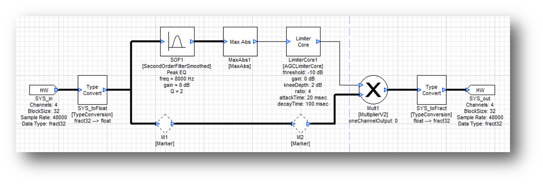

Broadband De-Essing
In the broadband approach the entire signal level is reduced when harsh high frequencies are detected. A standard AGCLimiterCore can be used with a sidechain EQ which accentuates the 8 kHz problem frequencies.

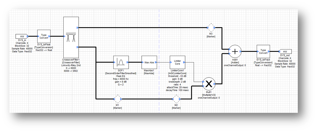

Split Band De-Essing
One improvement is to use a crossover and treat sibilant and non-sibilant frequencies separately. A 2-way crossover with a cutoff frequency of 6 kHz is used. A limiter then acts on the high frequency signals and reduces the gain, if necessary; the low frequencies are untouched.

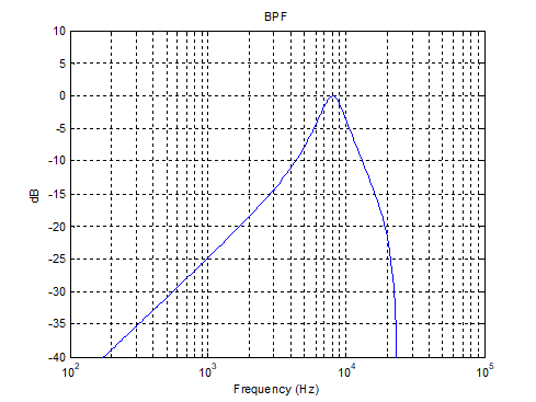

It is still possible to do better. In the Split Band De-essing all signals above 6 kHz are reduced in gain if sibilants are detecting. The design below is even more precise. A bandpass filter around 8 kHz detects sibilants.
![](../../__attachments/2878933888/image-20221229-002032.png?inst-v=afeb83b1-861e-46b8-b4de-1c642321bb7f)
The output of the bandpass filter drives a limiter core and this in turn reduces the gain of a controllable second order peak filter. This limits the gain reduction to the range of frequencies from 6 to 10 kHz. The entire system is shown below:
