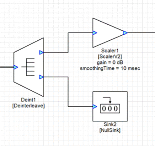

Example #1 — Selecting a single channel
![](../../__attachments/2879095839/image-20230130-190704.png?inst-v=326272e9-cc04-48f3-a51a-5d633eb0a230)

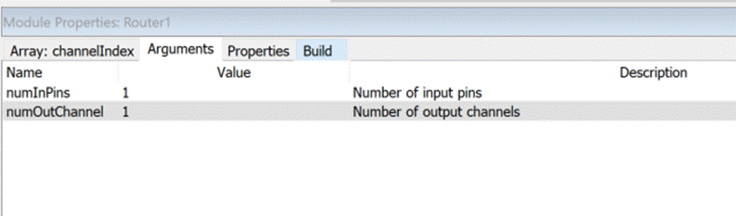

This is wasteful because it requires 3 modules to do what a single router module can do. Create a Router with 1 input pin and 1 output channel.

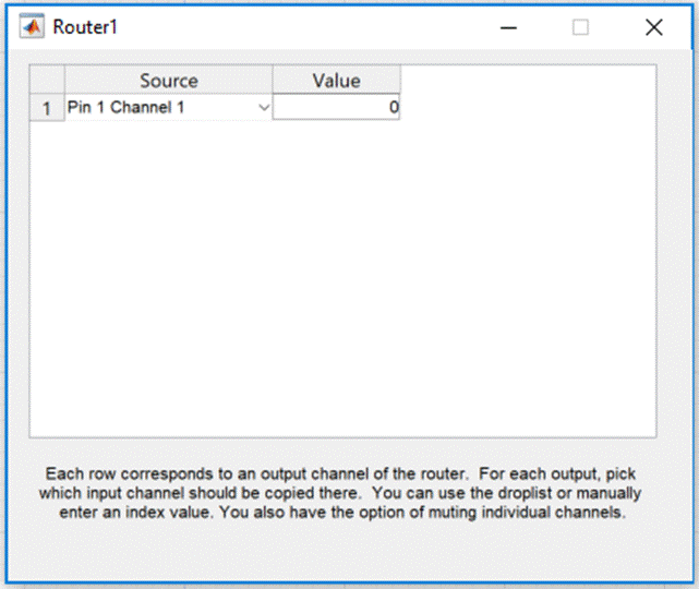

The desired left output channel is on pin 0 and channel 0 so set .channelIndex to 65536 * 0 + 0 = 0.
