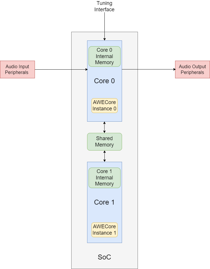

Standard SoC Architecture Example
Consider a standard multicore SoC architecture:
![](../../__attachments/2934472762/att_10_for_2934472762.png?inst-v=afeb83b1-861e-46b8-b4de-1c642321bb7f)
Figure 1: Generic Audio SoC Architecture
In this SoC architecture, there are two separate processing cores.
Core 0 has:
Access to the tuning interface
Access to all Audio I/O peripherals
Access to shared memory region
Its own internal memory region
Core 1 has:
In this typical multicore SoC architecture, an instance of AWE Core can be placed on each core. The shared memory of the SoC is utilized by AWE Core to communicate between the two instances, as well as buffer audio data between instances. AWE Core handles all data exchange between instances; no user protocol or software needs to be written to facilitate.

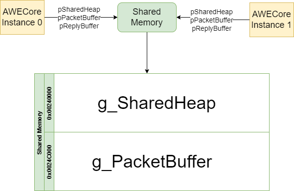

Initializing shared heap
To facilitate multi-instance with AWE Core, each AWE Core instance requires an initialization of the shared heap.
/*------------------MULTI-INSTANCE SUPPORT------------------*/
/** AWE Core shared memory definitions.
* OPTIONAL if using only single-instance AWE Core.
/** The shared heap. */
volatile UINT32 *pSharedHeap;
/** The shared heap size. */
UINT32 sharedHeapSize;
The shared heap is a contiguous section of memory which occupies the same physical address space for all AWE Core instances.
![](../../__attachments/2934472762/att_9_for_2934472762.png?inst-v=afeb83b1-861e-46b8-b4de-1c642321bb7f)
Figure 2: Shared Address Space Architecture
pSharedHeap points to this contiguous segment of memory. Every AWE Core instance in use is required to point to the same shared memory region address space. For this reason, shared heap must be placed in a shared memory region.
The size of this region is provided to AWE Core using sharedHeapSize.

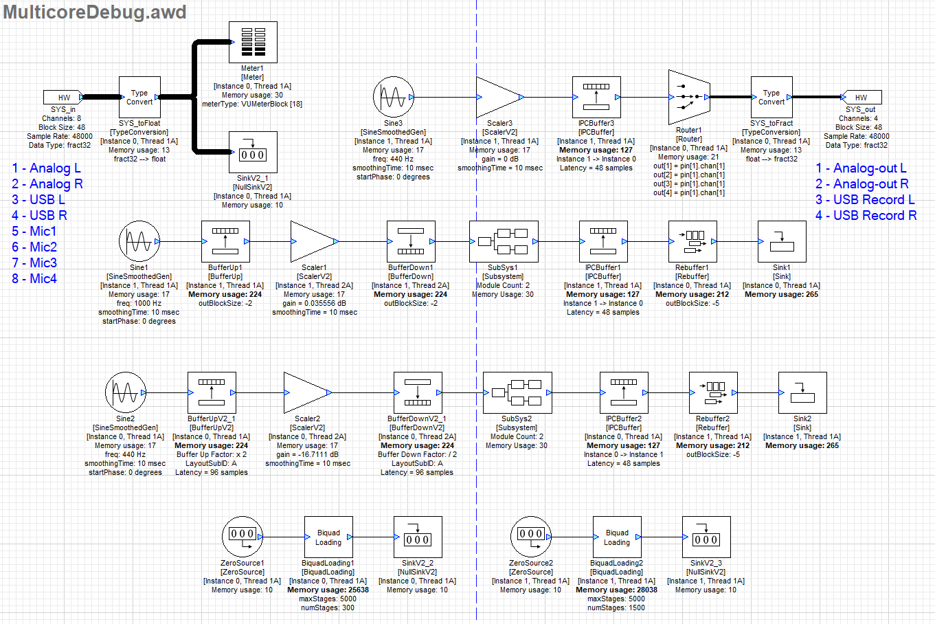

Creating multi-instance designs in AudioWeaver
AudioWeaver provides a single design canvas which can place modules on any instance. Audio data can be routed between instances in one design file, which allows users to move processing loads seamlessly to available cores on an embedded target. The below example canvas has processing distributed over two AWE Core instances residing on two different processing cores.
![](../../__attachments/2934472762/att_11_for_2934472762.png?inst-v=afeb83b1-861e-46b8-b4de-1c642321bb7f)
Figure 3. Multi-instance Canvas
When connected to a multi-instance target, AudioWeaver Designer will show a module’s current instance ID below the module:
![](../../__attachments/2934472762/att_1_for_2934472762.png?inst-v=afeb83b1-861e-46b8-b4de-1c642321bb7f)
Figure 4. Module Instance Identification
The instance ID of a module is propagatable between modules, which means that if the output of a module on instance ID 0 is routed to another module, that second module will inherit the instance ID and process on instance ID 0 as well.

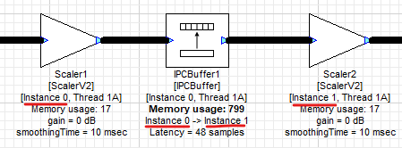

There are two ways of changing the instance ID of a module.
Using the IPCBuffer module
(Source modules only) Modify the clockDivider field of a module
IPCBuffer Module
The IPCBuffer module is a simple module which takes an input data wire, and using a tunable parameter targetInstance, directs this data to a new instance. Modules connected to the output of the IPCBuffer module will inherit this new instance ID.
![](../../__attachments/2934472762/att_2_for_2934472762.png?inst-v=afeb83b1-861e-46b8-b4de-1c642321bb7f)
Figure 5. IPCBuffer Example

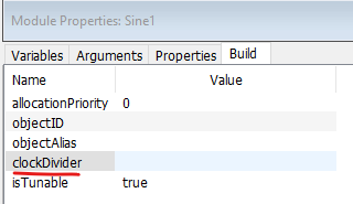

Changing the instance ID of a Source module
For source modules (modules which do not have an input wire), one can change the instance ID by modifying the clockDivider field of the module.
Take as an example a sine generator module:
![](../../__attachments/2934472762/att_3_for_2934472762.png?inst-v=afeb83b1-861e-46b8-b4de-1c642321bb7f)
Figure 6. Initial Sine Generator State
When dragged onto the canvas, the module always defaults to ‘Instance 0’.
To reach the clockDivider field, right-click on the module and select View Properties.
In the bottom pane that appears, select the Build tab, and locate the clockDivider field.
![](../../__attachments/2934472762/att_4_for_2934472762.png?inst-v=afeb83b1-861e-46b8-b4de-1c642321bb7f)
Figure 7. clockDivider field

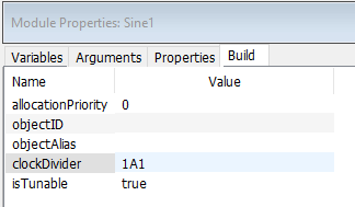

The clockDivider field encodes three Parameters ‘Clock Divider | Thread ID | Instance ID’.
In designs/layouts with multiple sub layouts, that are created with Buffer Up / Buffer Down modules that operate at different Block Sizes. The ‘Clock Divider’ field will specify under which layout this said module should be executed. The ‘Clock Divider’ field will range from 1 to n (Number of Audio Threads implemented on the Target).
The ‘Thread ID’ field specifies the thread Id on which the said module should be executed. On Targets that support multiple parallel threads, this feature could be exploited. For instance, the system input pin is always in layout 1A, and any sub layouts with the same clock divider could reside on different threads 1B, 1C, alphabetically up to 1P.
The ‘Instance ID’ specifies the AWE Core instance on which the said module should be executed, the SYS_in and SYS_out pins will execute on Instance 0, the said module in this case can be selected to run on any Instance supported by the Target. The ‘Instance ID’ will range from 0 to N (Nth AWE Core instance supported by the Target).
For more detailed information on Clock divider and Threads see here.
As an example, let’s have the ‘Clock Divider | Thread ID’ in its default thread as ‘1A’. However, it is desired in this example to change the instance ID to 1. Thus, the clockDivider field should be set to ‘1A1’. And configuring it to ‘1A2’ will specify the module to execute on instance 2 so on and so forth.
![](../../__attachments/2934472762/att_5_for_2934472762.png?inst-v=afeb83b1-861e-46b8-b4de-1c642321bb7f)
Figure 8. Modified clockDivider

Utilizing multi-instance AWE Core requires these steps:
Allocate a shared heap memory space in a memory region accessible to all AWE Core instances.
Allocate the tuning packet buffer in a shared memory region accessible to all AWE Core instances. Initialize the reply buffer pointer to the same memory region as the packet buffer.
For each AWE Core instance, provide the shared heap and shared packet buffer, ensuring they occupy the same address space in memory for each instance.
Provide a unique instanceId to each AWE Core instance, with instanceId 0 reserved for the AWE Core instance connected to the tuning interface.
Set the numProcessingInstances member of each AWE Core instance to the total number of AWE Core instances on the target system.
Using a global software interrupt accessible to all AWE Core instances, trigger each instance to check their pump mask and pump. This trigger is required to be synchronous to the audio peripheral data passed in/out of AWE Core instance 0.
Process packet buffer data using the multi-instance packet process API. For the tuning master instance, the API is called once a complete packet is received. For non-tuning instances, the API is polled in a low-priority task.
