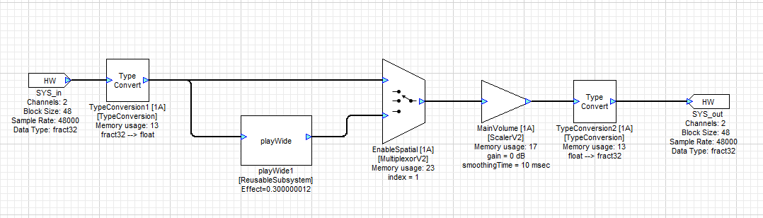

Figure 1 shows an example layout demonstrating the PlayWide Reusable Subsystem. This example layout is designed to run in Native Mode with a file input; audio signals must be assigned to appropriate channels for a target device.
![](../../__attachments/2934472726/att_2_for_2934472726.png?inst-v=afeb83b1-861e-46b8-b4de-1c642321bb7f)
Figure 1: Example layout demonstrating the playWide Reusable Subsystem

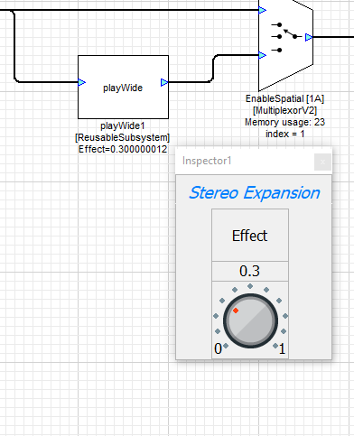

The PlayWide Reusable Subsystem includes an inspector which allows users to tune the strength of the stereo expansion effect. The Effect knob ranges from 0 to 1, with 0 yielding no effect and 1 yielding the strongest effect. DSP Concepts recommends using an Effect level of 0.3 as a default.
![](../../__attachments/2934472726/att_3_for_2934472726.png?inst-v=afeb83b1-861e-46b8-b4de-1c642321bb7f)
Figure 2 playWide Reusable Subsystem inspector window
