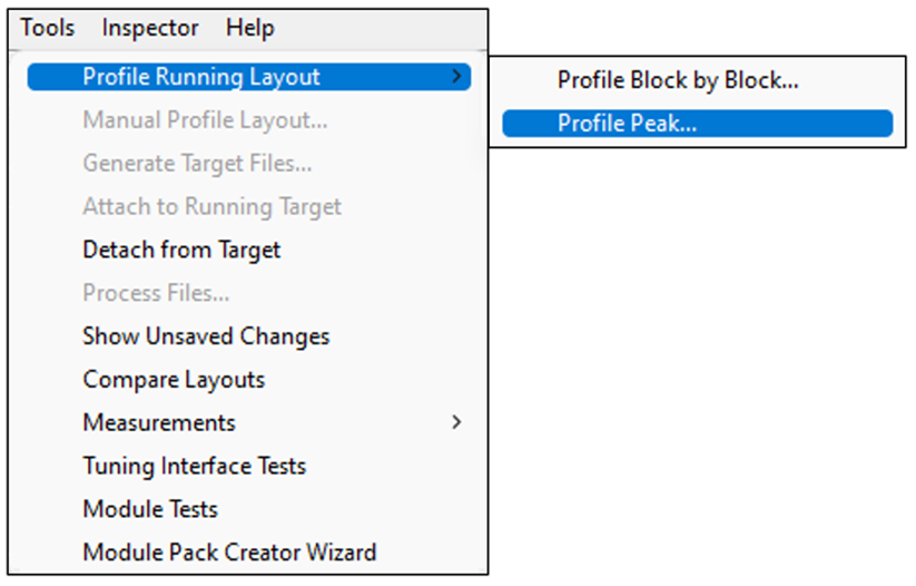

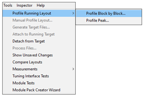

To profile a running .awd in real time, navigate to the ‘Tools > Profiling Running Layout’ menu in the Audio Weaver Designer toolbar while in Tuning Mode:
There are two options for profiling a running .awd layout in real time:
Profile Block by Block
Profile Peak

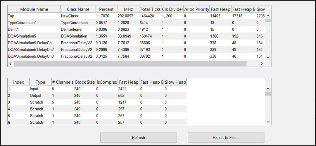

Block by Block Profiling

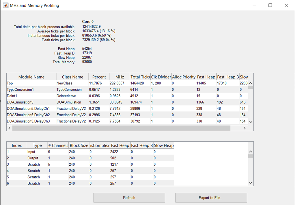

When selecting the Profile Block by Block real time profiling option, a window with the complete profiling data of the running .awd layout will pop up:
Profile Block by Block Window

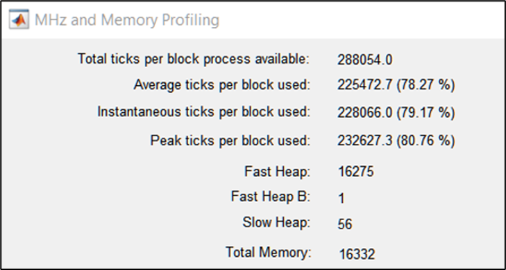

In the upper right-hand corner of the profiling window provides the following information:
Total ticks per block
Average ticks per block
Instantaneous ticks per block
Peak ticks per block
Total memory usage of the system
Profile Block by Block Terminology
The following table describes each field:
Table: Profile Block by Block Terminology
Field | Definition | Unit |
Total ticks per block process available | Measurement from the end of the CPU first interrupt This is an especially important number to check when you are bringing up new hardware. The value shown here should be close to: (Processor Speed) x (Block Size of Processing) / (Sample Rate) If this doesn’t match, then there could be a mismatch in your processor speed, the audio sample rate, or the underlying “fundamental block size” of your implementation. | CPU clock cycles |
Average ticks per block used | Average of CPU clock cycles per block of audio data | CPU clock cycles |
Instantaneous ticks per block used | CPU clock cycles required to process the last block of audio. This is the instantaneous measurement without smoothing. This number will change every time you profile. | CPU clock cycles |
Peak ticks per block used | Peak instantaneous CPU clock cycles consumed when processing a block of audio data. This is a “sticky measurement” and shows the peak value since system startup. If you reprofile, then it will reset this value. | CPU clock cycles |
Fast Heap | Memory usage from the memory allocated in the Fast Heap | Words |
Fast Heap B | Memory usage from the memory allocated in the Fast Heap B | Words |
Slow Heap | Memory usage from the memory allocated in the Slow Heap | Words |
Total Memory | Fast Heap + Fast Heap B + Slow Heap | Words |
Heaps At initialization time, memory to be used by the AWE Core instance for signal processing is allocated. The AWE Core refers to this memory as the heap. By default, AWE Core supports three heaps for which the BSP is responsible for allocating storage. Most commonly, heaps are allocated statically as large arrays. The heaps are:
To calculate Memory in MB: ((Total Heap Memory) * 4)/1000000 | ||

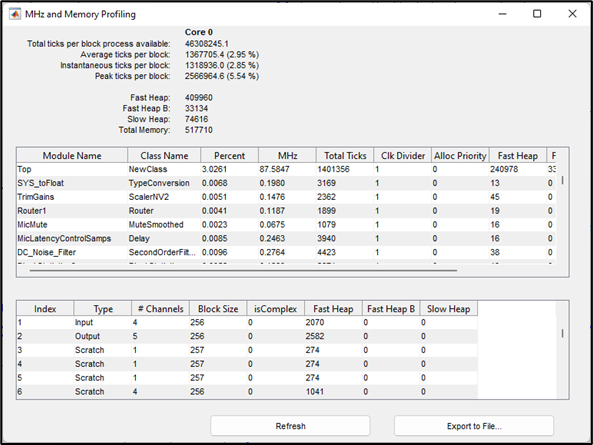

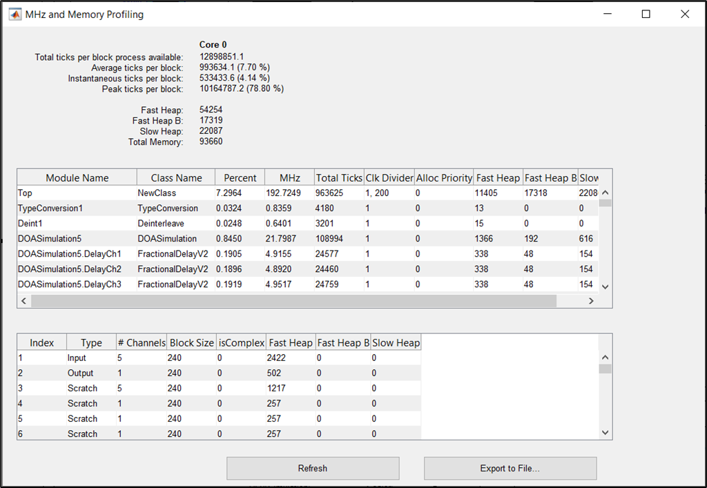

The rest of the profiling window provides profiling information for each individual module and wire (audio buffer) in the running .awd layout:
Profile Block by Block Individual Module & Wire Profiling
Note: The ‘Top’ Module Name is profiling information for the entire .awd layout’s processing

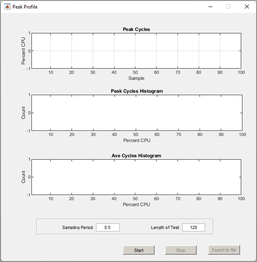

Peak Profiling

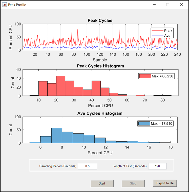

When selecting the Profile Peak real time profiling option, the Peak Profile Window will pop up:
Profile Peak
Profile Peak Window
As discussed above, the ‘Sampling Period’ and ‘Length of Test’ fields must be entered in order to run the peak profiling. The time unit for both fields are seconds, and the default values are 0.5s sampling period and 120s length of test. When ready to start the peak profiling, simply click the Start button.
The Peak Profile window will update in real time as the profiling is executed. You can click the Stop button at any time during the profiling if needed, otherwise the peak profiling will complete at the end of the specified length of test.

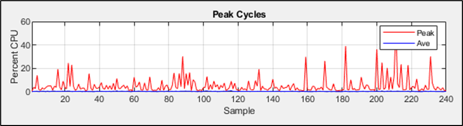

The ‘Peak Cycles’ graph at the top of the peak profiling window displays peak and average CPU usage percentages of whatever hardware target Audio Weaver is connected to. The x-axis is time in samples and the y-axis is CPU percentage:
Peak Cycles

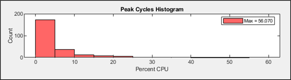

The ‘Peak Cycles Histogram’ displays a histogram of the peak cycles profiling shown in the above ‘Peak Cycles’ graph, where the x-axis is CPU percentage, and the y-axis is cycle count:
The key in the upper right-hand corner of the histogram shows the maximum peak CPU percentage measured during the peak cycle profiling:
Max Peak CPU Percentage

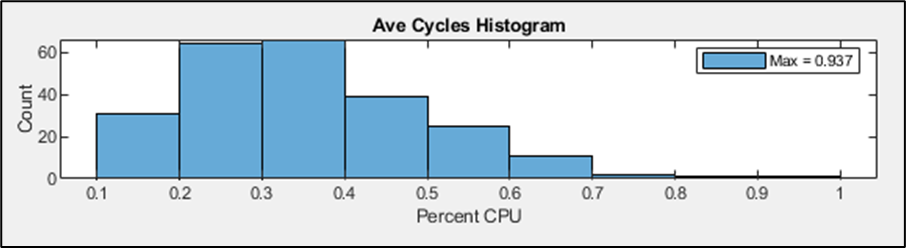

Lastly, the ‘Ave Cycles Histogram’ displays a histogram of average cycle profiling shown in the above ‘Peak Cycles’ graph, where the x-axis is CPU percentage, and the y-axis is cycle count:

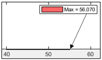

The key in the upper right-hand corner of the histogram shows the maximum average CPU percentage measured during the peak cycle profiling:
Max Average CPU Percentage

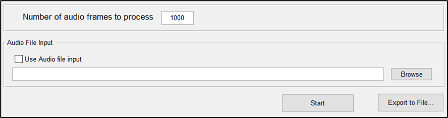

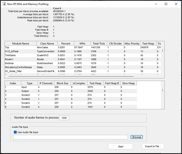

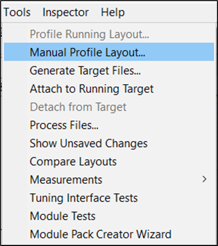

Manual Profiling
As mentioned earlier in this application note, Audio Weaver also features Manual Profiling, which works in Design Mode (.awd not running). The system profiling resulting from Manual Profiling collects the same information as the real time profiling but adds the option for a user to set the number of iterations to call the layout audio pump (blocks of audio data).
To Manual Profile an .awd layout, navigate to ‘Tools > Manual Profile Layout’ in the Audio Weaver Designer toolbar while in Design Mode:
In the Manual Profile Settings, you can set the number of audio frames/blocks of audio to process and an audio file to be used as input audio data. Manual Profiling also supports .csv exports of the profiling data:

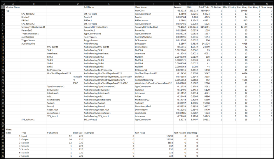

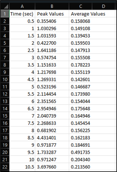

Exporting Profiling Data to CSV
Both the Real Time and Manual Profiling utilities Audio Weaver allow you to export the profiling data to a comma separated value (.csv) file. All three of the profiling windows (Profile Block by Block, Profile Peak, and Manual Profile Layout) have an ‘Export to File’ Button:
Export to File
Once clicked, you will be prompted to choose a file name and path for the profiling data export. Once exported and saved, you can open the .csv file in Microsoft Excel or equivalent.
The Profile Block by Block and Manual Profile Layout .csv files are structured identically to the pop-up window in Audio Weaver:
Block by Block Exported CSV
The Profile Peak .csv file is structured as follows, where the Peak and Average Cycle values are indexed by time in seconds:
Profile Peak Exported CSV

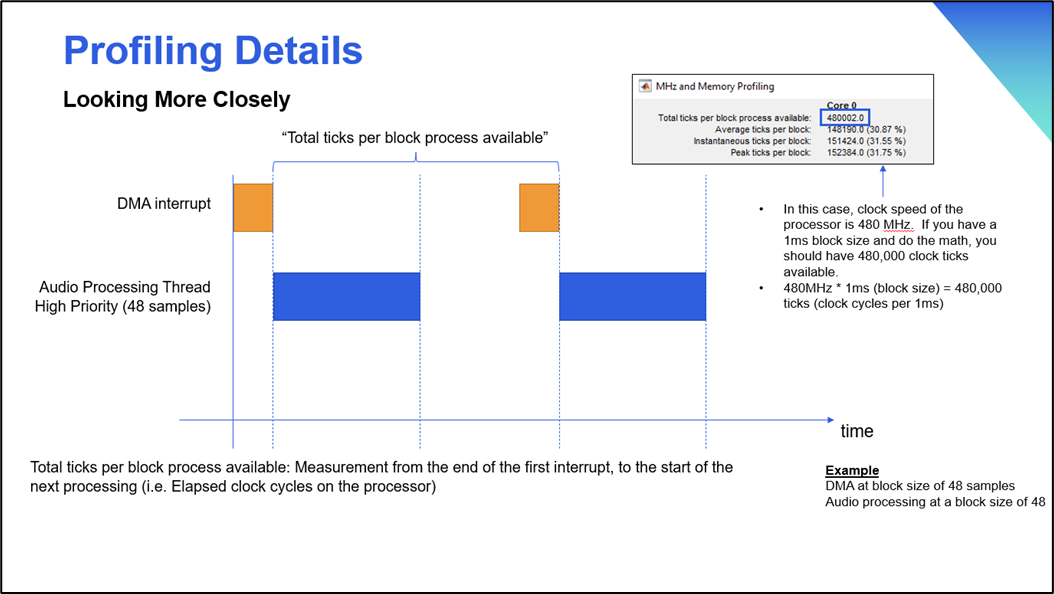

Profiling Diagrams
Below are some diagrams that further illustrate the real time profiling function in Audio Weaver.

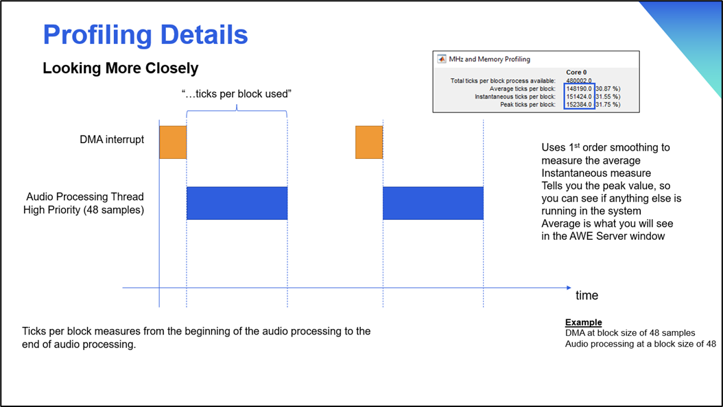

Profiling Details: Single Threaded Profiling
Profiling Details: Total ticks Per Block Process Available
Profiling Details: Ticker Per Block

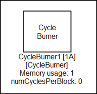

CycleBurner Module
The CycleBurner wastes a specified number of clock cycles. You can increase the number of clock cycles used by CycleBurner by adjusting the ‘numCyclesPerBlock’ slider of CycleBurner’s inspector. Using this technique, we can increase the number of cycles until we start to hear distortion in the program material that is being processed by the signal flow.
CycleBurner Module
If a higher priority task pre-empts the CycleBurner, then the execution time of the CycleBurner will remain constant. This assumes that the module is pre-empted, and the pre-emption completes before the Cycle Burner completes.

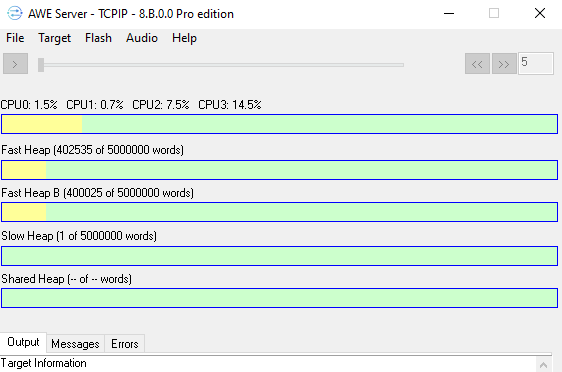

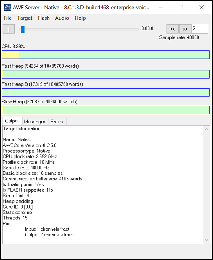

Audio Weaver Server Profiling
While an .awd is running in Audio Weaver, the Audio Weaver Server provides real time CPU and Memory profiling of the entire layout:
Server Profiling on Multi-CPU Targets
AWE Core may be running in multiple threads on several CPUs in some instances. The application is not aware of which CPU the thread is running on by default. This means that without some extra work, the default display of CPU % cannot be trusted for multi CPU targets as the assumption will be that all threads run on a single CPU.
If CPU affinities are enabled on the target, server will display text percentages for each CPU that a layout is running on. The CPU percentage indicator bar will show the load for the CPU which has the highest load. Any CPUs without an associated layout will not be shown.
Setting and getting CPU affinities is done through the AWE Core functions awe_fwSetLayoutCoreAffinity and awe_fwGetLayoutCoreAffinity. These functions are described in the AWE Core API documentation. Customers utilizing AWE Core OS have this feature built in as described here.
