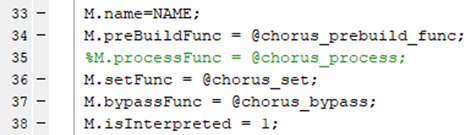

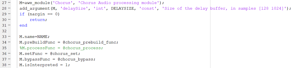

Add the line "isinterpreted = 1;" to the
<modulename>_module.m file (found in the “matlab” folder of your custom module) anywhere after the “M = awe_module(…” assignment in the “matlab/” directory of your custom module.
Add spaces around equals signs for assignment functions (see lines 34-37 in Figure 1)
![](../../__attachments/2995093589/image-20231121-160235.png?inst-v=afeb83b1-861e-46b8-b4de-1c642321bb7f)
Figure 1 - see line 38

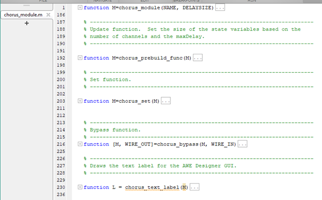

Separate out functions contained in the
<modulename>_module.m file to individual .m files.
![](../../__attachments/2995093589/image-20231121-160302.png?inst-v=afeb83b1-861e-46b8-b4de-1c642321bb7f)
![](../../__attachments/2995093589/image-20231121-160309.png?inst-v=afeb83b1-861e-46b8-b4de-1c642321bb7f)
Figure 2 - Before separating functions into unique .m files

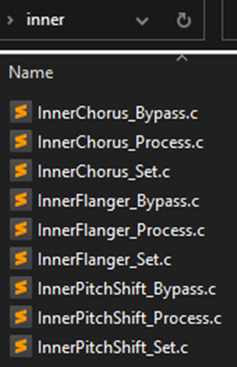

![](../../__attachments/2995093589/image-20231121-160420.png?inst-v=afeb83b1-861e-46b8-b4de-1c642321bb7f)
![](../../__attachments/2995093589/image-20231121-160426.png?inst-v=afeb83b1-861e-46b8-b4de-1c642321bb7f)
Figure 3- After separating functions into unique .m files
NOTE: Confirm there is a corresponding .m file for any function being defined, otherwise comment out the definition. For example, this module was failing because there was no corresponding “chorus_process.m” file. Commenting out line 35 fixed the issue.
![](../../__attachments/2995093589/image-20231121-160635.png?inst-v=afeb83b1-861e-46b8-b4de-1c642321bb7f)
Figure 4 - Comment out any unused function definitions

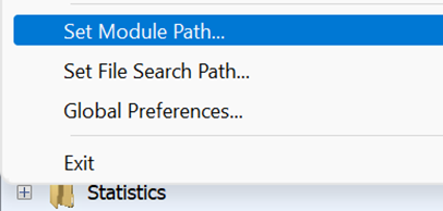

Set Module Path in Designer

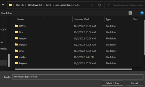

In Designer Standard, go File-> Set Module Path, then click Add Folder, select your custom module folder, and click Select Folder. Your module should now show in the modules tab and load into Designer.
![](../../__attachments/2995093589/image-20231121-160821.png?inst-v=afeb83b1-861e-46b8-b4de-1c642321bb7f)
![](../../__attachments/2995093589/image-20231121-160839.png?inst-v=afeb83b1-861e-46b8-b4de-1c642321bb7f)
Figure 5- Add Module Path
