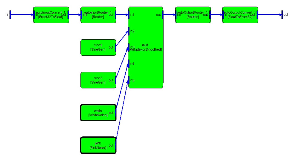

Consider the system shown below and contained within multiplexor_example.m.
To connect the output of the sine generator1 to the second input of the multiplexor, use the command:
connect(SYS, 'sine1.out', 'mult.in2');

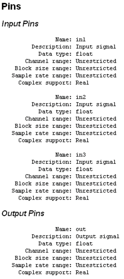

awe_help multiplexor_smoothed_module

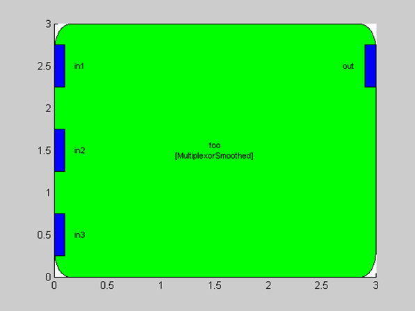

or have MATLAB draw the module
M=multiplexor_smoothed_module('foo');
draw(M)
