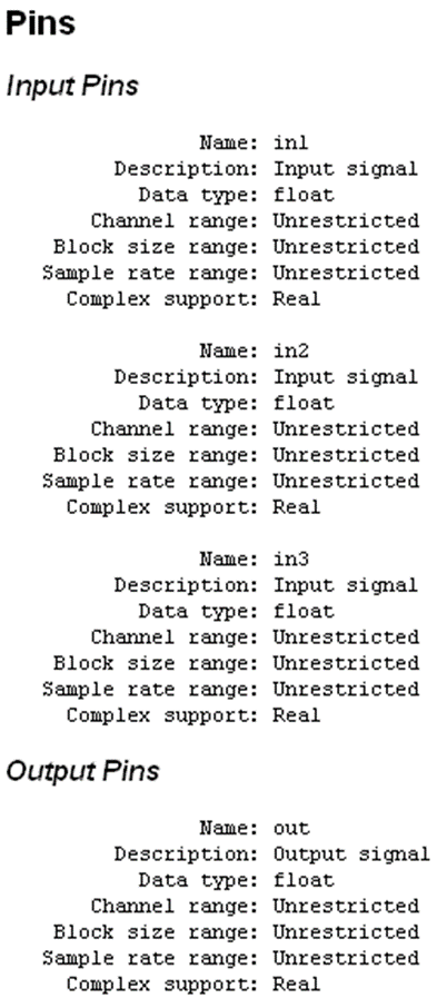

add_pin.m
Pins are added to a module by the add_pin.m function.  Each pin has an associated Pin Type as described in new_pin_type.m.  After creating the Pin Type, call the function
for each input, output, or scratch pin you want to add.
The arguments are as follows:
  • M — @awe_module object.
  • USAGE — string specifying whether the pin is an ‘input’, ‘output’, or 'scratch'.
  • NAME — short name which is used as a label for the pin.
  • DESCRIPTION — description of the purpose or function of the pin.
  • TYPE — Pin Type structure.
  • numPinArray — Distinguish between a scalar pin and a pin array. For scalar pin this value will be 0 and for pin array this value will be size of the pin array.
M.inputPin, M.outputPin, and M.scratchPin are cell arrays that describe the pins.  Each call to add_pin.m adds an entry to one of these arrays, depending upon whether it is an input, output, or scratch pin.  For example, to determine the number of input pins that a module has, use
length(M.inputPin)
or to print out all of the names of the output pins
CODE
for i=1:length(M.outputPin)
	fprintf(1,'%s\n', M.outputPin{i}.name);
Some processing functions require temporary memory storage.  This memory is only needed while processing is active and does not need to be persisted between calls.  (On the other hand, memory that needs to be persisted by a module between calls to the processing function appears in the instance structure and has usage "state".)  Allocating temporary memory and sharing it between modules is accomplished by scratch pins.  Scratch pins are added to a module via add_pin.m with the USAGE argument set to 'scratch'.  Scratch pins are typically not used by audio modules, but are often required by subsystems. For subsystems, the routing algorithm automatically determines scratch pins at build time.
In some cases, you want to add a pin to a subsystem that is of the same type as an internal module.  For example, the Hilbert subsystem uses the same pin type as the Biquad filter.  This can be achieved programmatically:
CODE
Rules to add_pin.m:
  • Pins of the same direction should have no duplicate names.
  • If the module has number of pins depends on the argument then the number of pins must be passed as last argument to add_pin(). For example, interleave_module.m has input pins depends on argument, NUMIN. Input pins must be added as below:
    add_pin(M, 'input', 'in', 'Input signal', PT, NUMIN);
    The module will display input pins as in1, in2 …. in<NUMIN> in the designer. Here ‘in’ is the base name.
  • If the module has scalar pin along with pin array, then the scalar pin name must not match the bas name of a pin array.

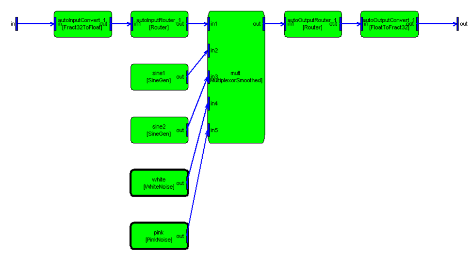

connect.m
Creates a connection between two pins in a subsystem.  The general form is:
connect(SYS, SRCPIN, DSTPIN);
where SRCPIN and DSTPIN specify the source and destination pins, respectively.  Pins are specified as strings to the connect.m command using the syntax:
moduleName.pinName
Consider the system shown below and contained within multiplexor_example.m.
The module names "sine1" and "mult" are obvious because they were specified when the modules were created.  The pins names may not be obvious since they appear within the module's constructor function.  To determine the names of a module's pins, you can either utilize the detailed help function awe_help (recommended)
CODE
draw(M)
Several shortcuts exists to simplify use of the connect.m command:
  • If the module has only a single input or output pin, then you need only specify the module name; the pin name is assumed.  Since the sine wave generator module in the multiplexor example has only a single output pin, the example above reduces to:
  • Inputs and outputs to the subsystem are specified by the empty string.  Thus,
    connect(SYS, '', 'mult.in1');
    connects the input of the system to the first input of the multiplexor.  Similarly,
    connect(SYS, 'mult', '');
  • By default, the connect command performs rudimentary error checking.  The function verifies that the named modules and pins exist within the subsystem.  At build time, however, exhaustive checking of all connections is done.  Audio Weaver verifies that all connections are made to compatible input and output pins (using the range information within the pin type).  You can enable this exhaustive checking when a connection is made by supplying a 4th argument:
    connect(SYS, 'mult', '', 1)
    This is useful when debugging wiring failures that are revealed at build time.
Output pins are permitted to fan out to an arbitrary number of input pins.  Input pins, however, can only have a single connection.
Audio Weaver is set up to handle several special cases of connections at build time.  First, if an input pin has no connections, Audio Weaver inserts a source module and connects it to the unconnected input.  Either a source_module.m (float) or source_fract32_module.m is added based on the first input to the system (Audio Weaver is guessing at the type of pin that needs to be connected).  If a module has an output pin without a connection, Audio Weaver inserts a sink module based on the data type of the unconnected pin. This is always correct since the pin type is inherited from the module's output pin.
CODE
sink_module.m                  Floating-point data
sink_fract32_module.m          Fixed-point data=
sink_int_module.m              Integer data
If the subsystem has a direct connection from an input pin to an output pin, then a copier_module is inserted.  If a module output fans out to N outputs of the subsystem, then N-1 copier modules are inserted. This is required since each output of the subsystem is stored in a separate buffer.

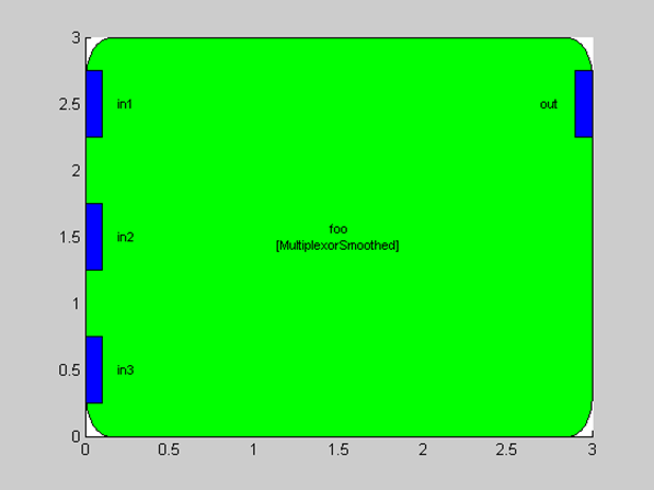

Module for AWE Designer
This section focus on the module browser information related to AWE Designer. Every module must initialize the moduleBrowser and shapeInfo structure of the MATLAB module object. Below is the example settings of downsampler_example_module.m module. Refer the section 3.2 for complete information of these structures.
CODE
M.moduleBrowser.path = 'Examples';
M.moduleBrowser.image = '../images/E.bmp';
M.moduleBrowser.searchTags = 'decimation';
M.shapeInfo.svgImage = '../../images/DownSampler.svg';
M.shapeInfo.size = [6 6];
  • .path — is the folder name in the AWE Designer browser tree.
  • .image — is the module browser image file to be used to display the module in AWE Designer         browser tree. If no image file is empty, then the default image file will be used by the Designer.
  • .searchTags — is the string to search in the Designer search filed to find the module.
  • .svgImage — is the module shape image file to be used by the designer to draw the shape in the layout area when the module is drag and dropped in the layout area. If this field is empty then the default rectangle shape is used by the Designer. If an invalid SVG image is provided, an error will be logged in the Bin/Assets/logs/general.log file. See the Audio Weaver Logging Guide for details.
  • .size — is the shape size in the Designer layout area.
When the module is generated by executing the make script, for example make_examples.m, the XML file is generated which is used by the AWE Designer. XML file holds the complete information about the module to AWE Designer, like browser image file path, svg image file path for module shape, help document path, module arguments and other settings for AWE Designer. The information in XML file is extracted from the module file from the moduleBrowser and shapeInfo fields. Below is the example XML file of downsampler_example_module.m module.
