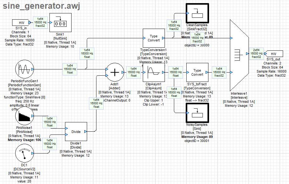

Sine Wave Generator
A simple sine wave generator layout (provided in pyawecore/Designs/sine_generator.png
) can be used to generate a stereo WAV file. This first channel contains a clean sine tone, and the second channel is distorted with a pink noise.
To run this with PyAWECore Library (from the pyawecore
directory) use:
(aweenv) awecorelib-filepump ./Designs/sine_generator.awb -c 1000 -o my_sine_output.wav
This generates a 4-second-long audio signal (16000 / 64 = 4ms * 1000 = 4s) in the file my_sine_output.wav

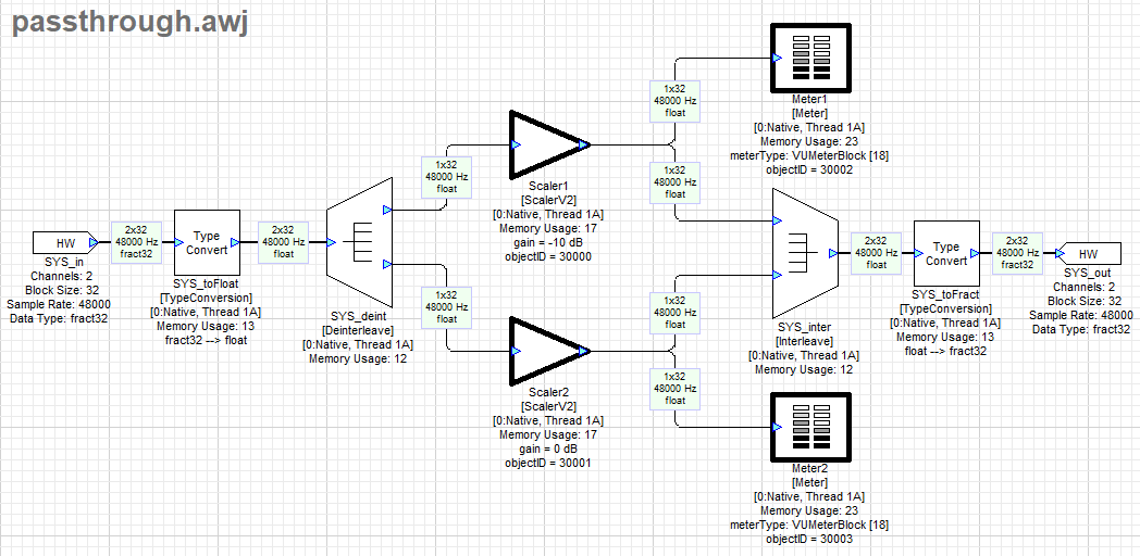

Passthrough with Attenuation
A sine stereo input signal is passed through the design pyawecore/Designs/passthrough.awj
, which attenuates the first channel by minus 10dB.
directory) use:
(aweenv) awecorelib-filepump ./Designs/passthrough.awb -w ./Audio/input_audio.wav -o my_passthrough_output.wav
This generates the file my_passthrough_output.wav
, which should have the same content as ./Audio/output_processed_audio.wav

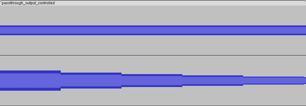

Passthrough and Controlling the Attenuation
The same passthrough design is used now, but programmatically the gain on the second channel is decreased during processing.
directory) use:
(aweenv) python ./Samples/attenuation_control.py
You should see a step-wise decrease of amplitude in the second channel in file passthrough_output_controlled.wav
, as in the following waveform plot.
