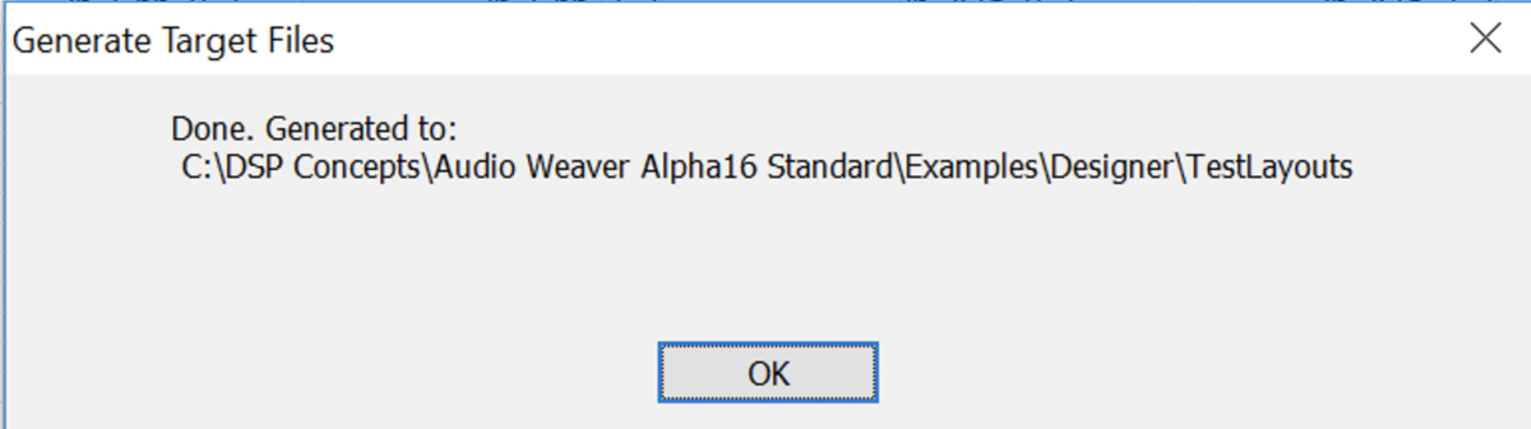

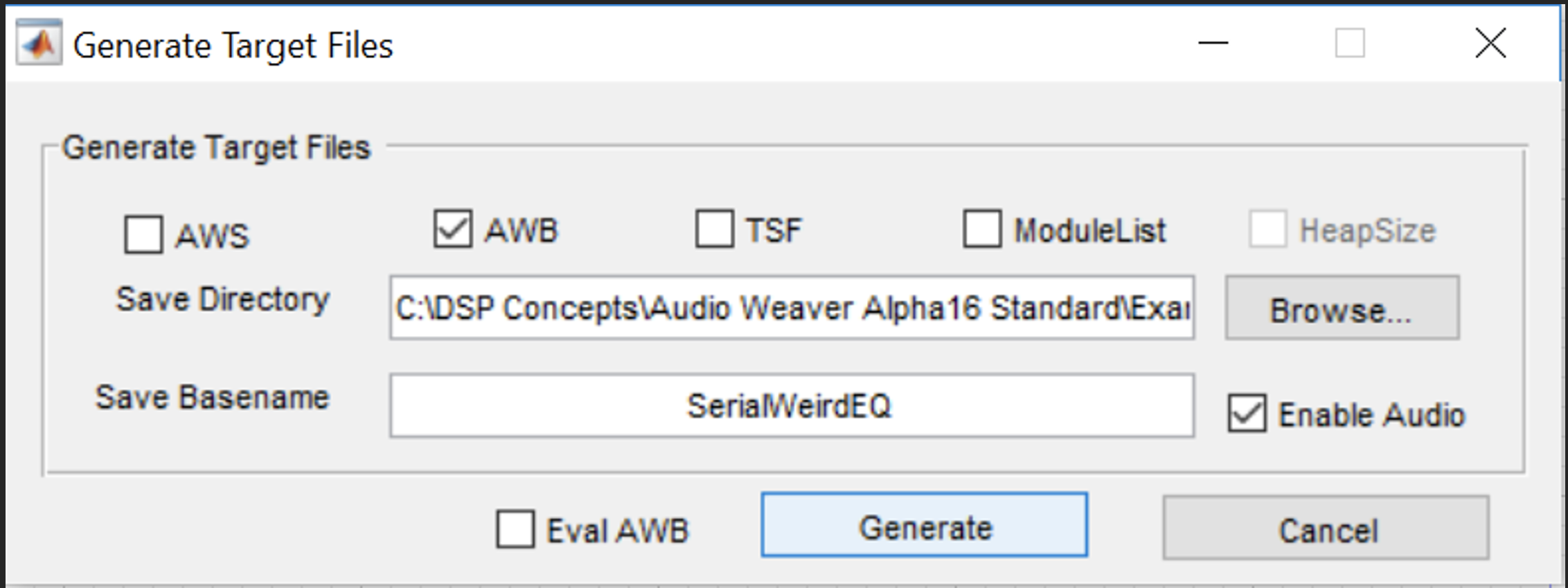

Audio Weaver can generate “Target Files” that can be used with an AWE Core integration. For example, you can compile your Audio Weaver layout to an AWS file which will be a list of all the Server commands that make up a design.

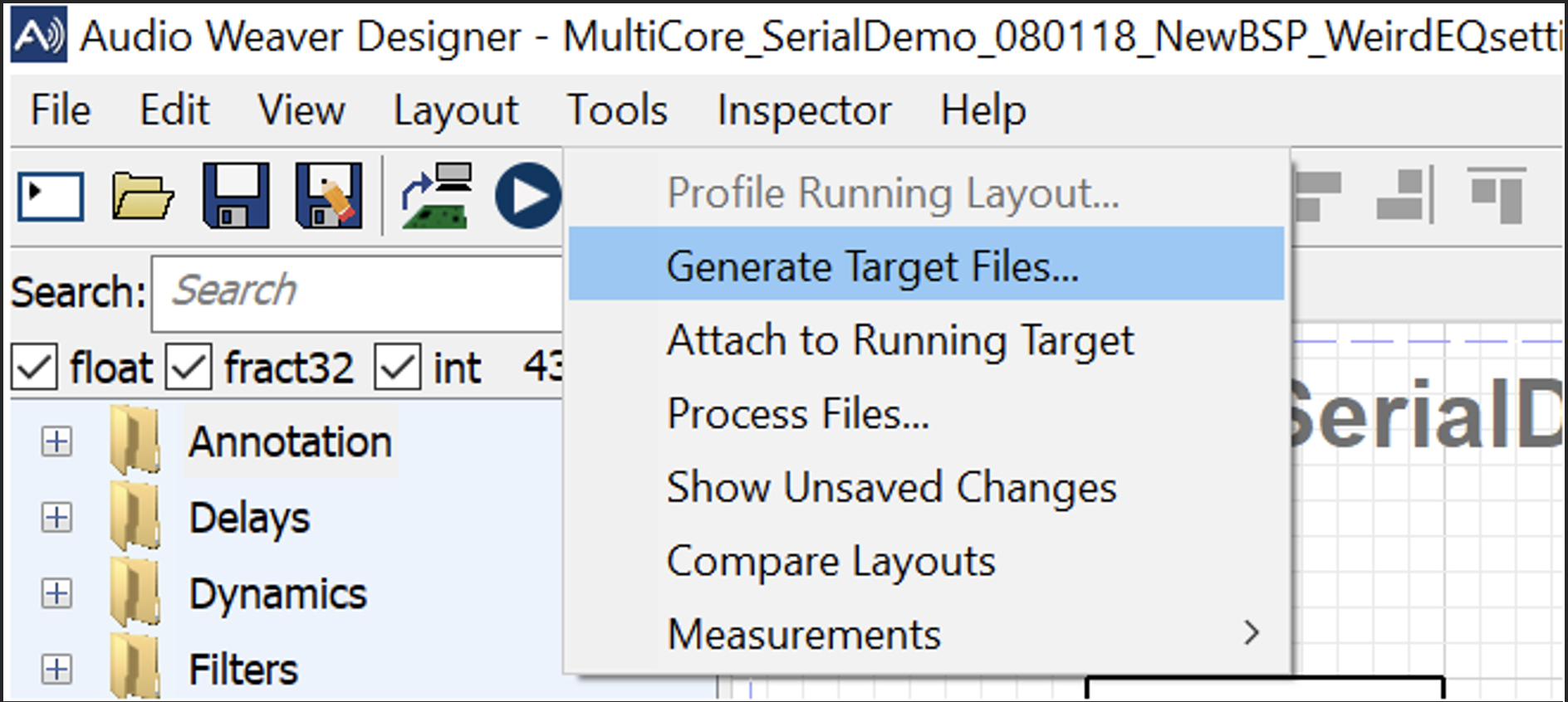

To generate target files, first create a valid design and then select the ‘Tools → Generate Target Files’ menu item. A dialog box will appear and prompt you to choose which files you would like to generate, and where you would like to put them. The “Enable Audio” checkbox will append an audio_pump command to your AWB and AWS in case you want to load the design but start the audio processing with a separate server command (for example, start the audio when a button is pressed).
Target File
Description

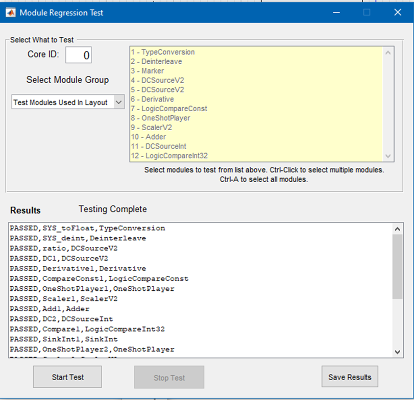

The Module Tests are used to verify that modules are properly implemented on a connected target. There are two types of tests that can be run from the Tools -> Module Tests menu: Regression Tests and System Tests.
Regression Tests are used to validate the implementation of each module on the target by processing generated input data and comparing it to a known output, usually generated by MATLAB. By selecting any of the “Module Pack” options, the regression tests can be run on the connected target for all the selected modules.
System Tests are used to validate that each module behaves as expected on the target, as configured in the layout. To run the system tests, select “Test Modules Used In Layout” from the menu.
The “Select Module Group” dropdown is used to choose the type of test or group of modules to run, and specific modules can be selected or de-selected using the generated table in the tool.
For multi-instance targets, the ‘Core ID’ (aka Instance ID) field can be used to select which AWE Core instance to run the tests on.
After selecting the “Start Test” button, the tests will be executed and the results will appear in the “Results” pane. The results can be saved to a CSV file using the ‘Save Results’ button.

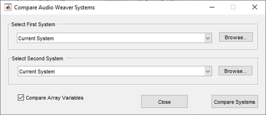

Compare Layouts
Two layouts can be compared by selecting the ‘Tools → Compare Layouts’ menu item and selecting the AWD files associated with the layouts.

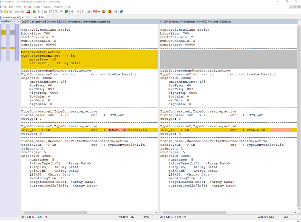

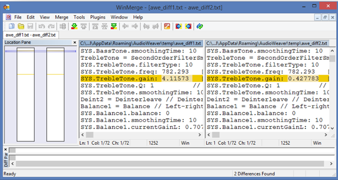

Diffing Systems
Audio Weaver layouts can also be compared using a ‘diffing’ capability. This can be useful for example to figure out changes between different versions of a layout during the design and tuning process. This functionality requires a Diff tool like WinMerge, to be installed. First specify your Diff tool under the ‘File → Global Preferences’ menu item, then use the menu item ‘File → Compare Systems’ to make the comparison between two different layouts.
Another way to diff systems is to save the layouts in AWJ format. Because AWJs are plaintext JSON representations of a layout, any diff tool or text editor can be used to spot the delta between systems.

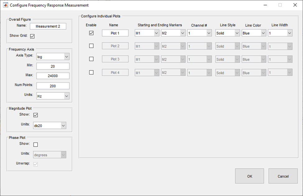

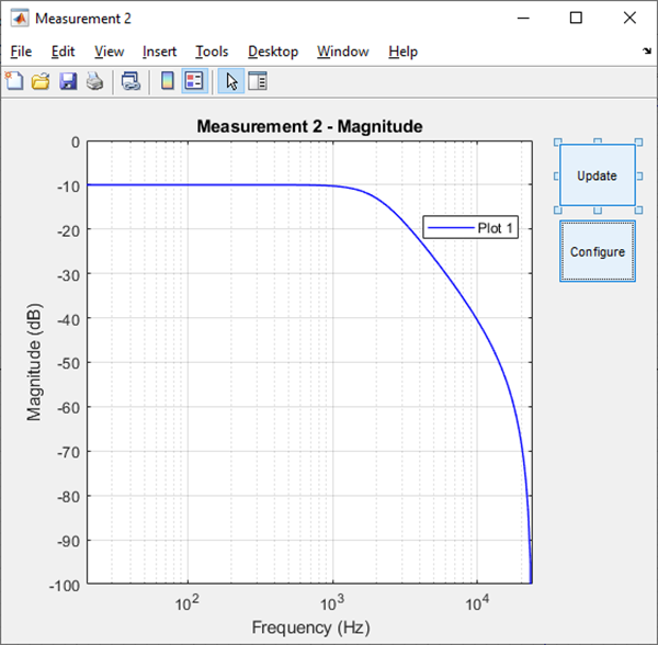

Many modules have associated frequency responses. The measurement dialog measures the composite frequency response between two points in your signal processing layout. To set up a measurement, first place marker modules at the beginning and end points of the desired measurement path in the layout.
Then select the ‘Tools Measurement New Measurement’ menu item to get to the measurement dialog.
Here you can select all the properties of the measurement display. When you push the OK button, an editable measurement graph will be displayed.

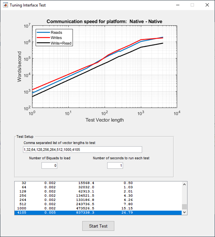

Tuning Interface Test
This function performs diagnostic measurements on a connected tuning interface, and is handy to have when developing an AWE Core BSP, or while troubleshooting a tuning interface implementation. The functionality can be accessed via the ‘Tools Tuning Interface Test’ menu item. Test results indicate the interface speed under various conditions, defined by the user in the Test window.
The test performs a series of Read, Write, and Read/Write commands over the tuning interface, with test configurations specified by the user. These configurations are modified in the Test Setup section, and are as follows;
  • Comma separated list of vector lengths to test
  • Number of Biquads to load
  • Number of seconds to run each test.

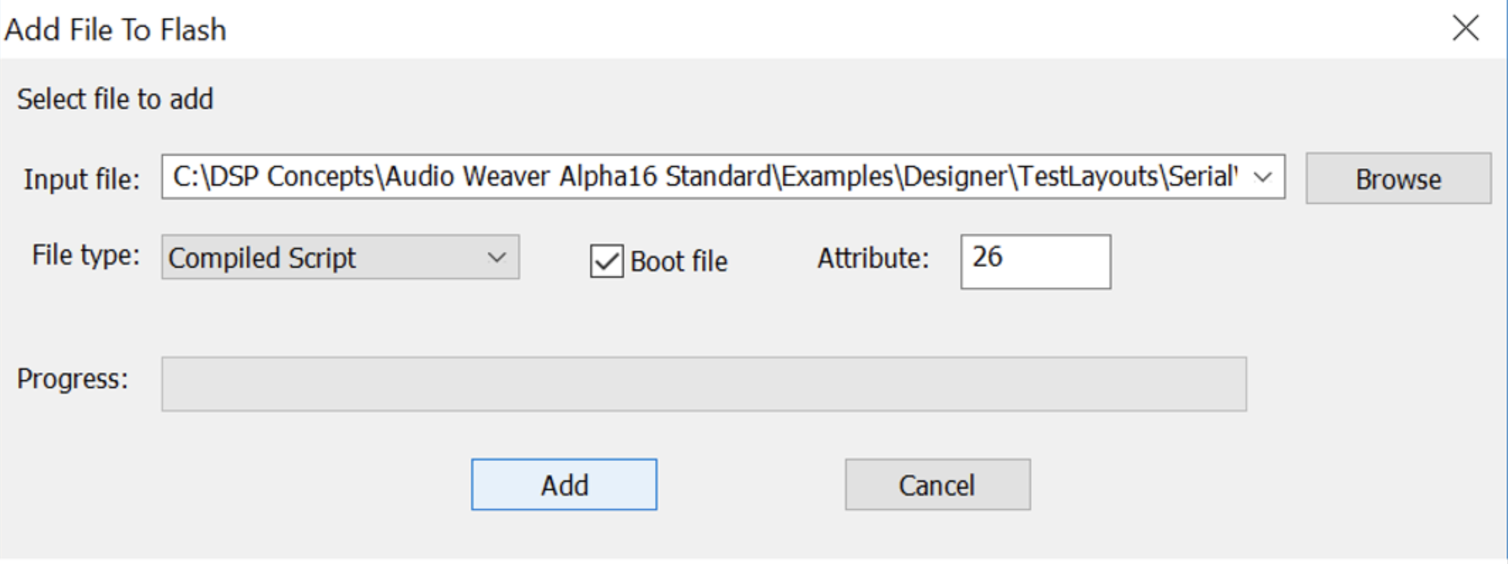

  1. Generate an AWB file for your desired Audio Weaver design (AWD ) in Designer by going to ‘Tools -> Generate Target Files’.
  2. Select ‘AWB’ target file type and choose the directory to which the AWB file will be saved.  Change the ‘Save Basename’ field to a name that is less the 16 characters, then hit the “Generate” button.  It will then start compiling the system for creation of the AWB file.
  3. Once the AWB file has been successfully generated, the following window will appear:
  4. In AWE Server, select ‘Target -> Change Connection’ and connect to your target with the appropriate option.

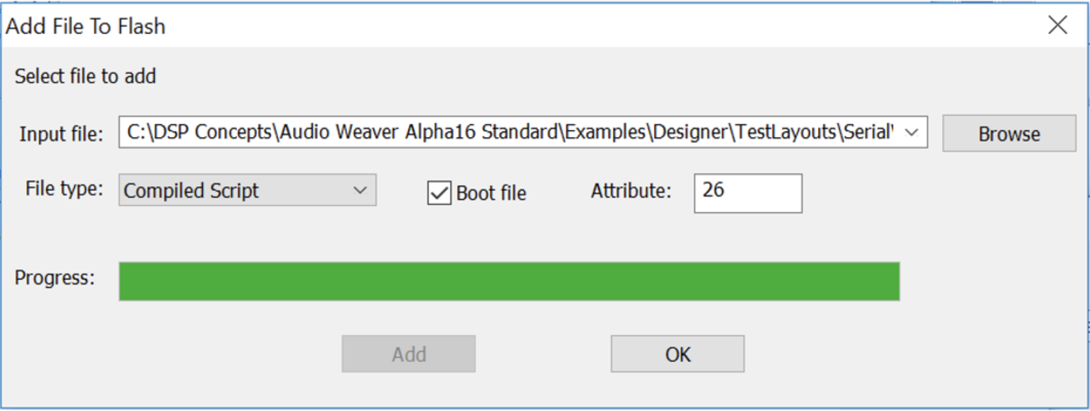

  5. In AWE Server, select ‘Flash -> Flash Manager’.  Then press “Add File” button.
  6. Browse to the previously-created AWB file and select it as the input file.  Ensure that the file type is “Compiled Script” and check the box next to “Boot file” to designate this file to be used at boot-up (attribute = 26). Click the “Add” button to load the file into memory.
  7. Once the progress completes, click “OK”.

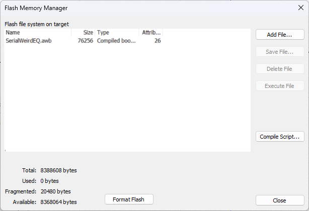

  8. After the file has been added, it will show up in the list “Flash file system on target” in the Flash Manager window. When you reset your target hardware and reconnect AWE Server to it, you should see a non-zero CPU % and heap allocated in the AWE Server, which indicates that the layout is indeed running.

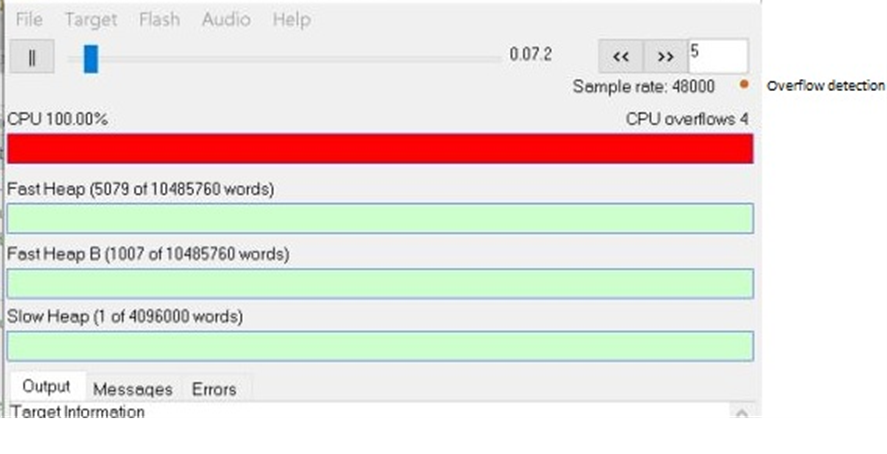

On certain targets, AWE Core will detect any overflow conditions while a layout is running and present this information in AWE Server. An “overflow” occurs when the previous pump is not completed before attempting to schedule the next pump. The overflow logic is capable of detecting overflows in any of the sublayouts in a multi-rate layout.
When an overflow is detected, the AWE server is notified through the tuning interface, and the following indicators are updated in AWE Server.
  • The CPU usage progress bar will turn Red, indicating that the CPU usage has exceeded 100 %. If the overflow condition is transient in nature, it is possible that the cpu bar may not show this condition.
  • The overflow detection LED (red dot) in the top right corner turns ON. The LED will stay ON until the Design is stopped, thus alerting the user of the overflow in the current run.
  • The CPU overflows counter on the top right corner counts the number of overflows detected across the layout (including clock divided sublayouts) until the Design is stopped. This count indicates that one or more overflows happened since the last time AWE Server queried the target for profiling values (by default this is done at 10 Hz). In theory the server could have missed some overflow events occurring at the target between the last query and the current query. As a result, this counter may not reflect the exact number of overflows occurring on the target.
Note: This feature is most accurate in embedded AWE Core targets, but CPU loading and actual number of overflows may not be correct in extreme circumstances; highly buffered applications with spiky CPU usage for example. CPU overflows on the Native target will be least accurate because of thread / CPU interaction outside of the control of AWE Server. Using CPU affinity to increase the accuracy of this feature for AWE Core OS targets is described in https://documentation.dspconcepts.com/awe-designer/latest-version/profiling-in-audio-weaver-tips-and-tricks.

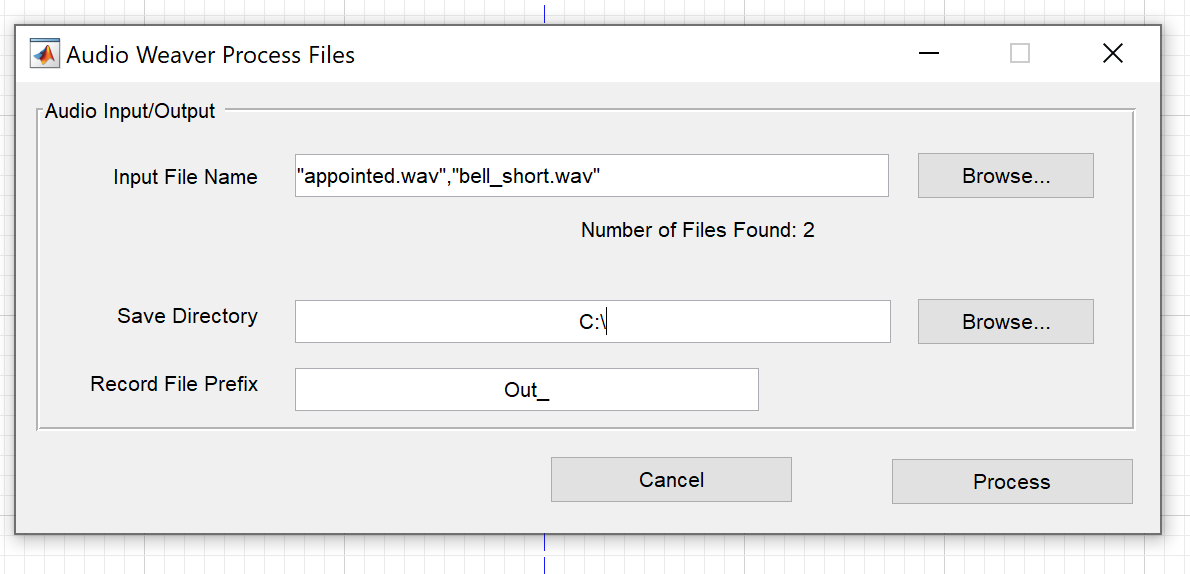

Process Files Tool
The Process Files tool can be used to process audio files through a layout and record the output as WAV files. The tool accepts MP3 and WAV files as input, but always generates a WAV file as output (even if an MP3 file is provided).
The tool is opened with the Audio Weaver Designer Tools->Process Files menu item.
Note: The Process Files tool cannot be used when connected to an external target, and is only supported in Native mode.
The tool accepts multiple audio files as input, and is thus useful for batch processing audio files. The tool is designed to process data faster than in real-time, making it convenient for verifying the output of larger layouts/many files.

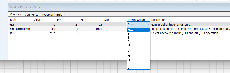

Preset groups are not presets! Adding a variable to a preset group simply marks it as something you want to include in one or more presets. You can change the preset group of a variable in 3 ways:

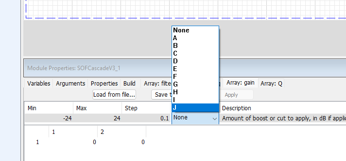

  1. In the variable property tab, there is a Preset Group column for parameter variables.
Setting The Preset Group from Variable Properties
  1. Array variables also can have preset groups:
    Array Variable Preset Group Selection
  2. You can set the preset group for all variables in a selected module, subsystem, or group of modules/subsystems via the designer canvas right click menu.

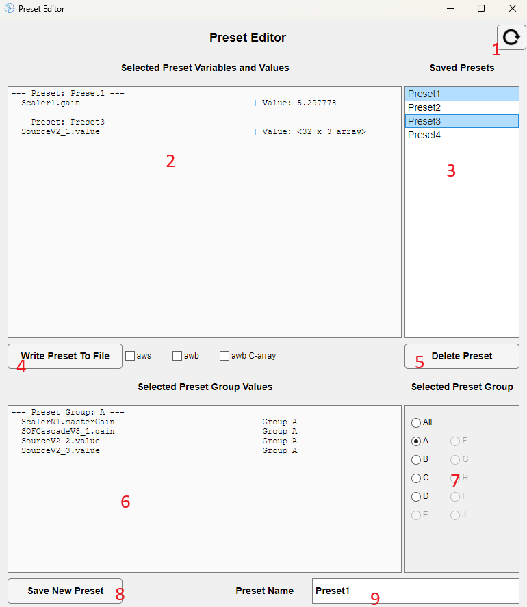

Creating Presets with Preset Editor
Once you have assigned the variables you want to use in presets to a group, you are ready to add presets. This dialog is not modal, and they user should take care to keep it in sync with the design if modifications are made on the MATLAB command line. This is done with the cache update button labeled (1) below. Modifications in the Designer window will automatically update the cache. Presets can be modified in Design or Tuning mode.
You can access the Preset Editor from the Tools Menu:
Each part of the window is described below:
  1. The refresh button is provided should the design change in any way outside of Designer - on the MATLAB command line for example.
  2. Information about the currently selected presets in the preset list (3). All preset information can be copied with ctrl-A and then ctrl-C to the clipboard.
  3. The preset list is used to select presets for various tasks. The selected presets can be deleted, made into files, and viewed in the preset information box (2). The user can select multiple presets with shift-click and ctrl-click. Double clicking a preset applies only that preset, and only that preset will be selected.
  4. Create aws,awb or c tuning files from the currently selected presets to be used on the target. Your design must be buildable because it will be setting these presets on the target (or Native) in order to record these commands for the presets.
  5. The “Delete Preset” button will delete all the presets selected in the preset list 3)
  6. This box is populated depending on the “Selected Preset Group” selection. It will show all the variables in a given group, or all the variables that can be added to presets in the system.
  7. Selector to view variables within a group. Any groups with no variables will not be selectable. Selecting “All” has the effect of showing every variable in the system and their group. A preset can be added using the “All” group.
  8. The “Save New Preset” button adds a preset and includes the variables from the selected group. In this example, all the variables are part of group “A”, so pressing this button will add only those variables. It is perfectly valid to make a preset with “All”, which includes all variables in the system. This button is also used to replace a preset. Presets can be replaced by making a preset with the same name.
  9. This input field will be the name of the added or replaced preset.
